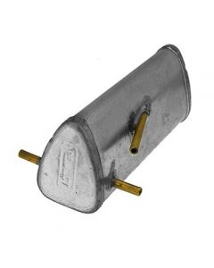

A 22cc tank is around 3/4 oz if my sketchy imperial understanding is correct.  Brodak wedge tank in 3/4oz looks very long for your plane.  Is this the one?
Brodak CL Basic Trainer 049 Bh-50310
I still think the tank is way too big for that plane and I can't help thinking that you're a little ambitious to plan to fly first up with 10cc.  If you do get it in the air, it'll stay there for a loooong time.  Are you experienced with control line flying?
If 10cc is your aim, I would have been finding a smaller tank that fitted more easily.  If the tank is mounted correctly there's no reason why the larger tank shouldn't still draw fuel ok.
