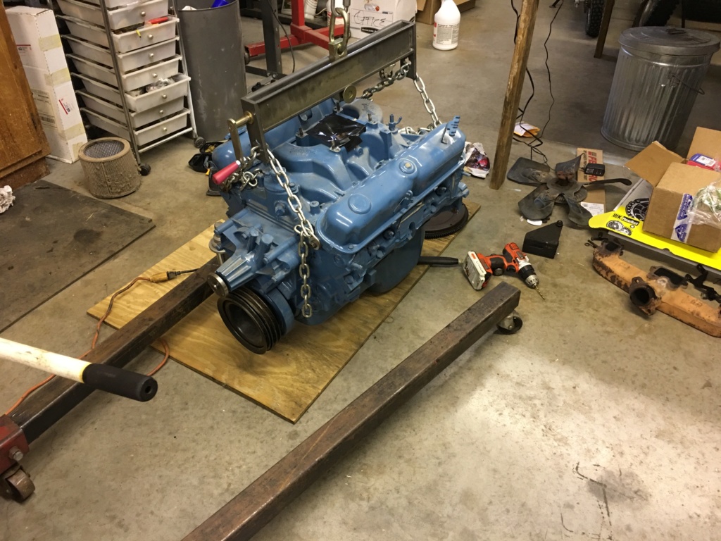

Post  Cribbs74 Mon Apr 13, 2020 9:34 pm
Progress for today...
Weather took a turn today, nice and cold this morning. My buddy showed up the engine hoist so out it came! What a mess underneath. Took some time to power wash and degrease. Shot a little paint on exposed steel. I’ll paint the front frame and suspension as I go along.
Had to mod the flywheel for the externally balanced 360. More to come!It’s happening... First haul! - Page 2 8d300710

Ron, looking at your steering shaft to the steering gear I see it's all stock. Years back I replaced my shaft with a Borgeson steering shaft. I know your model is older, but it was one heck of a improvement in terms of positive steering. The Borgeson joint uses a u-joint vs the rag joint. In addition, Mopar offered a bolster plate for the frame rail which keeps the rail from flexing.
Posts : 4837
It’s happening... First haul! - Page 2 Empty Re: It’s happening... First haul!
Post  Cribbs74 Mon Apr 13, 2020 9:53 pm
Hey Ken,
I definitely could use the bolster, I have already had to weld some cracks around the bolt holes. Yes it’s a stock setup, but it has a new steering gear and all the suspension and steering parts/joints have been replaced within the past 10yrs so the steering is superb. It’s a solid shaft right from the steering wheel down to the steering gear and it has zero flex to it. The rag joint is brand new. The downside is it’s a giant spear if I should ever have a significant front end collision.
I forgot to mention that the vacuum diaphragm was completely shot on my distributor. Who knows how long it’s been like that.  That explains why I would run out off steam at higher RPM.  Rolling Eyes
