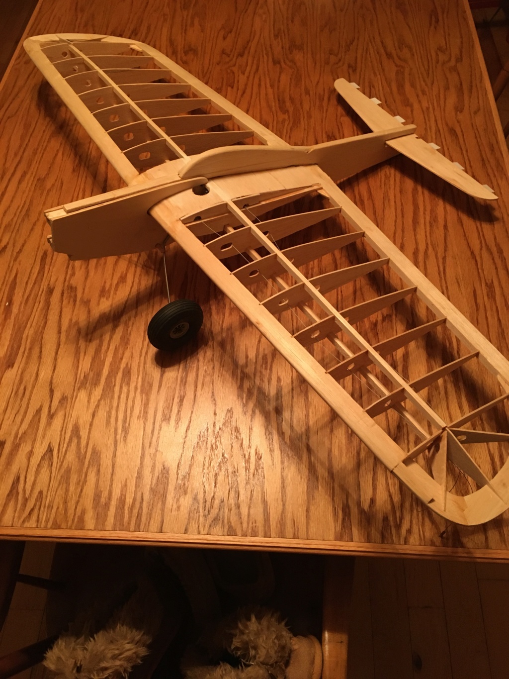

Tribute Shoestring build 00810             Started on the Shoestring in a tribute build to my Uncle who got me started in this great hobby. I got carried away and framed it up without taking any pictures of the build. I will use dope and silk span on this one. I'm trying to build it the same way I built the one he gave me back in the early seventies . I never did fly that one . This will actually be my first non 1/2a CL airplane flight.

Very cool!
One of my favorite Goldberg designs and the first plane I ever flew.
I have to ask about the wheels, they are huge! Alaskan bush version? Wink

Thanks Ron , Thats one thing I remember about the original was it had huge wheels, But Yeah, these look too Big.

Sorry Eric, I got carried away. I beefed up the bellcrank . I used one that was already made up . It was from a PT 19 arf that could be RC or CL. I made it RC so I had the bellcrank left over.

Based on my hobby shop experience, I would say that in the early seventies, of all the mass produced .35 class profile stunter kits in a short box (i.e. two piece leading edge, two piece spars) with a $6.00 MSRP, the CG Shoestring was the best engineered kit to build with the best wood and best flying hands down.

One missing item I am noting is the balsa cheek cowl assembly on l/h side of fuselage and wing root. You really should have that in place before attaching the silkspan to the wing as it adds a lot of anti-motor vibration strength to the front end of the plane and needs to be firmly bonded to leading edge. Ditto for the fabric tape reinforcement along entire lengths of all four wing root joints.

Also, you really need to get your engine mount set up with blind nuts in place before doing the other stuff I mentioned. If in doubt about balance, go a little nose heavy--much easier to add tail weight.
Did you apply the silkspan wet ? Minor wrinkles can be dealt with (usually self-correct) in later coats of clear dope.
