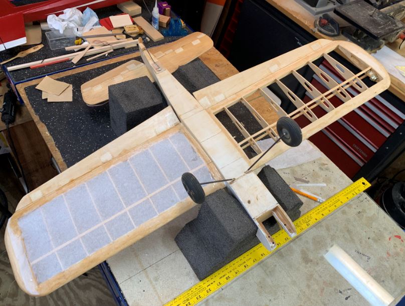

I'm getting ready to cover the Shoestring. I haven't done silk span and Dope in a lone time, Do I need to thin the Nitrate dope? Thanks for the help

When you use the nitrate to pre coat the perimeter of wing and other surfaces for the adhesion step, use full strength.

Sorry for being late to check in on this, and this is ONLY my way of doing it. I use Brodak buteryrate all the way through, but figure the rules are close to nitrate also.
Like Tico says, full strength clear around the perimeter of the frame on top and bottom. It's easier for me to do the wingtips first, and let them dry well before doing the main frame.
I have the silkspan pieces cut to size and ready to go for both sides of the wing. Then I lay the dampened sheet of silkspan onto the frame and go around it's edges with 50/50 clear to attach it, then flip it over for the same on the other side.

I then set it aside to fully dry, hopefully getting a smooth tightness across the span. Then I start clear coats with a day's wait and REALLY in between, 'till it gets a gloss.

Like Kim, I use butyrate only. My first coat on the perimeter is thinned ~ 65/35 i.e., 35% thinner. I do this to get good penetration into the open grain; following coats are full strength. BTW, when finishing stocks on muzzleloaders, I use linseed oil thinned with turpentine for the same reason - good initial penetration.
Following base coats are full strength non-tautening butyrate with light sanding in between to knock down any grain that rises. I continue with base coats until the grain appears filled and the finish is slightly glossy. Apply the silkspan damp, pulling out wrinkles as well as possible and keeping it taut. Stick it down with 50/50 - because the dope is cellulose based, the following coats will soften underlying coats and literally melt together. The thinner helps with adhesion (my opinion only) and the doped edges of silkspan sometimes needs a little finger rubbing to soak through.
Use tautening dope on open areas only.
I don't dope the ribs when initially sticking down the covering since it needs to be able to move as it drys. You can apply a sealer coat initially to ribs, but I don't over paint when applying either silk or silkspan until it has dried and tightened.
Lots of ways to do this stuff; this is just my approach.

Post  Kim Sat Apr 11, 2020 6:18 pm
OhBee wrote:When sticking down the covering ,do you dope the ribs also?
No, the silkspan needs to be able to slide across the ribs as it contracts.  This is another reason for fine-sanding everything to get the lumps out.
Once the covering is drawn tight, I dope everything with clear, and this sticks the silkspan down to the ribs.
