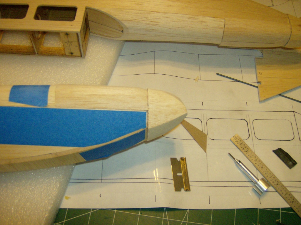

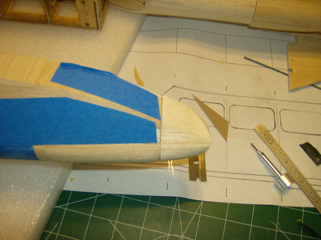

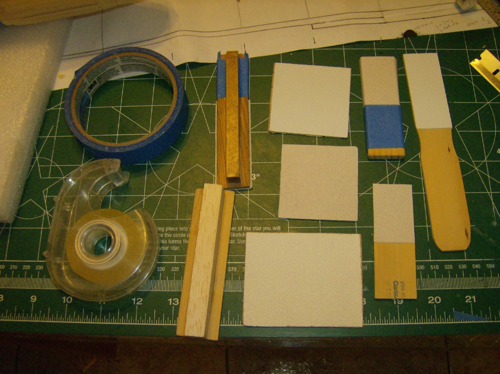

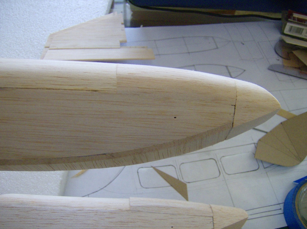

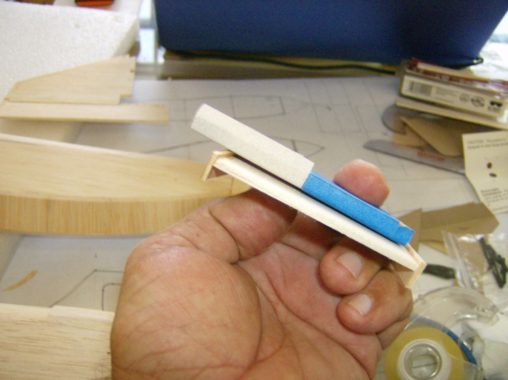

Well guys I`m doing a rhinoplasty on my cat front noses. I glued a few blocks of balsa and started sanding with a sanding disc to get the shape close to what it should be. I`m using 3m double sided tape to stick my Indasa Rhinodry 180 and 100 grit to the shermin williams paint stirring sticks that I`m using to sand because I can peel the sand paper and stick a new piece of sandpaper easier than if I used glue. I also use a piece of 1/64 ply with two pieces of sand paper attached for round areas because it flexes and takes the shape I want. I use blue making tape to protect the areas that I don`t want to hit by the sandpaper. The sticks with sand paper and masking tape attached I use to sand some areas sliding the masking tape over the balsa I don`t want touch and the sandpaper over the high spots. I glue small pieces of wood to form a handle and make them easier to use. here are some pics.

Looking Good Juan , you have quite a array of sanding equipment , i purchased some 3m tack spray glue for the purpose of the 2 sided tape ur using But haven't tried it yet
What are you using to hold the nose on or is it fitted already ?

I used a few drops of Titebond original wood glue to hold the top block and nose in place. I removed the top block to hollow it a little before finish my sanding to avoid a misaligment when gluing it back in place. I spot glued the nose that way if I make a mistake I can remove it and place and other block of wood and start shaping again.
On the sanding stick I forgot to mention that once you have the sandpaper glued to the stick you have to ad layers of masking tape until the sandpaper and the masking tape are at the same level,sometimes it would be 4 or 5 layers all depends on the thickness of the sand paper. If you drag your finger from the masking tape to the sand paper and feel a step add masking tape . If you only apply one layer you will sand too far and create a step. The sanding stick will slide on the masking tape over the wood without damaging it and will sand to that level. In the last two photos you can see that I sanded the wood level with the bigger piece. I do that way when sanding the top and bottom planking of the fuselage on a small model.
