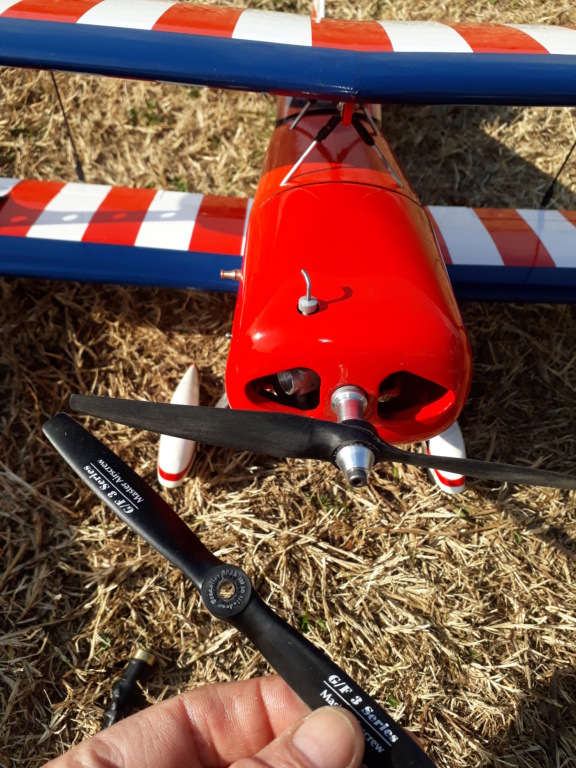

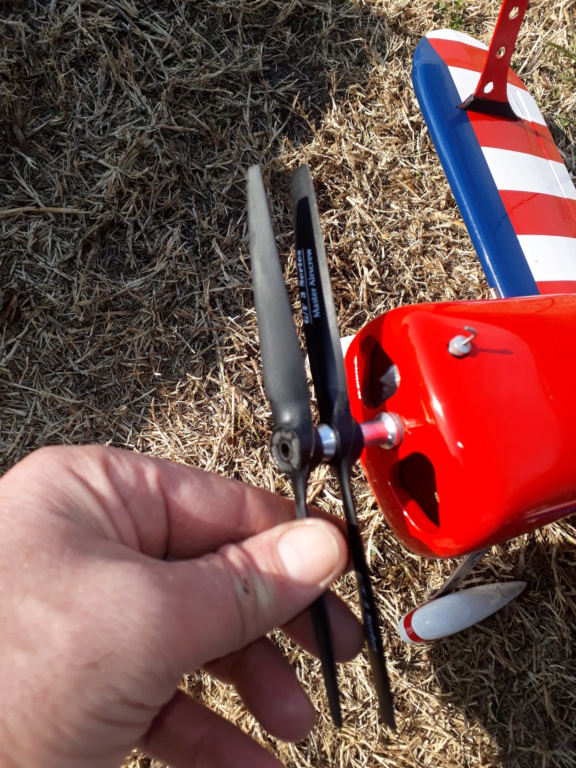

Dear friend, this morning I went to test propellers, so first I flew with the original 7 x 3 MAGF3 and then with the 6.75x4N (modified MA).
There is no video because my time was limited, but I tell you that it DOES NOT RESULT, because the model begins to taxi almost asking for help, it does not pull it, it does not pull it properly, so abort the two takeoff attempts, because if it took off, it would make the flight critical, especially in turns.
This is an aerodynamically model with a lot of crash surface, perhaps the 6.75x4N propeller, it goes in a much more aerodynamic model, but it is not the case of the PITTS.
Definitely, I go back to the original MAGF3 7x3 and I stay comfortably there, the model takes off in 25/30 meters and in all turns it comes firm, well sustained. Even when decelerating, upon landing, the propeller continues to pull the model smoothly. It's all friend what I could say from my experience here.
Definitely the MAGF3 7x3, it is the best configuration for my PITTS.

Thank you for sharing Mauricio,
Looks like every bit of thrust is very critical to take off from the grass with the small wheels.
Lucky the 7x3 works, you have found the best prop to get it up in the air safe with the .061 engine.
The modified prop looks good.
6.75x4N may find a good home for another project one day such as with a Norvel .074.
I am happy you are able to fly the Pitts with your .061 now you can rest and enjoy it

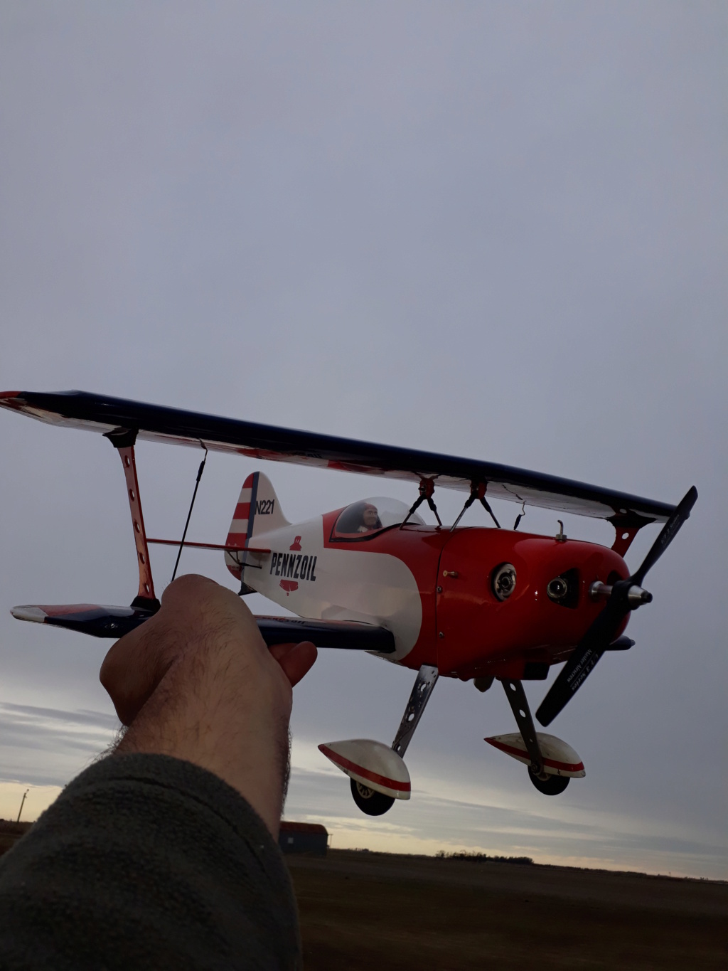

After a year and a few days, I decided to take my PITTS back onto the track, honestly it is a wonderful model and every time I fly it, the more I like to do it.
I take this month of July to fly the model, since we are here in the middle of winter and the runway and its grass are kept under control thanks to the frosts (cold), the grass does not grow and allows the model to taxi perfectly for takeoffs and landings .
I made several flights today, here is a video to share with you, my friends!

Amazing flight and engine response, congratulations Mauricio. I really like this little bi-plane..are you not thinking of swapping the Norvel with a TeeDee 049 with exhaust throttle control, just to see the difference between the 2 power plants? I think they have the same mounting screw pattern.

Thank you very much András and Eric for your words.
The Pitts initially generated doubts, but already last year, after adjusting the propeller, it became one of my favorite models, its flight line, also how small it is and the ability to fly and do stunts it has, With a fair engine, without exaggeration, it is really beautiful to enjoy.
András, I have worked fine taking the measurements to manufacture this fairing adjusted to the Norvel engine, it has a very delicate job in terms of the carburetion needle exit position, throttle control and exhaust gas outlet, so after all that work , I prefer not to touch anything else there, since with the incorporation of the adjustment of the propeller through that false shaft, I think that everything is very well there, perfectly balanced. Removing the engine and replacing it will generate a job that I really can't do, well, just looking at this Pitts, I find it wonderful how everything is there.
In my projects, there is the idea of building another similar one (another Pitts), but the idea is to make it just bigger and maybe put a .09 from Cox ... but for that, there is no time since there are other projects in the running. ...
