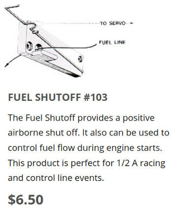

Roddie, that is so cool! What amazes me too, is they still sell the fuel cutoffs. I still have one I bought in the late 1970's from the Ace R/C catalog, great for a 2 channel plane without throttle control. A blip of full down elevator with a section of thread connected to elevator servo arm pulls the spring clamp pinching fuel line, killing the engine, in case one needs to terminate flight early.
