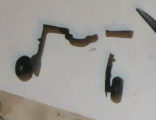

I’ve received my Wings Corsair. New in box as advertised. I’m currently collecting the necessary electronics for the R/C build.
While on EBay I picked up an old ElectroCharger Spitfire from my youth. Restoring it should be no trouble, there are threads here on the Cox Engine Forum detailing how to do it.
One problem is the landing carriage is broken in three pieces. All the pieces are there and can be glued back together but it wouldn’t have the necessary strength.
Luckily for me, my nephew competed AND WON a Disney Competition where the prize was an expensive 3D printer, scanner and computer. If anyone is interested the show was called “Shop Class” and can be found on Disney Plus.
Once the Spitfire arrives I’ll have my nephew scan and try to reproduce the original style landing gear. Probably have more fun reproducing the landing gear than actually flying the plane. Smile

Post  RNajarian Thu Jul 23, 2020 2:35 pm
Got the ElectroCharger Spitfire today. The fuselage separated without issue revealing pretty what would be expected after 40 years.
The motor disassembled easily and ran Ok with a load of 4 volts. The airflow was pretty anemic. I may upgrade the motor. Cox planes on Ebay - Page 3 013ebf10
