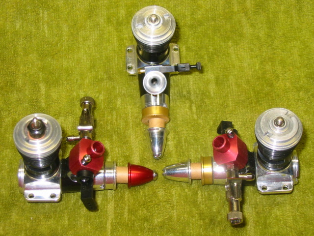

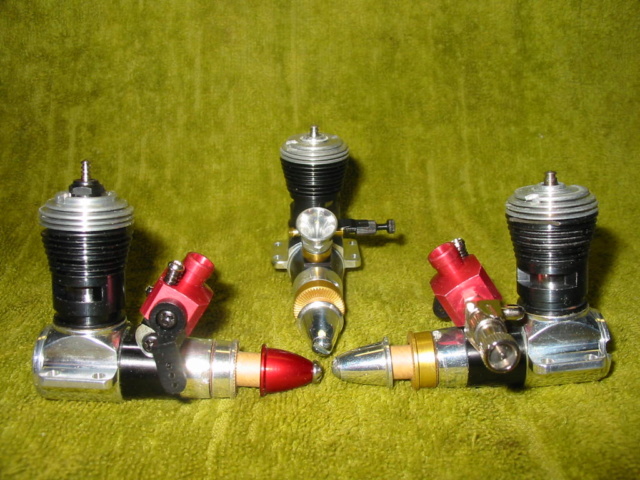

I have installed a Enya .09 Quicky throttle onto a Cox Tee Dee .09.
Idles down to about 3100 and tops out at about 17,000.
If you want to have a Enya throttle thread into the Tee Dee .09 you can get the Enya long neck (venturi -- part #19440) carb from MECOA and use a 5/16x32 die to cut the threads.
Thing is, that carb is a little bigger ( for Enya 19 engine) so, venturi size is larger.
I sized up a Enya .09 carb to the Cox Tee Dee .09 engine.
The Quicky 09 I milled and drilled a small hole into the aluminum (body) venturi to accept the Enya Quicky 09 carb.

Looks great well done!
Have you checked the carb with a TD .15?
Cox Tee Dee Special with Norvel .15 RC carb
Threads are 3/8 -32
I have used a:
ENYA Part Number: 09430
ENYA 09TV CARBURETOR COMPLETE E1038
For a Norvel .074 Heli engine.
Modified Norvel V7 / MA 5.5x4.5
Testing with Enya TV .09 RC carb
Peak Static: 19,622 / 16oz thrust / .224hp / 167w / 84 mph
Modified heli muffler with pressure tap
Threads are 3/8 -32
I have used a:

No I have not tried the Enya .15 carb on a Cox Tee Dee .15 engine.
The 3/8-32 die will not thread the Enya 15 carb. It is not big enough to thread but the 5/16-32 die will thread the carburetor.
I have a Cox .15 engine but no piston for it. I broke the con rod. No I did not use a starter on it (never!)
The Enya carburetor will slip into the threaded venturi part, just like the Enya Quicky .09 carburetor did on the Cox Tee Dee .09 engine.
It should work out just as well as the Tee Dee .09 setup?

You are always one step further! ... good to see your work!

Excellent...!!! do you have running videos Thank you!!

Sorry I do not.
I am not tech savvy enough on a compute to get that done.
Here is some more info as to what I used:
I used Sig's Champion 10% glow fuel
Prop was a 8x4 Taipan prop ( purchased it years ago from Hobby Club)
The engine I ran was the one with the red spinner. I have not yet run the other Tee Dee .09 (silver spinner)
