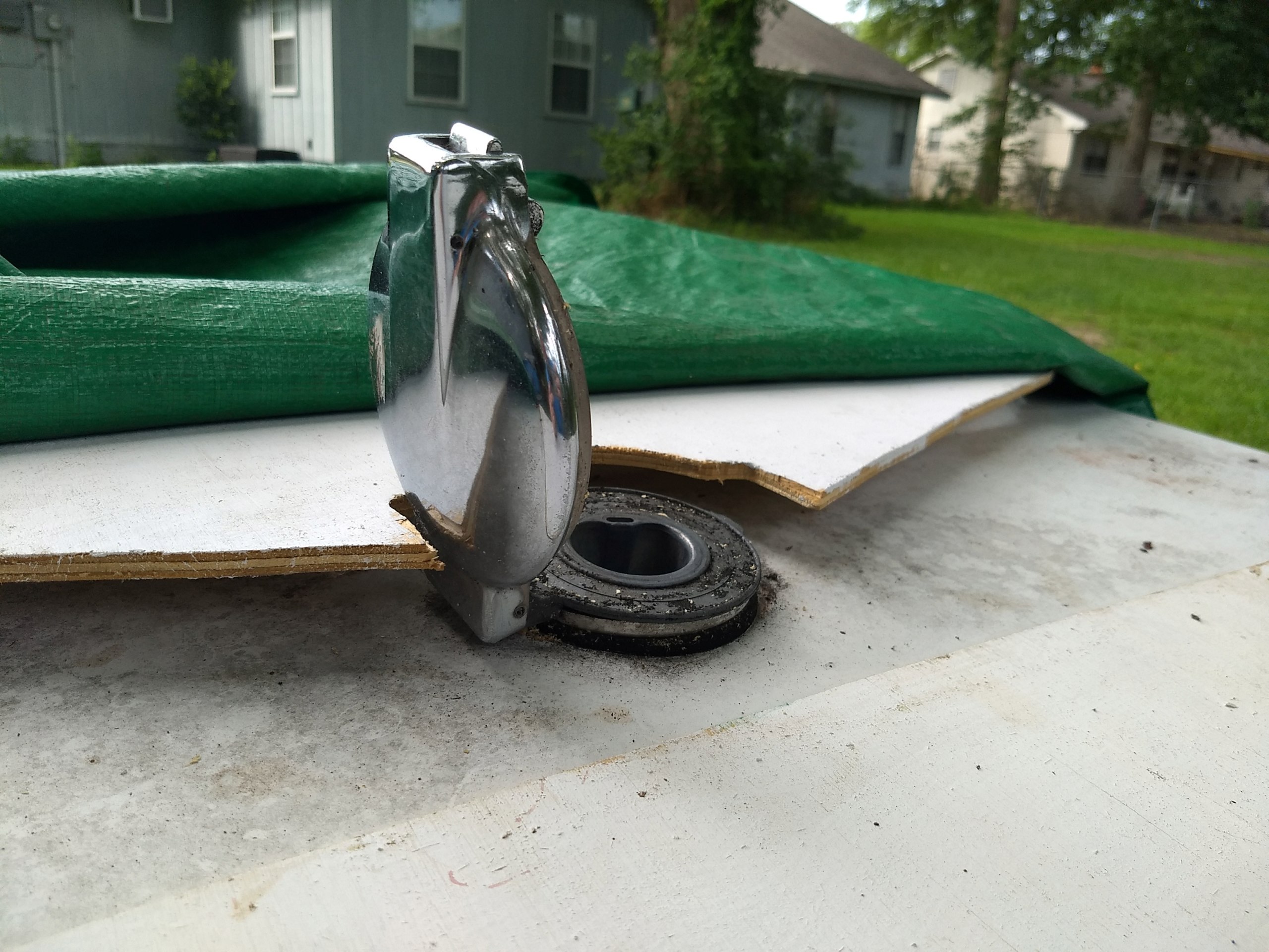

Very Nice !! I see you made it for CC flight, i been going to build one i have plans for one of these days .... But the time just keeps on going and its gets farther down the list ! Wish you could have done a build log but that's ok . Hope to see a flight report ? I am sure she will schoot !! Hey Jim is that ur clean out ?
Posts : 9432
Re: Baby Barnstormer, after many years
Eric,
It is the one piece on my TR6 my boy did NOT damage.
