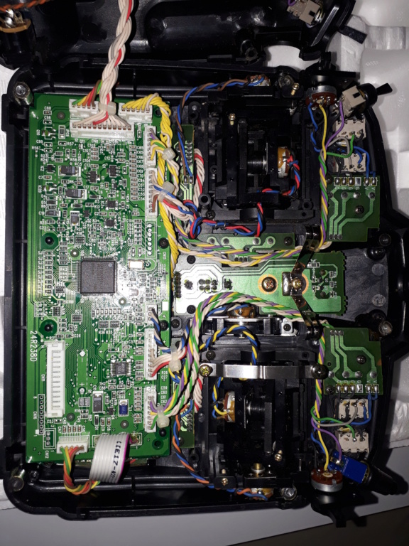

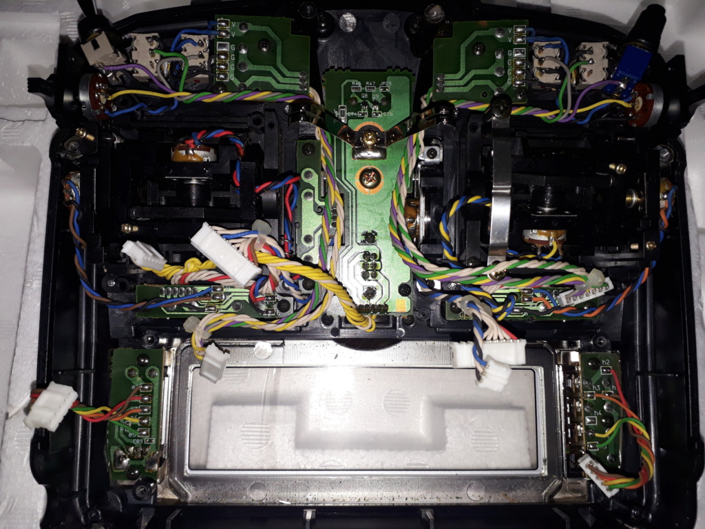

Hi guys, I want to ask some questions to evaluate making a decision.
I will tell you about this, this is one of my JR radios, it is a 9303, which I used for years, about 6 years ago it was maintained, since the radio was bought around the year 2007/8, I stopped using it Because I started using a JR 9503, (the one I currently use now), a while ago I wanted to use my old JR 9303 radio again and completely lost its program, that is, I was left without a single data on the screen; Change batteries, but everything remains the same, without showing a single data, directly does not turn on.
I made some inquiries and the same thing happened to a friend with a JR9303, so he had to send the USA to the technical service and there they did general maintenance, reloading the program of functions, they even placed a battery with higher amps than the original.
So, I have a couple of questions:
JR seems to be no more, but is there a JR service currently in the USA ?.
If there is a technical service, could you give me the data, please, where should I contact me?
I would explain the problem to them and then maybe I can send it to do the necessary maintenance.
From already thank you very much!

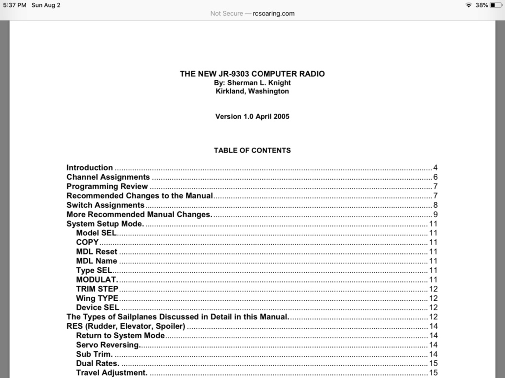

I did a google search for JR 9303, this thread from RC soaring showed up.
http://www.rcsoaring.com/docs/9303knight.pdf
I am not sure if the XP9303 is the same as the JR9303?  The last page he gives his name and contact information.  Might be worth a e-mail to find out:

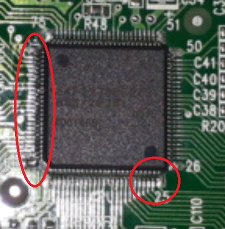

MauricioB: are you sure the battery is Lithium? In the past they used tiny NiCd’s. Sometimes 4 in series. I used to repair Dell computers and the clock battery, similar, was under the keyboard. Do you know where the battery is? If you do and have an EXACT replacement, voltage wise. ALWAYS unsolder the ground side first. Most soldering irons are grounded and you don”t want to ground the “+” side of a Lithium battery. Have you checked the voltage on the battery? Minimum 3.7volts per cell, most likely 2 cells. Make sure you read the manual over and over, before starting.

No back up battery needed any for JR 9303 flash memory like as USB flash disks, so it must be another electronical issue.

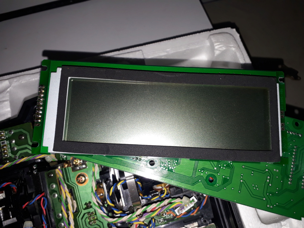

Mauricio, no lights turn on any? Charge the battery and check it?

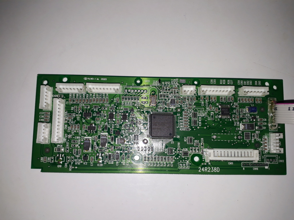

First thing to do is replace the battery that's on the board.
If your luck enough, the radio's programming might be burned into the memory chip inside.
My dad's Airtronics Visions radio went dead like. that as well.
New Tx batteries (8 cell pack of nicads) but the screen was dark (blank)
Replaced the battery that was on the board and the radio program came back on the led screen.
Give that a try first and I hope that works out first.

I replaced a 3V battery in my old 783 quite a few years ago. I did check to see if 9303 had one, but as others say, it does not.

Post  MauricioB Sun Aug 02, 2020 10:38 pm
Thanks to all for the help.
So let's do this together! ... Don't worry, I'm very careful about handling this.
First step; There is no lithium battery ??, so why do some say that it exists and the manual says that there is no battery.
Tell me friend, here I leave some photos, could you tell me where you got your lithium battery ?, because I still can't find anything ...

Post  MauricioB Sun Aug 02, 2020 11:53 pm
It seems to show signs of life, but it is all it does. Huh... Huh... Huh...

Post  getback Mon Aug 03, 2020 6:43 am
Here is a read on a JR9303 that was sent off for the same problem >> https://www.rccanada.ca/rccforum/showthread.php?t=430417&page=2 How much voltage does the TX battery have ?

Post  MauricioB Mon Aug 03, 2020 9:20 am
getback wrote:Here is a read on a JR9303 that was sent off for the same problem >>  https://www.rccanada.ca/rccforum/showthread.php?t=430417&page=2  How much voltage does the TX battery have ?
Thanks Eric for your collaboration, because the pack is 9.6 volts, but when loading it reaches 11.6 volts, at this moment it is acting 11.6 volts.

Post  Jason_WI Mon Aug 03, 2020 2:53 pm
I looks like its trying to boot up but data to the LCD or the LCD itself is bad.
Check the main IC quad flat pack (QFP) in the center of the main PCB for proper solder connections. The areas circled in red look to have questionable solder connections.
JR radios technical service. Qfp11
For proper solder connections on gull wing leads look at Figure 4 in the link.

the other possible issue is the LCD itself is bad. I have seen where oxidation on the elastomeric conductive rubber strip needs to be cleaned as well as the glass LCD and PCB with 97% or greater isopropyl alcohol. The metal tabs around the black frame of the LCD need to be turned straight and then remove the frame from the PCB to expose the glass LCD and elastomeric strips. This would be a last ditch repair attempt.
https://en.wikipedia.org/wiki/Elastomeric_connector
https://www.youtube.com/watch?v=-QZk9WCz-D8
