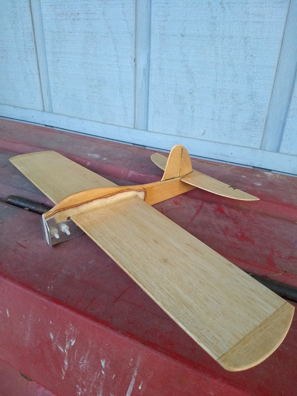

WC, as you wish. I don't mind the color change...others here likes the wood showing.
New...that is plywood. Carefully feathered in because, well, I wanted to see the feathering along the individual plies.

I can do a product engine. It’s difficult to do an external tank properly on a BRM though.

What plane is that btw

That looks like a ringmaster

Today has been a doozy for me. I'm sorry for the back and forth. The solid/reliable fuel feed of the Babe Bee tank outweighs my original intent (over a year ago) of the airframe to carry more fuel.
I will backpedal and concede you are correct. It will be easier to make new mounts for the Babe Bee than to make tank straps, etc for the product engine. I have enough time and a new anvil for shaping the angles. I also have a Babe Bee template for ensuring trouble free alignment of the mounting pattern. This really is a better.solution...I just got tunnel vision on "my build." Now this one is WC's build and really should be de-tuned for the young man.
WC,
This model is known as the Baby RingMaster.
Once a year there is a worldwide call to control line fliers to fly RingMasters. Some places even have contests to see who can make the most flights with their RingMaster on that one day!
There is also a website and forum known as "The Brotherhood of the Ring" where this particular plane is cherished and honored. There are several different versions. The one you are getting is the basic stepping stone to other versions. The larger, more intricate versions sport full fuselages and built-up wings.
When you crash this plane, it can be superglued back together in a blink. Once this airframe is too badly damaged, you can strip off all that is good and use the parts/engine on your own build.
Good night all...and thanks Ron!

No worries. Not a big deal. You might could just drill some more holes on the existing mount to accept either configuration. Are those nylon bolts holding the mount to the fuselage? If so they won’t last long. Not only are they really susceptible to UV damage the threads will wear off quickly due to vibration. I would consider steels bolts. Just a thought.
P.S. I like how you did the doublers.
