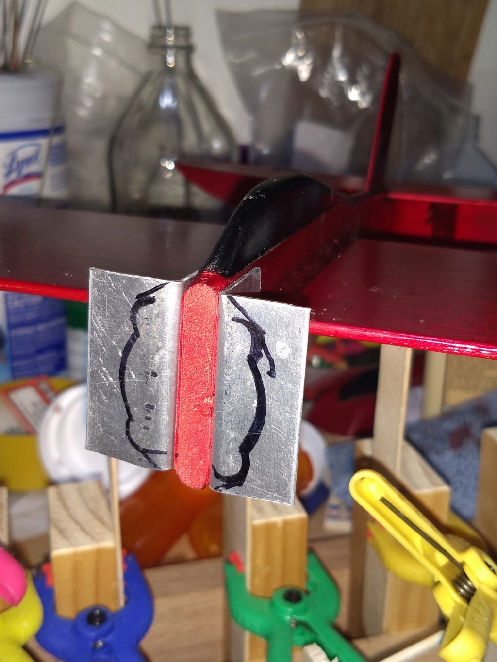

Ok...new engine mount is rough-shaped. I may cut off some of the material under the wing.
The firewall shape is close. I still need to drill the engine mounting holes.
Landing gear still to be completed.
I don't want you to think I'm not sending the plane, but I may miss tomorrow's mail run. Keep an eye here for updates.
