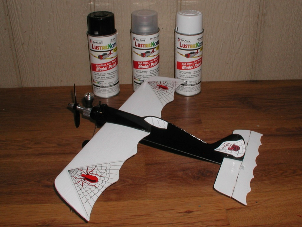

Well almost, still have to put on the decals, steady hands required, might need some help there.

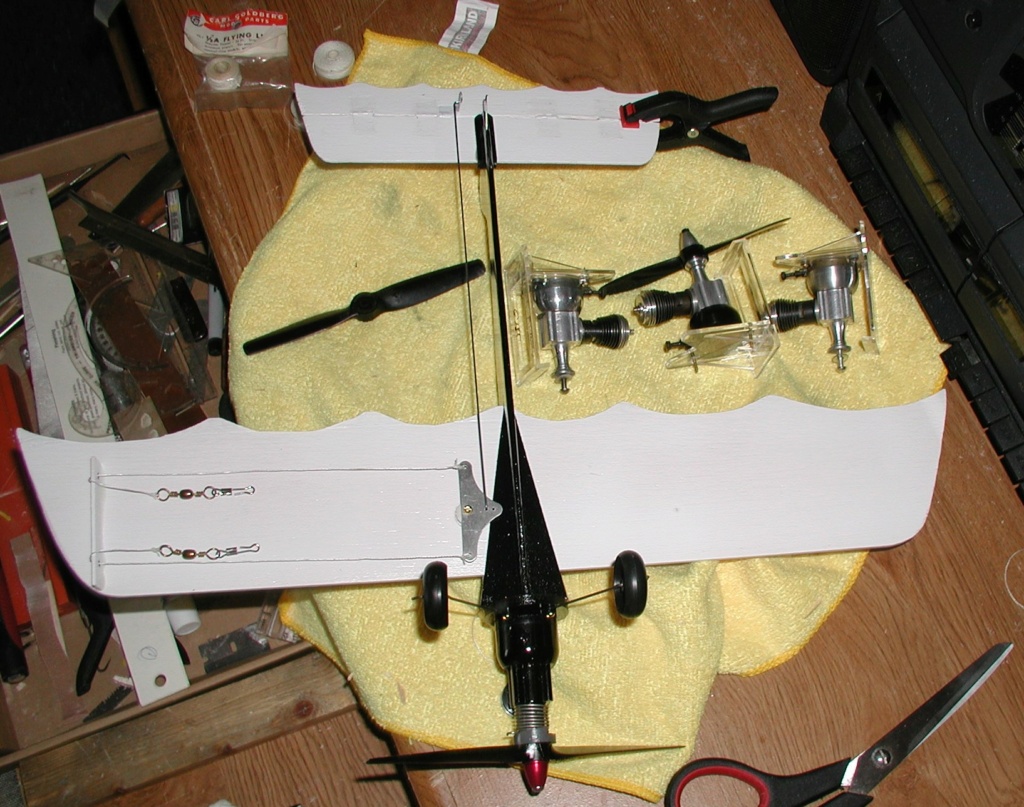

Confession time. I just slapped this thing together. Tried new things, experimented. Pin hinges inlayed on 1/16" balsa, different incidence angles, very little rudder deflection, dacron lead-outs, SIG airfoil wing. Probably going to cut the dacron to 25/30' and install on a Cox handle.
As mentioned the BW engine is a no go, too nose heavy with it. Got to select one of three Babe Bees, probably the middle one made up from mostly new parts. Did a tail skid vice wheel, easier.

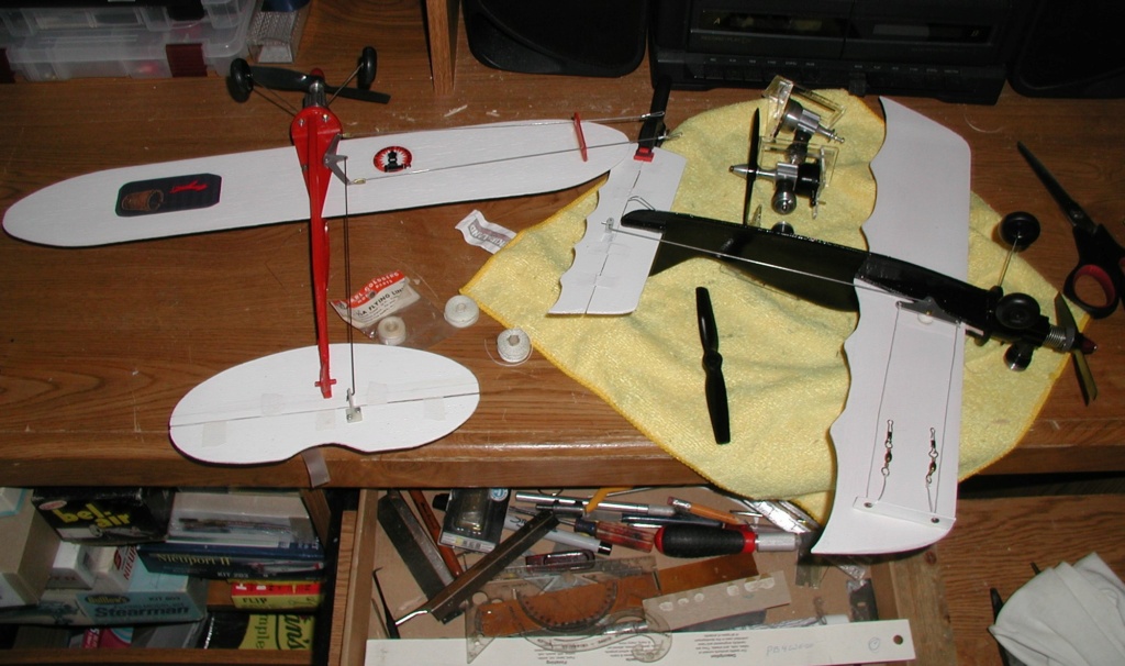

Going to do another. Fuselage is a clone of the Jim Walker Firebaby that does not balance like the original. Have to move the wing closer to the engine mount among other things. Note to self: correct all the mistakes you made with this one.
Edit add: Got on the net trying to reeducate myself about how to string a Cox handle..........it's been 50+ years...

I replaced the Black Widow with the built Babe Bee, and whew......it balances perfectly. With the BW, fingers at the leading edge it would do a nose dive to vertical.
Sit's lower than the original too, I cut the reliefs higher in the mount for the landing gear. Decals next.

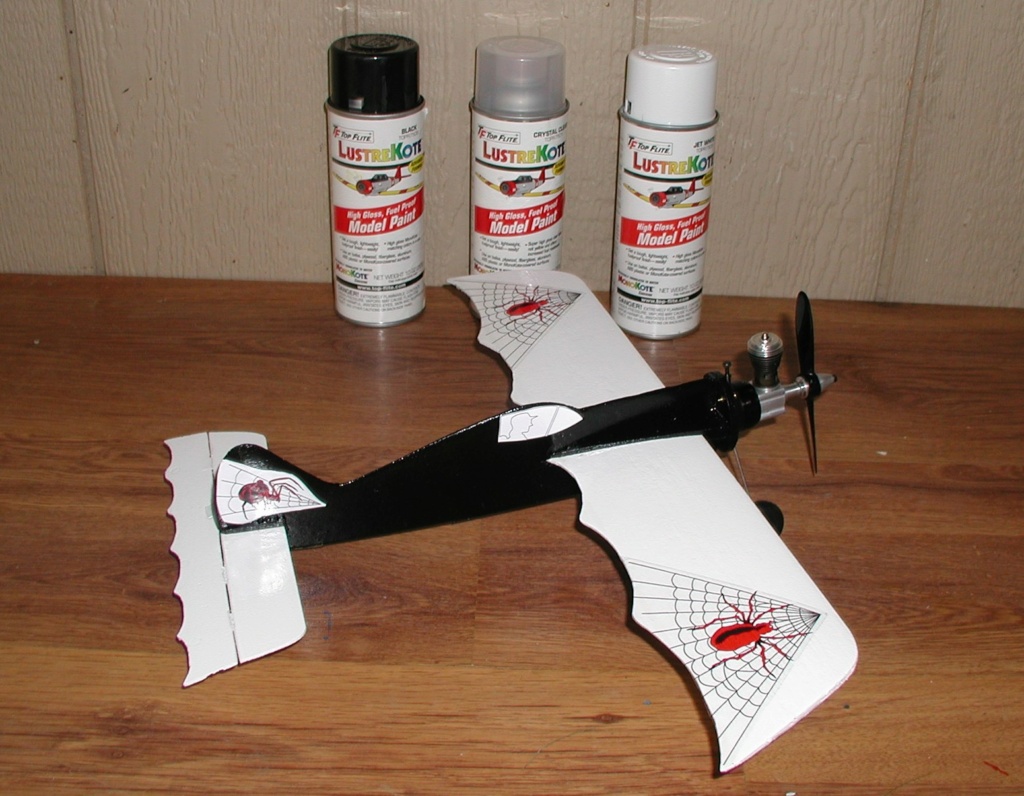

Rather than wait for Mark I just went ahead and added the decals with apologies to Levent as they are not put on perfectly.
Close match to the original.
I did not scallop the leading edge of the horizontal stab because I did not think that it matched the wing so I left it, but it's growing on me. If I do another to scale (accurate clone) I will include it. I have always been curious about the cloth hinges. The original Firebaby featured a single hinge located under the tail assembly.
I do see that the reproduction used the same crimp style control horn that I used on mine. It would be a simple matter to wet some 1/16" balsa and form it over a like structure and apply it just ahead of the cockpit. Might do that on a later version too.
