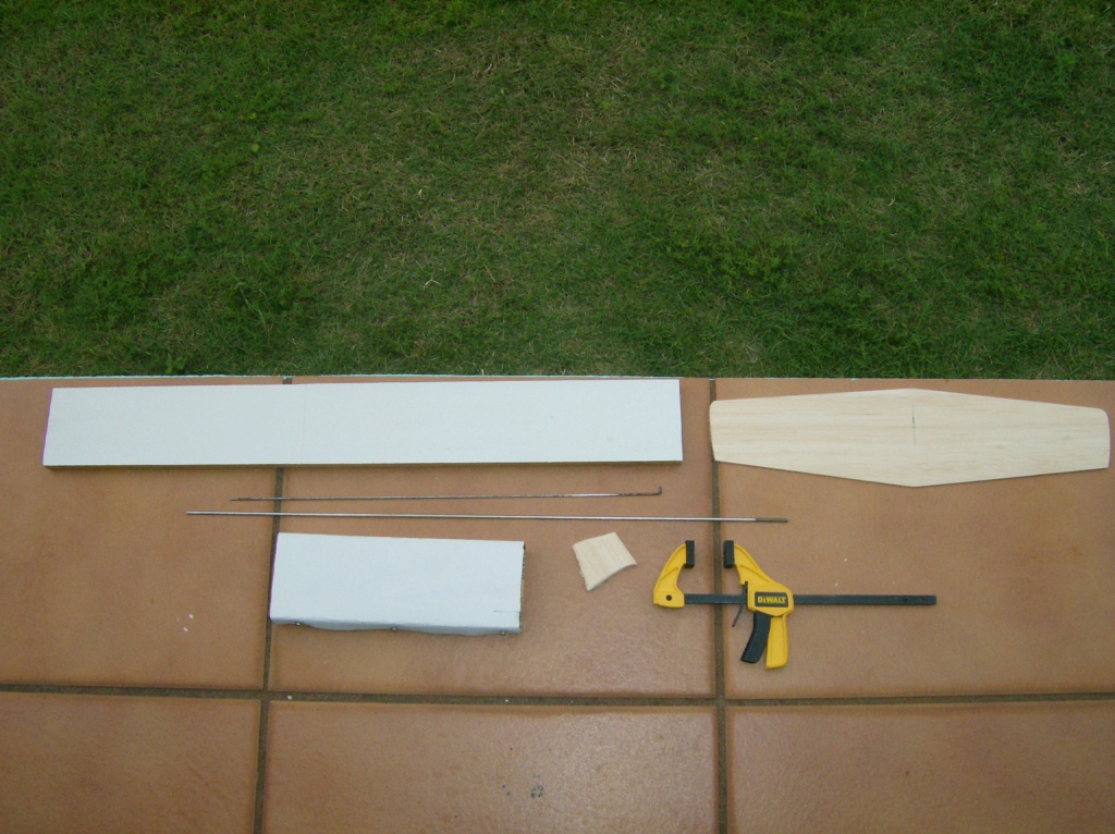

I already cut the wing and started sanding. I drew a pencil line 1 1/4 inch spanwise for it to be the high point of the airfoil. Using a flat piece of plywood with 80 grit sandpaper glued on to place the wing while sanding so it would not slide around. With two small clamps I placed a 1/16 inch piece of music wire and later a 1/32 wire close to edge of the board with the sandpaper for it to be a guide for the bevel I was sanding in the trialing edge of the wing. Since the wood I`m using is Hard Balsa I used 180 grit paper to sand the shapes.
I used a 3/32 music wire to shape the leading edge of the wing. The plans states that you can taper the wing from root to tip but I decided not to do it since it would require building a jig to be able to get it right. after getting it as close as I wanted I sanded the wing with 400 grit and rounded the leading edge.

I like your technique Juan. I've never tried that.. but have thought about it. Keep up the good work!
Re: Round the pole flying
Great idea, and an even better job! Well done.

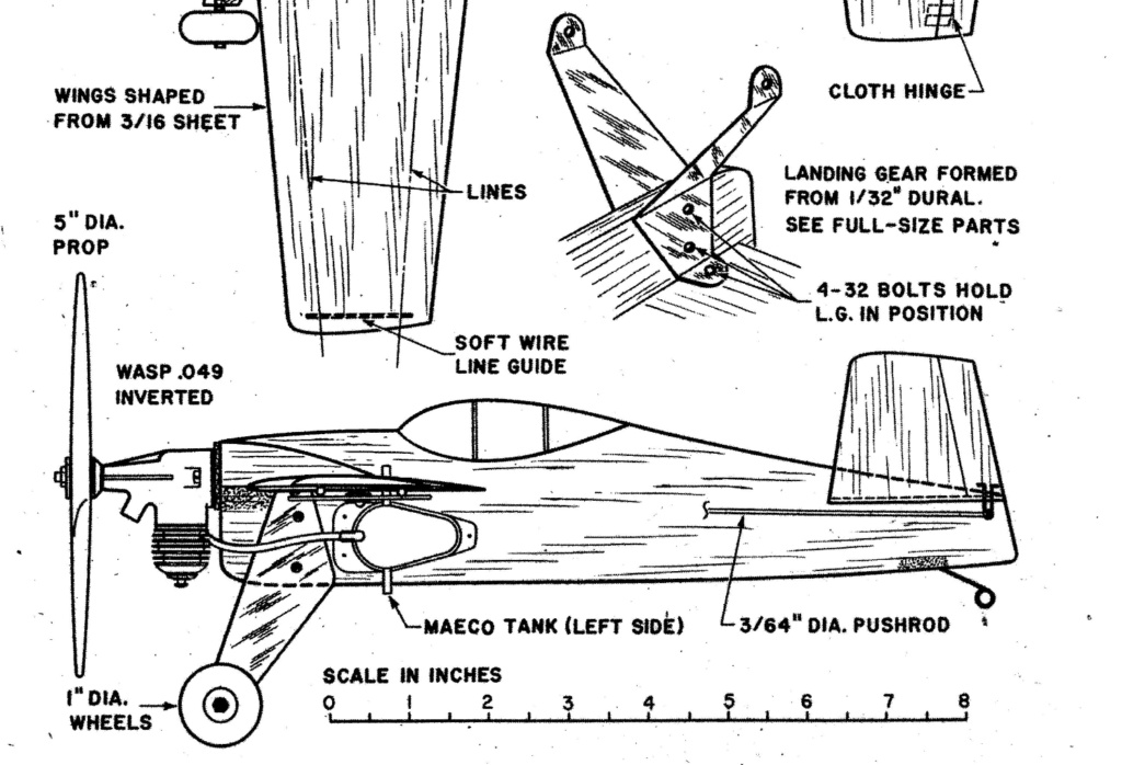

I have done some work on the aluminum 1/32 thick landing gear. The drawing of the bend lines in the plan are incorrect. If you take a look at the side view that shows the L/G on the plane you notice that the l/g is raked foward and that the wheel axles are inline with the firewall. If you bend as shown you would have angle foward the gear and it will have a positive angle in relation to the thrushline which will make them act as a canard that will push the nose up in flight. I changed the bend lines to be able to rake the l/g without causing that problem. All bend lines in the gear have to be paralell. I made a tool to clamp the aluminum gear at the correct angle before placing them in the vise for bending and to provide the correct bend of 45 degrees. The bend has to have a small radius 2 to 3 times the thickness to avoid cracks on the aluminum at the bend.Here are some pics.

I have done some work on the engine mount. The suggested 1/16 inch plywood for the firewall I thought that it was too thin to mount the Atwood .049 engine. i made mine out of 1/8 plywood and since I will be using wood screws I glued 2 small pieces of 1/8 ply 3/16 in diameter right behind the holes on the motor mount. I drilled thru them and threaded 2 wood screws to see how they fit. I epoxied the firewall to the cowl cheeks. I placed a piece of wax paper over the nose of the fuselage so I could remove the firewall and cheeks for shaping. Doing it this way is a lot easier than sanding them in place. Still have to do some sanding and checking engine and flying surfaces alignment before I glue everything together.

Looking Good Juan !! Is there going to bee offset in the engine , since it is a V tail.

Thanks guys. Getback there is no right thrust or rudder offset since it`s going to be flying in a short string. I will try first with a pole low to the ground to see how it behaves after it runs out of fuel. Since I have no fuelproof dope I gave it a coat of clear epoxy removing the excess with a paper towel and when it dried I did some light sanding. I painted the canopy and the wing tips. I haven`t glued everything together because is easier to handle individual parts for masking and painting. I made some numbers and a Texaco aviation decal on my inkjet printer but I`m still thinking on painting other parts. I guess I could do a checkerboard decal for the tail but I would have to order some decal paper
