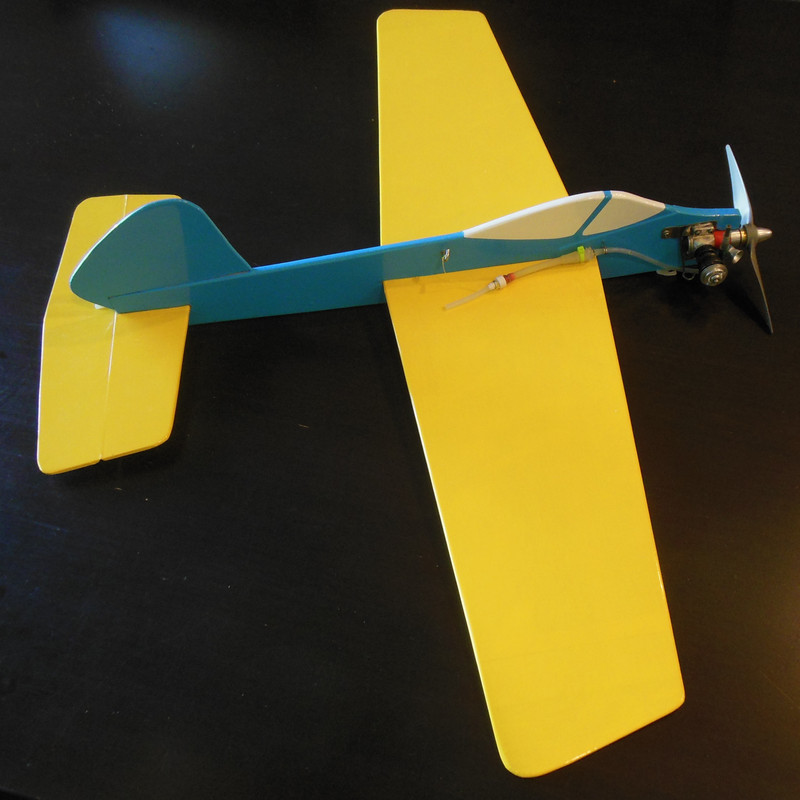

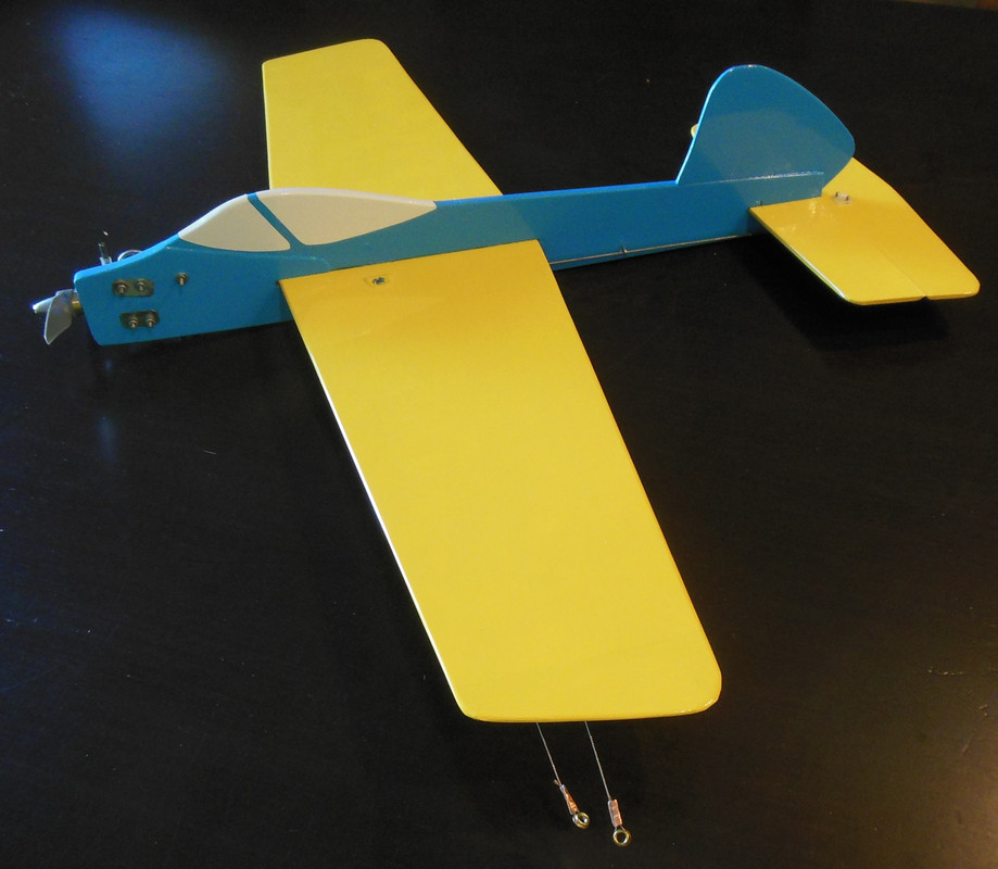

After flying the BRM, the club hotshot showed me his old Flip that had about a thousand flights on it. He recommended I build one, so I slapped this together in a couple of evenings also. It’s a Dick Sarpolus design. A TD .051 on bladder will power this. I’ll try 35’ lines, and have a set of 40’ on standby if the TD tries to screw me into the ground.

Took the Flip out today and put three flights on it before it got too windy. It was just windy enough. The plane literally jumps out of my hand on launch. Yes, I know. The word “literally” is literally overused, but weighing only 6.45 ounces and running a TD.051 on bladder, swinging an APC 6x3, this literally jumps out of my hand. It’s just a tad tail heavy, so I’ll either try a heavy Cox prop nut, or just put a nickel on the nose. Probably go the nickel route since I don’t like the idea of loading up the crankshaft with needless weight.
Here’s a brief video of the Flip flying. I keep forgetting to turn on the camera before I start the plane, so this picks up a little after half way through the flight. You can see how easily it goes through the maneuvers. Sorry about the camera angle, this is the first time I've tried to video someone else flying with my hatcam.

I love them both Mark, but it's the blue and yellow Flip that draws me in.
It's all screwed up said in the most likable way. The wing is on backwards and the profile of the rudder/vertical stab is weird yet attractive. And that rudder........huge.
The forward leaning cockpit adds aggressiveness and is positioned perfectly. I love the whole thing.
I only wish it were mine.
