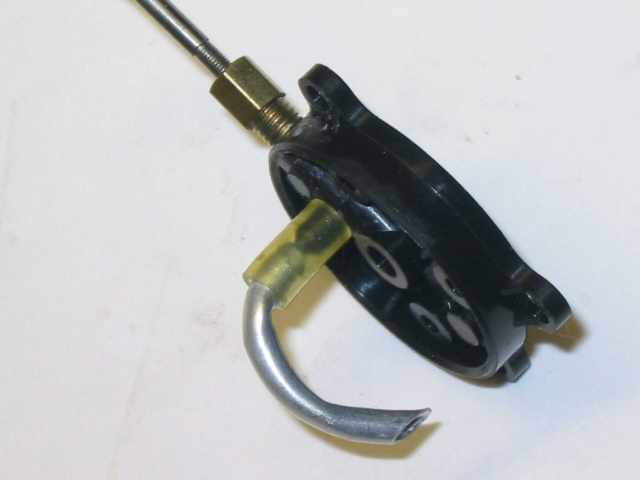

I have flown the 1/2A Texaco event in the U.S. for years starting back in 1994 until 2007.
Started off with the Baby Bee with a 8cc tank. Then the Cox Texaco 049 with the 8cc tank. Then the Texaco Jr. with the 5cc tank.
Played around with different back plates, SPI timing, reed thicknesses, needle valve assemblies, mufflers, glow heads and glow plugs (with head adapters), head shims, larger props up to 9 inches in dia., No Nitro in the fuel, White gas (Coleman lantern fuel -5%).
I was a consistent trophy winner. Problem I had was every two years (rules cycle) the would change the rules to try to reduce my chance at the trophy.
My winning engine consists of a back plate with a .063 venturi hole, the plastic removed from the inside of the back plate, the Kern Kraft needle valve assembly (which is now illegal) and a thin walled aluminum tubing.
Prop I use was a APC 8x3.8 Slowfly prop
Used the 3 fin glow plug with one or two head shims.
I did not use the "Texaco" glow head because it wouldn't keep the head warm enough to run the full tank out.
I have included photos of the inside of the back plates mods. Not visible from the outside (for a few more seconds of fuel).
If they knew, they would modify the rules (again) to stop these mods?
