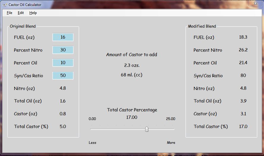

I'm glad that spreadsheet was of some use for you. I wrote that over 15 years ago simply because I got tired of doing the calculations by hand. At the time I was mixing Sidewinder 20/10 and Sidewinder 30/10 with BeNol to get the blend I wanted. I also have an Excel calculator for one mix that is a little easier to use. Later I wrote a Windows application that uses a slider to allow selecting the desired castor percentage after entering the original fuel mixture. It allows the user to drag the slider with their mouse and spontaneously recalculates the values. Unfortunately, all I have is the executable which my email provider will block. The original code was on my office computer, but I guess I failed to migrate it when I retired.
I am attaching a screen shot of the Windows product -- it worked well.

You have advertised your newer GUI-version the last few times I mention your "old tool," but your screenshot looks like it is for doctoring-up the castor content of one fuel.
I hope the new one can do two fuels. I guess I need to try the new tool.
