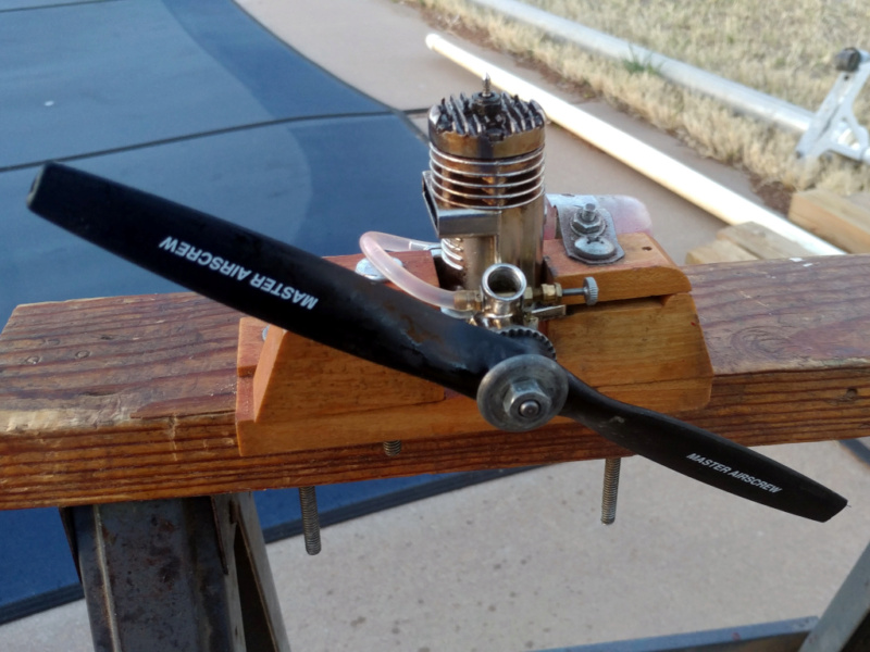

The week before for a dry run on my engine test setup, I mounted my K&B .35 mid-1970's Stallion in my stand with a 10x6 prop, for its first test run. This is the engine that I cleaned up a couple years ago that started out as a basket case. My clean up is in this thread:

I thought it appropriate to do a dry run with my setup before I mount Jason's Golden Anniversary Fox .35 Stunt and run it. This Stallion has a special place in my heart, because I was able to fully redeem it from its obscure past that damaged it. It is like hidden gold, the engine actually in spite of its scarred outward appearance, is quite pristene otherwise, should give a long service life.
I thought it fitting to give it a shot. It reminds me of Rusty, how even being scarred with a potentially debilitating health problem, never let that hinder his enthusiasm and gusto for life and support for this forum.
With a good electric glow ignitor and my custom glow fuel consisting of 13.5% nitro and 25% oil of which 10% is Castor, 15% Synth, I figured, lets give it a short go.

I had difficulty with a new 1800 mAH Nimad clip on glow ignitor. Although from auction photos it looked like a quality unit, seemed to enjoy good reviews, I found that my copy wasn't that good. The inner portion that is split 3 ways and curled is supposed to grip the glow plug when the stainless tubing collar is lowered overtop it.
My problem igniter next to a Hangar 9 power panel wired igniter.
It didn't. I took my needle nose pliers and carefully bent the radiused in edges, to make them more radiused so they would grasp the bottom of the plug flutes for wrenching. Now it caught, but the center pin makes poor contact with the plug's center electrical pin. If I hold down on the ignitor centered overtop the plug down about a quarter inch and hold, now it makes solid contact, which goes away if I let up.
My other ignitor with a Radio Shack battery holder for 2 D sized batteries, the holder believe it or not was made of a very cheap plastic. It held up for a couple years, but finally gave way. It's front side cracked completely off from the pressure of the spring negative clamp from field use. I looked at it figuring I could salvage it by using some sheet metal roof flashing material, but maintaining electrical integrity would be difficult along with pop rivet ends interfering with the battery being properly seated. Plus, I need to replace the wires. The 14 gauge stranded wire insulation has been Castor hardened from being soaked by Castor and is cracking.Starting Attempts:
OK, so, I fueled up the 1 oz. plastic tank, opened the needle 3 turns, then put the igniter on with my left hand holding, my left foot placed on the lower horizontal brace of the saw horse stand, and my right hand flipping with a chicken stick. If I could simply get it ignited and running even rich, could pop loose the igniter, tweak the needle, then let it run for a couple minutes until tank ran dry.
This never happened. The 1 oz. tank was mounted a little on the high side, but this never really gave problems before, because I'd have engines start up quickly with a good glow igniter, be up and running in short order. About 1/4th of the tank was empty.
I close the needle completely, it is still draining. So, I disconnect the fuel line putting it from the NVA to the vent side of the tank to seal it off. Then turn stand and engine upside down while moving prop, letting excess drip from the crankcase through the venturi and exhaust port.
OK drops shook out. Next, I continue flipping whilst holding the igniter overtop and pressed down over the glow plug. As long as I do this, it pops. Then have a series of short braaaps and finally a long one. Flipping now only pops, meaning I burnt out the excess charge in the crankcase.
After repeating this exercise a couple times, I figure it is time to call it a day. I just proved, “The definition of insanity is doing the same thing over and over and expecting different results”.
The good is, even with those short bursts of run time, then engine actually is in very clean condition. The repolishing of the interior surfaces has left some gray colored spooge dribble out. Now the engine when flipped has extremely strong compression like that of a broken in new engine. Doesn't even bubble around the piston when moved against compression.Dirty Needle Problem:
Found later that the needle wasn't fully seating inside the the spray bar, when it stopped turning. I took it apart, ran a pointed tool around the needle collar inside to break loose any crude buildup. After wiping the grime off after fishing, started rethreading the needle back and forth in the spray bar. It acts almost like something cross threaded but is not. Might be hardened Castor and corrosion.
After a combination of carefully threading back and forth working further down along with gleaning from a pointed tool, a couple dozen times, now the needle fully seats very smoothly in the spray bar. There is about a 1/128th (0.008) inch gap between the edge of the needle collar and spray bar mount nut. This now matches my other Stallion, also passes the mouth suck test, is air tight when closed.
This story to be continued ....

During Sunday afternoon now at home, I mounted the Fox .35, putting a new Masters 10x5 prop on it (didn't want to damage the 9x6 wood that came with the engine kit).
With my setup, again doing the left foot on the saw horse cross brace to keep it from moving, left hand holding down the HSP igniter, right hand flipping the chicken stick, all I got was a soft burble from the Fox plug, not even a brrraaaappp. I'm wondering if it requires more current from say a power panel. After several attempts, it was starting to get dark.
