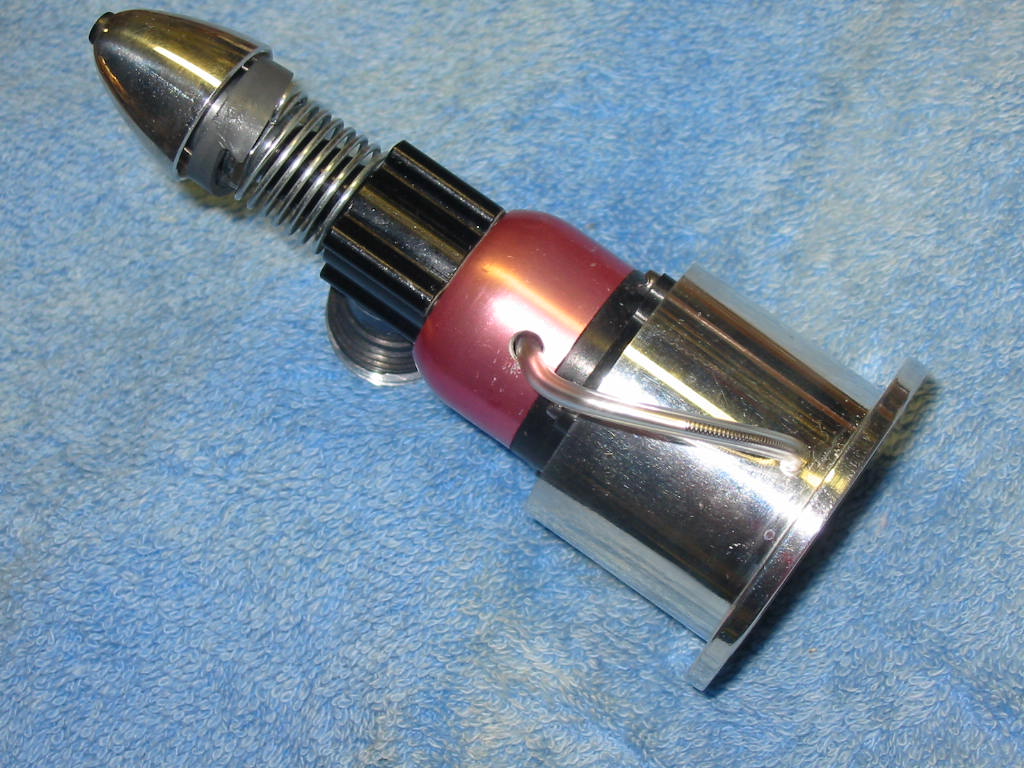

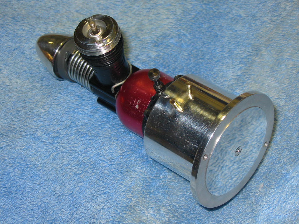

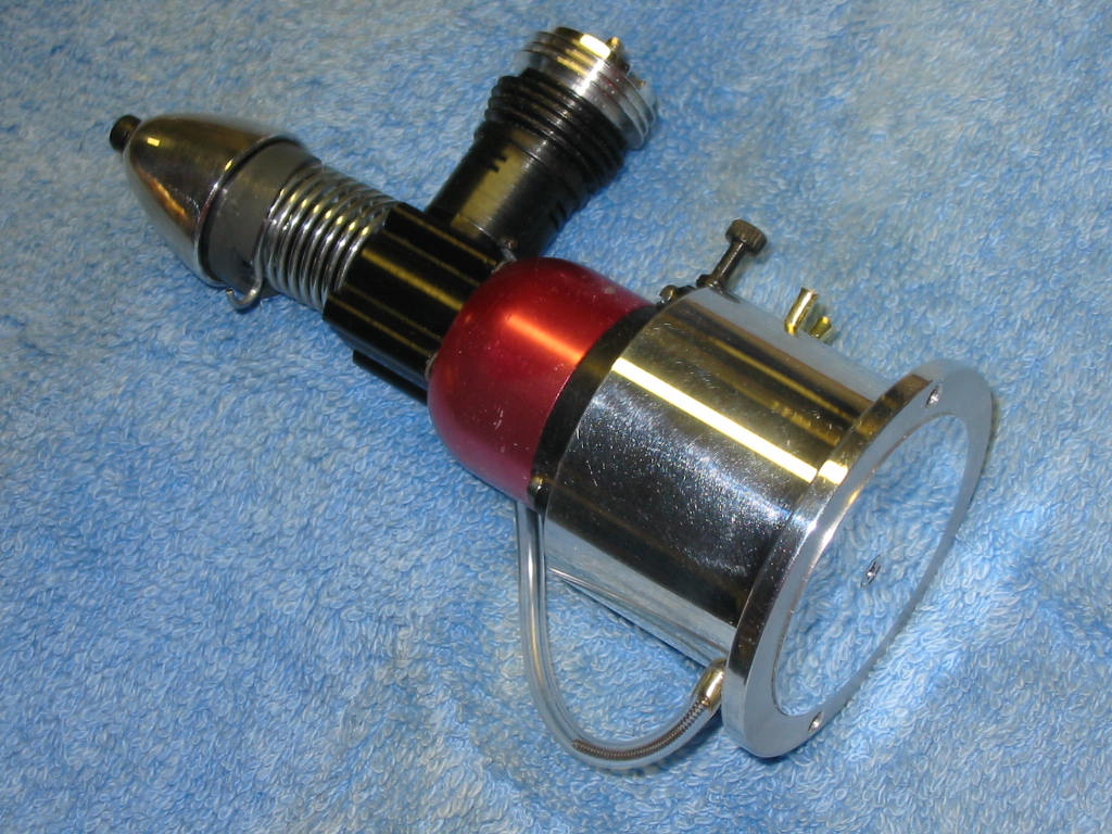

Mike Myers gave this engine for a trade.
The engine belonged to Sal Taibi (what Mike Myers said).
When I got it, it was all gummed up and nothing was able to move.
I tore it down and cleaned it up. Also did some buffing (polishing).
The tank was made by Sal Taibi.
He made other tanks for Cox Tee Dee 010 / 020 as well.
Here was an auction on *bay of one of Sal's tanks for an Tee Dee 020.
https://www.ebay.com/itm/Sal-Taibi-Tank-Mount-For-Cox-Tee-Dee-020-Engine-/174453427614?hash=item289e3c0d9e%3Ag%3Ap6IAAOSwqqNfcAYv&LH_Auction=1&nma=true&si=EWFdod8k3F1DzDgYdbWXi3gdjx8%253D&orig_cvip=true&nordt=true&rt=nc&_trksid=p2047675.l2557

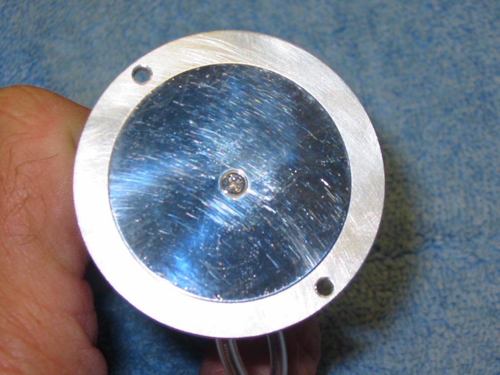

Mike Myers told me that the back of the tank leaked.
There was nothing holding the back plate to the tank.
I modified the back plate with a hole in the center for a countersunk 2-56 x 1-1/4 length screw.
There is enough material on the other side of the tank to tap a hole for the "long" screw.
The idea came from the Cox Tee Dee 010 and 020 tanks to hold their back plates to the tanks.
It worked and there is no tank leakage.
The engine runs between 29 to 32 minutes on one tank.
Ran it on 5% nitro. with a Cox 8x4 Comp. prop and has a Norvel type glow plug.
Neighbor complained "how long are you gunna run that thing!" Maybe install a muffler on it?
Engine/tank weight is 105 grams / 3.7 oz.
So, I have completed the engine and have posted photos (before/after)
Super Tanker (30cc) Cox 049 Texaco 049_te10
Super Tanker (30cc) Cox 049 Texaco 049_te11
Super Tanker (30cc) Cox 049 Texaco 049_te12
Super Tanker (30cc) Cox 049 Texaco 049_te14
Super Tanker (30cc) Cox 049 Texaco 049_te13
Super Tanker (30cc) Cox 049 Texaco 049_te15
Super Tanker (30cc) Cox 049 Texaco 049_te16
Super Tanker (30cc) Cox 049 Texaco 049_te17
Super Tanker (30cc) Cox 049 Texaco 049_te18
Super Tanker (30cc) Cox 049 Texaco 049_te19
Modified backplate with 2-56 x 1-1/4 long flathead screw
Super Tanker (30cc) Cox 049 Texaco Backpl11
Super Tanker (30cc) Cox 049 Texaco Backpl10
