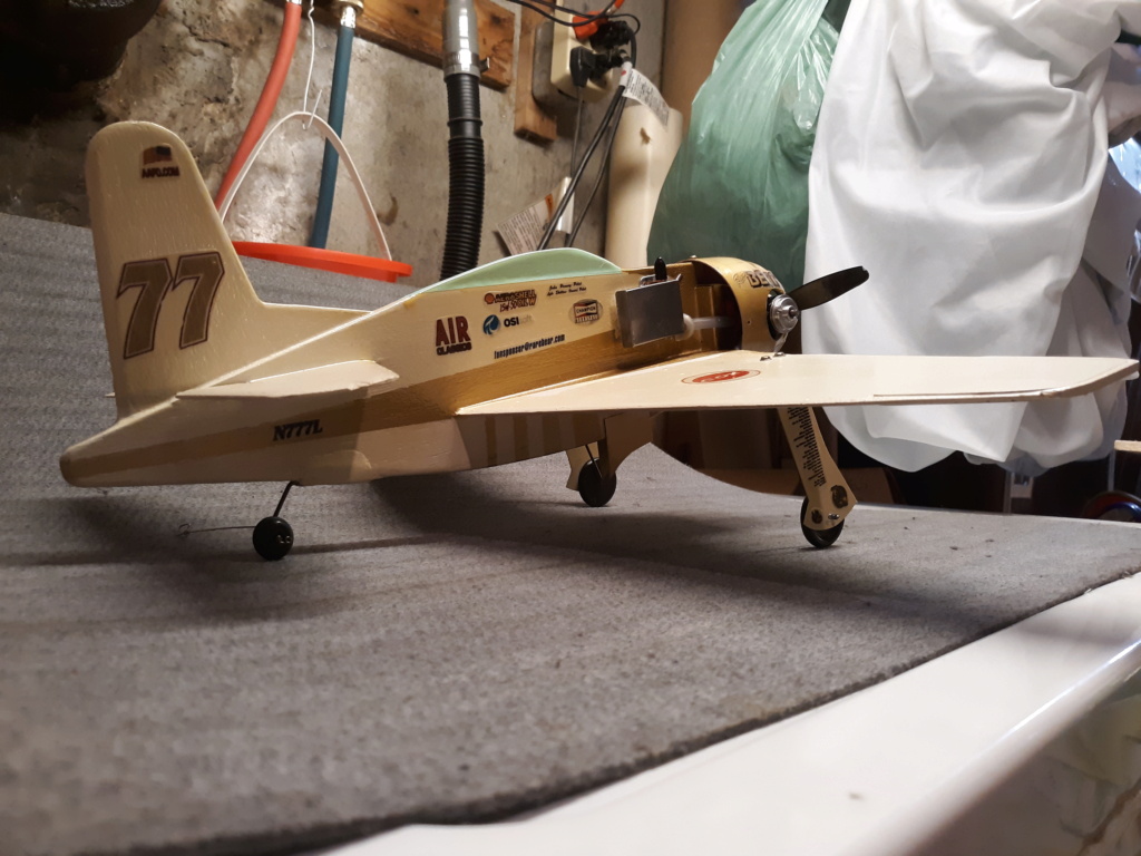

The Rare Bear has yet to fly.. due to multiple launching faults/follies. It's nose-heavy.. and the gear-mains are set back under the wing's leading-edge. It's the ragged-edge of being able to R.O.G. launch.. There's only been two instances where I've tried to fly this airplane. 1st was for the CEF Speed contest that it was built for.. and 2nd was just last year. Nose-overs plagued any attempts at R.O.G./stooge-launches.
I wonder if a break-away launch-streamer clipped to the top of the fin might help to keep the tail "down" until the model gains enough speed to be responsive to elevator commands.

Roddie,
Just re-angle the gear and extend it about an inch. That is all that is keeping it from getting off the ground. Don’t worry about looks.

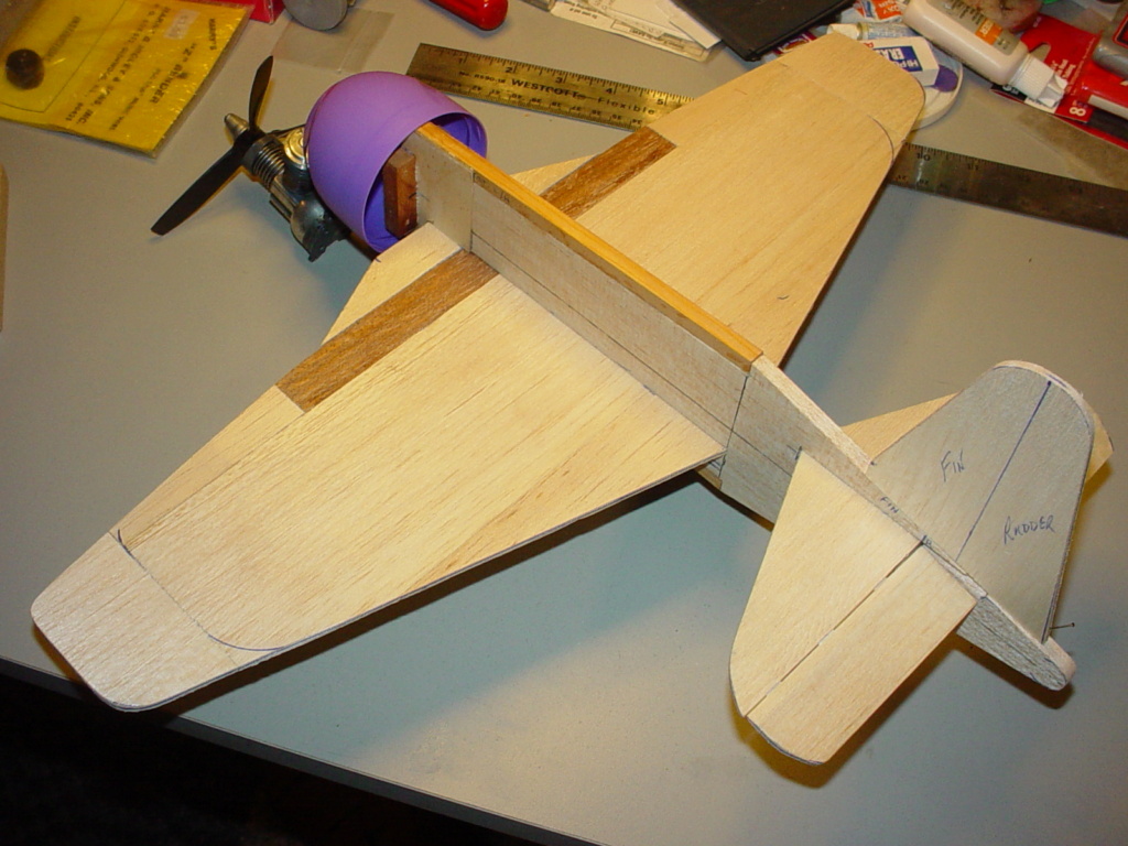

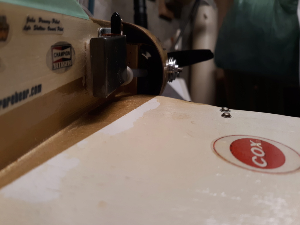

Hi Ron! Yea.. I'd need to remove the gear-blocks to REangle the struts forward. The struts are beefy 1/16" music-wire. The gear-blocks are made from 3/8" Cherry square-stock.
Rare Bear 2020 11-19-15
There's a walnut strip-spar built-into the L/E of the wing, which the gear-blocks mount to. It's very rigid when assembled.
Rare Bear 2020 11-15-11
Rare Bear 2020 11-28-11
I tried to find the balance-point tonight using a fixture that I'd made.. but the model just pitches fore/aft no matter how I set it. Maybe it's a Grumman F8F-2 thing.. Shocked There isn't too much safe clearance for the propeller if I angle the existing gear forward. I could forego the cowling.. and swap-in an "inverted-V" gear for in-between the engine and firewall.. but I'd really hate to resort to that.. you know?
