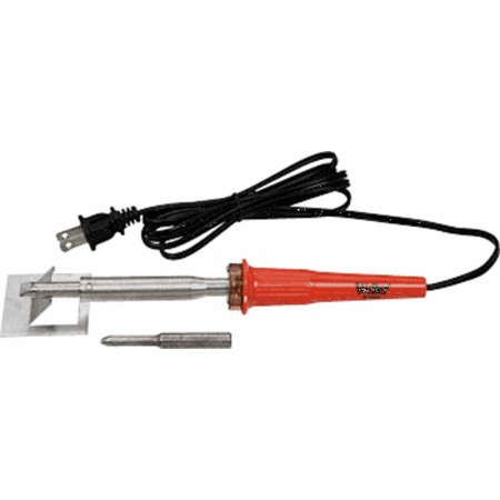

I have always made my own tanks.
I get the "kit" from Brodak and solder it up.
You can purchase the 3 oz. tank and make it yourself.
It's not very hard to do.
I've been making my own tanks for years from simple fuel tanks to uniflow, to chicken hopper tanks.
Give it a try. You just need a 80 watt soldering iron.
40/60 acid core wire solder (wire size/guage 0.080")
You can get both of the above at your local Walmart or Menards.
And the 3 oz. Wide Wedge Uniflow Fuel Tank Kit 3 by Brodak (SKU# BH-783) for $14.99

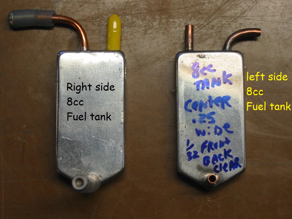

Here are some fuel tanks I made for a friend for a trade.
I got "3" Tee Dee 020 engines (engines of the month - November) for making the tanks for him.
1/2oz. tanks and 1/4oz. tanks

O.k.
Yes, the wedge is a trough at the bottom of the tank, so you get every drop of fuel in the tank.
I run fuel allotment events and the tank is measured by the contest director for fuel size.
If the tank is bigger than the fuel allotment. Your tank is only filled with that allotted fuel for that event.
With the measured fuel tank you can top off the tank before releasing the plane
This is an event for SAM (Society of Antique Modelers) called "Texaco". Longest flight wins (engine plus thermals)
There are three different Texaco events. One called 1/2A Texaco. Which uses the Cox 049 with the 5cc tank. The next is "A" Texaco which limits the engine size to .051 to .20cc and fuel to 14cc for glow / 8cc for diesel. Then the "Big" Texaco .21 to.90cc with fuel allotted up to 28cc. Favorite engines for "Big" Texaco are the Open Rocker 4 stroke engines.

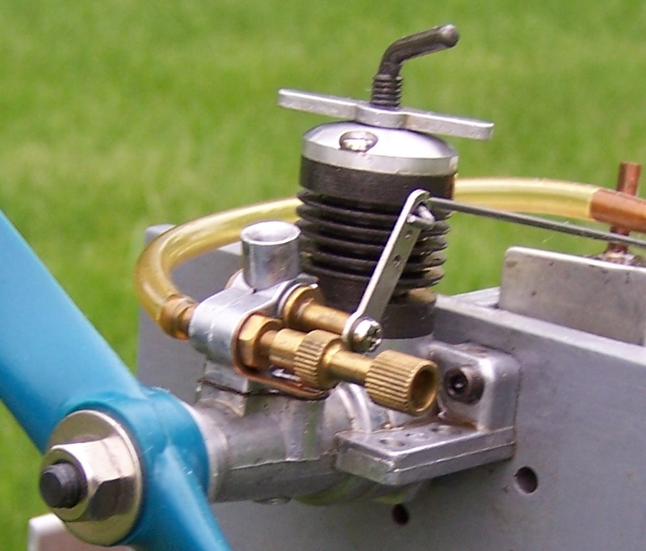

Here are my uniflow tanks mounted to my Enya 06 glow and Enya 06 diesel.
This photo of my Enya 06 glow shows the uniflow tube up over the engine to get "clean" air (from the prop) to push air into the tank. The bent tubing goes to the bottom of the tank -- above the fuel pickup (the wedge -- "Vee"). The fuel is sucked up from the bottom of the wedge to get every drop of fuel. I cap off the overflow vent so the bent pipe will pressurize the tank from the prop wash.
This is why I have a left side or right side tank depending on which side the fuel nipple is on.
This photo shows this tank's uniflow where both the fuel pickup and intake (uniflow vent) go to the bottom of the wedge.
I have not capped the vent tube yet as this was a photo before fueling.
I wanted to see the difference it would make to have the bent tube pressurize the tank verses a straight tube.
The last photo is of my Enya 06 diesel. With the tank from the photo above. The bent tube as the fuel pickup and the straight tube as my uniflow vent. and as usual, I'll cap off the vent when I fill the tank.
Then, I tried the bent tube uniflow tank facing the prop wash.
With the diesel, it has more than enough suction compared to the glow, it didn't matter to have the bent tube face the prop wash or have the straight tube uniflow tank.
As for the brass strap. It just makes it easier to mount the tanks to the firewall of the plane or the side of the plane.

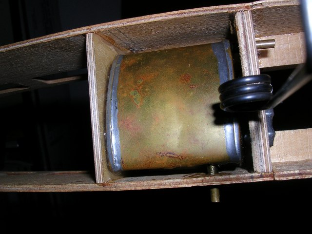

Are brass tanks really nasty? Some sea fittings on ships are made of brass, because they do not corrode like steel does. Many of the CL kits of the past came with brass tanks.
My 30-in wingspan OK Model Pilot Cessna 177 Cardinal kit:
Brass tank as installed:
Old surgical rubber tubing used back then used to go bad in short order, needing replacement, just saying.

Anyway, You are on the right track.
I get my tank building supplies from K&S (hobby shop).
The other place is Brodak with his tank kits.
