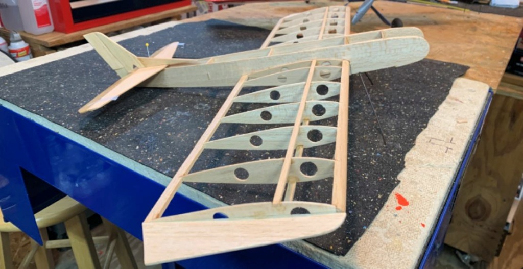

So, this little kit popped up on Ebay, and I stalked it for a few days before a last-minute pounce netted me another project in my crowded shop.
This is yet another "Snubbing My Nose at the Past" affair, having built a Little Tom Tom when I was 13 or so, and ending up with WAY-less-than-nice results. The build went well, but I was strapped for money to buy the incredibly expensive bottles of Aerogloss dope to finish it.
My youthful impatience took charge and, instead of waiting and working to get the funds, I decided to try finishing the model with spray paint from some cans I'd found in our old coal shed. As I said, the results were WAY less than nice, with Little Tom Tom's fuel-soaked gooey finish being impossible to clean, or even handle without it leaving it's traces on your fingers.
Like many others, it's life ended in a "Viking Funeral", and another early Life Lesson learned.
This one will be different. It's gonna get a finish of similarly expensive Brodak Dope on silkspan (from my precious stash of that macho tissue), with a base color of cream, red trim, and copying the scheme from it's box photo.

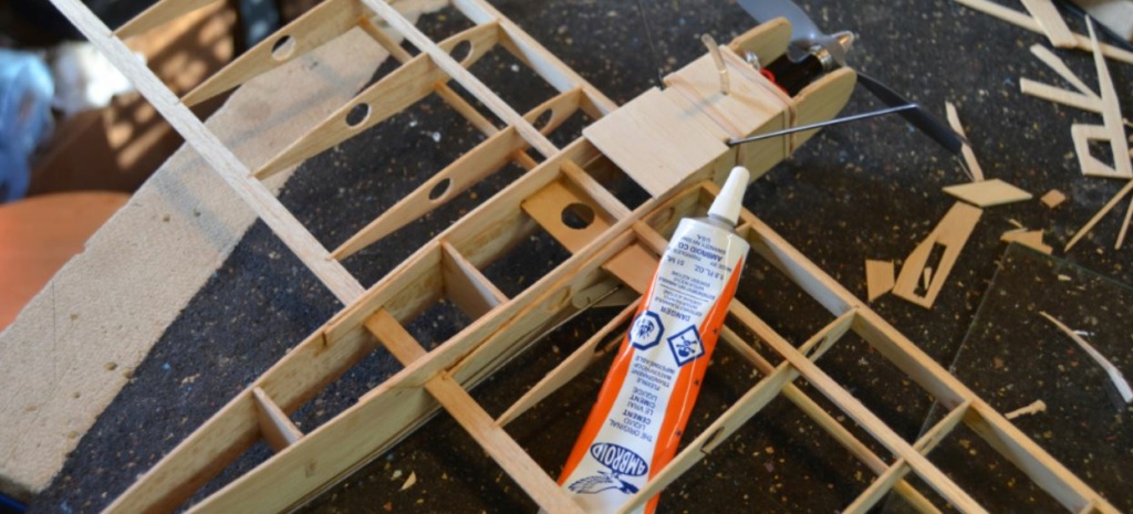

The kit's die-cutting and balsa are actually pretty nice, and I had few problems getting the parts loose from their sheets. I'd assumed, because of it's similarity to the other 1/2A VECO kits that it was designed by the legendary Joe Wagner, but a fellow named "J.E. Barr" is listed instead. The plane is very close in size to my Uncle Wayne's Dumas-kitted "Scout", and was my choice back in the day to add a bit of variety to our flight line.
Little Tom Tom will be powered by the .049 I won in a raffle at S.M.A.L.L. (Super Thanks to Matt & Bernie for their sponsorship of the wonderful event!), with a 3/8 oz wedge tank holding the go-juice.
My kit building seems to take forever these days, with lots of "stopping and staring breaks" as projects crawl along, and with plenty of interruptions to walk my gravel road and think about things. Eventually, I get stuff framed up enough for photo-ops that helps spur my enthusiasm.
I'm currently resisting the urge to pirate the wheels from one of my two beloved Wen Mac Aracobras---I know: the plane is a flying dump truck---but it's wheels are beautiful little things. A set has been flying on Uncle Wayne's Scout since 1968, so if anyone has a couple they'd be willing to part with, I'd be happy to buy them.

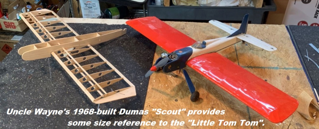

Re: Veco/Dumas "The Little Tom Tom"...65° and the Dope is Flying
Apart from the wingtips and stabs it looks eerily similar to the Scout! You just keep building buddy! I envy you.

Cribbs74 wrote:Apart from the wingtips and stabs it looks eerily similar to the Scout! You just keep building buddy! I envy you.
Thanks Ron!
Yeah, the wing frame and fuse look to be just about identical to the Scout...there may be a story behind that deal.

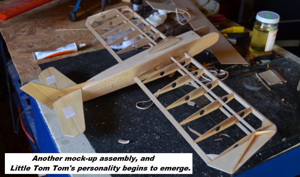

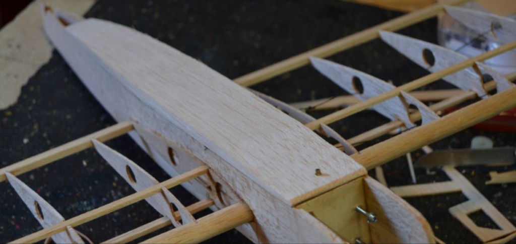

The continuing saga of "Little Tom Tom the Circle Turner".
Don't know if my retro controliner is gonna be ready for Breezy Hill's "Black Fly Day" on the 27th but, if not, it may be up there as a "Show-&-Tell" static display. The Flyers appreciate the work and time it takes for this special kind of silliness.
After a bunch of carving and sanding, it's time to start the finishing process, which often takes longer than the building process. The paints used---Brodak Dope in this case---must be allowed curing time between coats, along with a light sanding before each new coat is applied.
Since I can't keep the shop heated all the time, Little Tom Tom will be brought inside between each painting session to help set the finish, so the house will be filled with the special aroma that used to get me banished to the front porch.
It's wing frame will get a brushed-on clear coat to adhere it's silkspan covering. Then more over-all layers 'till it starts to shine, when the paint gun comes out and a thin white coat is applied for a base color. This is followed by scheme color and trim, and a floor littered with bits of masking tape.
As Rudy Pittman (my ex-father-inlaw) might say, "It's looking mighty airplaney!"

Frame up looks Good But i must ask why are you using (what appears to bee fishing line ) for lead outs ? I have stopped using those because i had a few issues with burning them with the monokote iron and that's a repair before first flight i don't want to do anymore
With built up rib wings of course.
Posts : 8826
getback wrote:Frame up looks Good But i must ask why are you using (what appears to bee fishing line ) for lead outs ? I have stopped using those because i had a few issues with burning them with the monokote iron and that's a repair before first flight i don't want to do anymoreWith built up rib wings of course.
It's another one of my goofy "things". I was given a huge spool of carpet thread back in '68 or so as a gift intended for flying line. I quickly figured out that it was way heavier than the dacron we all used, but found it was great for lead-outs on my PT-19's and other RTF's.
My Big Otto has been using it since 2000 with no problems, and that old dog has seen a lot of flying time. I only use it with nylon bellcranks and plastic tube guides, figuring their hardness to be similar. It's much lighter than cable lead-outs and I've never really liked the music wire type because of it getting bent where it exits the guide tubes.
That's my only excuse, but I've got high confidence that these lines will still be operational long after I've lost the ability to turn with the little 1/2A.

Hey Kim, That's a good-looking little ship! I had a concern which you may have already addressed.. but I didn't read anything further on the engine-mount.
The distance between the tank and firewall. If you're mounting the engine with wood-screws, I'd beware of their length possibly piercing the front of that tank. Perhaps your using 4-40 T-nuts/screws? If not; maybe cut a piece of 1/8" birch-ply for a firewall doubler?
Is it too late to re-orient the engine's backplate 90 degrees; facing the needle out the inboard side of the cowl.. and a more direct (and shorter) fuel-line install.. with the tank's feed-tube being right there? Would probably only require an inch of fuel-line in that configuration.

Roddie, knowing Kim's meticulous modeling construction work, it would not surprise me that he has already worked the engine mounting details out to contain 2-56 to 4-40 screws and blind nuts, so the tank isn't penetrated. The reason for the forward mounting of the tank is so that the tank's outlet tubing sufficiently penetrates the firewall so there is sufficient length to mount the fuel line to. I've done that on various occasions on both CL and RC aircraft.
Those wedge tanks work great for simple RC (rudder only or rudder and elevator, no throttle), where one doesn't do extended inverted flight. Orient the wedge downward.
Good to know George. I bought several Perfect-brand wedges from Dan McEntee when he offered-up a bunch a few years ago. He also had some "Dr.'s Paper" (examination-table paper-covering) that he was experimenting with, in place of silkspan.
