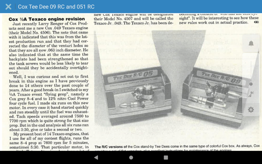

After Good search in the sceptre flight link hard To Find texaco test y Find it its found wit cox tee dee .09 rc.051rc
test look
Test found texaco engines duration inconsistent result of trouble wit production new matériel used change of ventury size y want more info on différence wit difrent ventury and back plate change rpm duration
test look

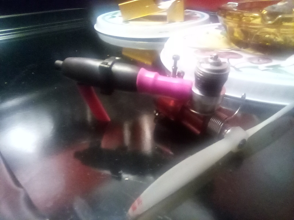

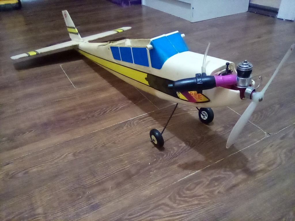

Couple modification change ventury now same size of back plate Bolt exaust collector modification over size wit difrent back plate now texaco or black widow plastiques one ventury jet size larger than the one y used last test was runing bether like 13 000 rpm consistent Not tested my engine after new modification is now instaled on m'y ez bee
Tink is redy for run now

Thank you is a spécial plane To me long time y have Not run m'y old ez bee crack in firewal and Bolt fixing the two part Front fuselage now fix
