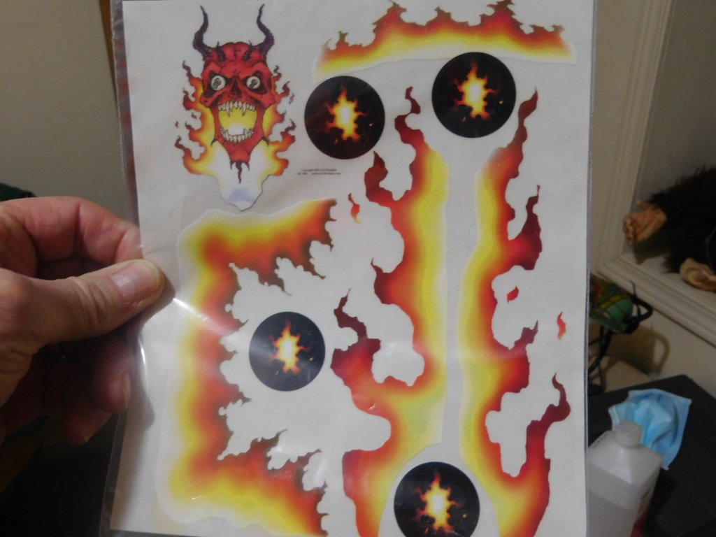

Well i'm waiting on a can of Deft lacqure spray sanding sealer,  installed more sheeting need to sand the leading edge and a few more spots, before i get the sanding sealer.  here are some decals i pickup for it.  It weighs in at 1lb 3oz as it sits. Does anyone know how the decal super satan i posted here is applied? is it a iron on? I got it with the short kit. But just this evening got around to looking at it.

I would think the decals are water slide from the looks , what does that small writing say? Rudolph

getback wrote:I would think the decals are water slide from the looks , what does that small writing say? Rudolph
The big decals/ flames are stick on, i was asking about the other Super Satan decal. I have an email out to the company it came from but no answer.

Post  Cribbs74 Fri Dec 25, 2020 2:05 pm
My guess is water slide, probably why it has a protective sheet on it.
