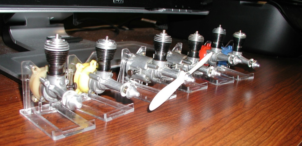

So, if someone can please fill me in?? I have an original Space Bug with the later cylinder with larger head threads. I'm confident that this engine is all original as I got it from the guy who had it shipped out to him new in Canada. (Now lives down the road from me). But just to be sure, what features should I be looking for regarding the case differences?

Cribbs74 wrote:Trivial or not, there isn’t a thing you can do Bob. Don’t worry about tomorrow sufficient are the worries of today. Virus or no virus people are dying at a rate of 105 a minute worldwide on a good day. We can’t mourn all the time or we would never live ourselves.
So, immerse yourself in what makes you comfortable. I don’t have a spare case, but let me look at my Space Bug Jr front end. If it’s an un flanged case maybe we can swap front ends. I don’t have any concerns about what style case it is and it’s made up from parts anyway.
Ron.
P.S. a pic showing what the difference is would be good as I am not entirely sure what you are talking about. Nevermind I figured it out!
Glad you found out Ron, But I'm still struggling to see the difference, they all look the same to me.
Didn't have to go out to the garage to get these, but I did have to dig them out of the display case, no easy task.

If you look at the yellow Space Bug Jr. in your pic and compare it to the Space Bug right beside it you will see that yellow one has a pronounced casting ridge where it meets the tank while the Space Bug does not.
Edit: I read Doug’s post again and I see another big difference... the bolts enter from the rear on mine and they need to be coming from the front! So my case probably won’t work for the other Bob. Been messing with these things for over almost 40yrs and still learning stuff!

Cribbs74 wrote:Good luck Bob!
Got it. Thanks Ron.
Had to dig them out again.
Edit to your edit Ron.
I noticed that first thing, but aren't the cases drilled and tapped all the way through enabling the machine screws to come from either end?

Nice Collection Bob , the reason you don't see the difference is what you show is all non flange
Sorry just had too , congrads on the for coming SHOT , Were not there yet for my age I wasn't aware that the two cases wouldn't interchange
The older is the non flange right? Dickerson i thought you had this puppy done and talking about problems , i have had constipation for 3 days now going to get me some prunes today
My Bad i didnt see that , i went and looked at mine and all are the early non flange at least what is in my case .

getback wrote:Nice Collection Bob , the reason you don't see the difference is what you show is all non flangeSorry just had too , congrads on the for coming SHOT , Were not there yet for my age I wasn't aware that the two cases wouldn't interchange
The more i think about it, that wouldn't work either, the SB's case would have to be smooth, no threads.
