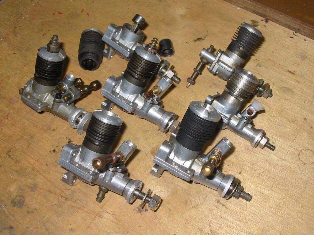

Here are the photo of the "junk" engines from Japan ( these engines are like seeing Cox engines here for sale)

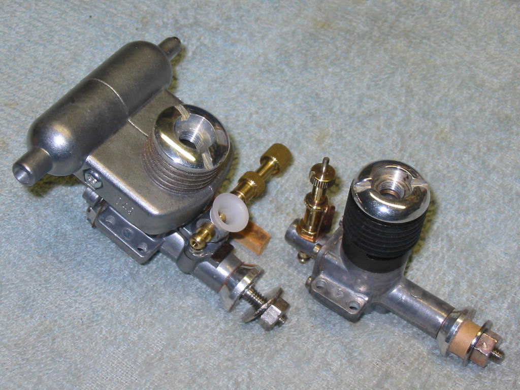

In the upper right corner of the above photo are "two" Enya .049 engines.
Below are those "two" engines refurbished --- thanks to some parts from BoB Brooks. (shtterman@aol.com)
Major problems with these "junk" engines are, being gummed up and tying to be forced to turn without heating them up.
So you'll see plier marks on the prop washer (driver) an other places.
In the "junk" photo, you can see the 4pc piston is apart ( missing the "C" clip that held it together - I'll make my own "C" clip to replace the missing one.), The piston was stuck in the cylinder and the prop washer had very heavy plier marks on it. Which I will get a replacement prop washer (driver).
Here is a photo of the 4pc piston ( Enya .049) after being refurbished:
