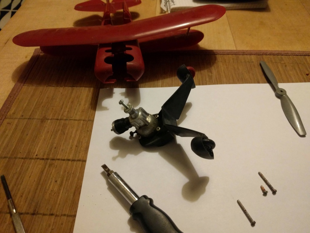

The original TeeDee cylinder (bottom right) is still very good and I felt that the cylinder bore was conical. The Tribble Drome PeeWee (top right) and the housing (middle right) also have the thin-walled cylinder. I was hoping they have a tapered cylinder bore too. At the moment I cannot safely disassemble the two because of the left hand and spine. It's torture, total lockdown, a bunch of model projects started here, but I can't do anything right now.
