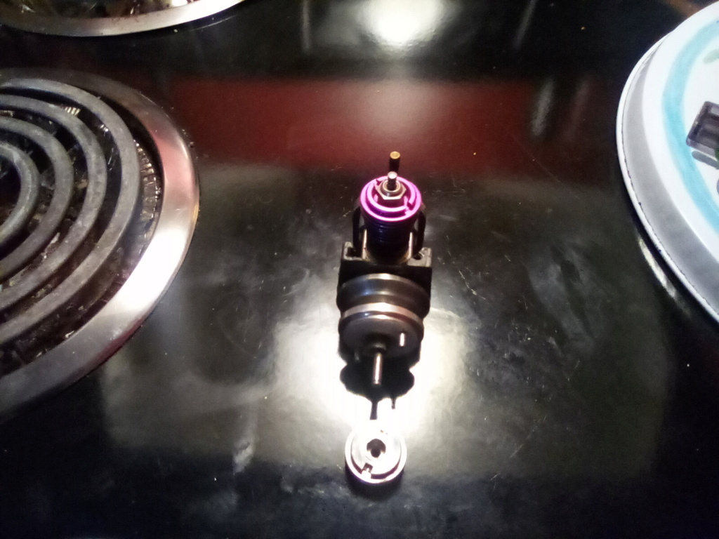

Y change cylinder use rc ring now se how low rpm y have very low rpm but the engine run like diesel ruff if y try To lean the mix if To mutch it stop tinking if the g5 plug wil help y tink y need lower compression y have chim cylinder now no spi wit two head gasket
y have To try stuf tinking somting wrong wit the mix y wil change nitro content and try some aditive tiner like toluen Not sur

Wow nice job David! Good luck with your tests!davidll1984 wrote:
The final result engine run Good redy for test wit gaz
