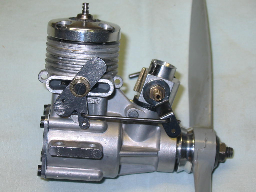

Help! A Little Bling-bling
Post  sosam117 Thu Jan 14, 2021 9:01 am
If you listen and do things right, you'll have a good looking engine!
Two Thimble Drones -- one before cleaning and one after cleaning and buffing
Getting Ready to Attempt some Restorations - Newbie - Page 2 Thimbl11
My slightly polished up Thimble Drones.
Getting Ready to Attempt some Restorations - Newbie - Page 2 3-thim10
