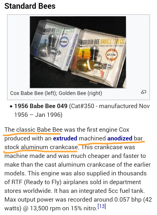

Post  Levent Suberk Thu Jan 21, 2021 2:12 am
Cribbs74 wrote:That was my thoughts exactly Rod. Why have some engines last longer than others. Seems like poor quality control. I can’t dispute Larry Renger and Mudhen. Both worked at the Cox factory. I thought I had read somewhere that all cases were anodized, which would make total sense, but apparently they stopped doing it in the 60’s.
Who knows, I suppose you could say who cares.... lol!
I still wouldn’t polish a case.
Ron, you are right with early made engines. They were clear anodized:
https://www.secret-bases.co.uk/wiki/Cox_model_engine
