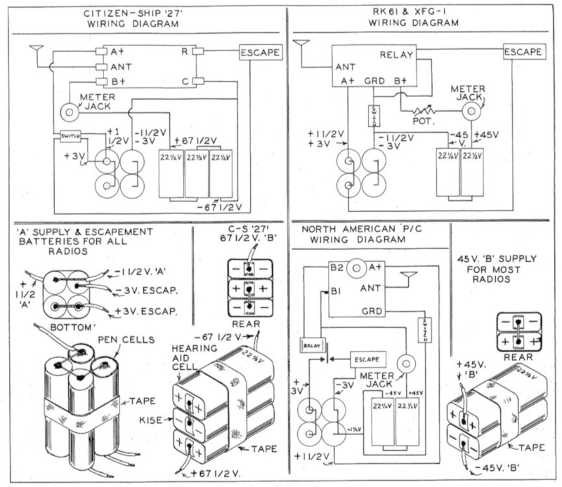

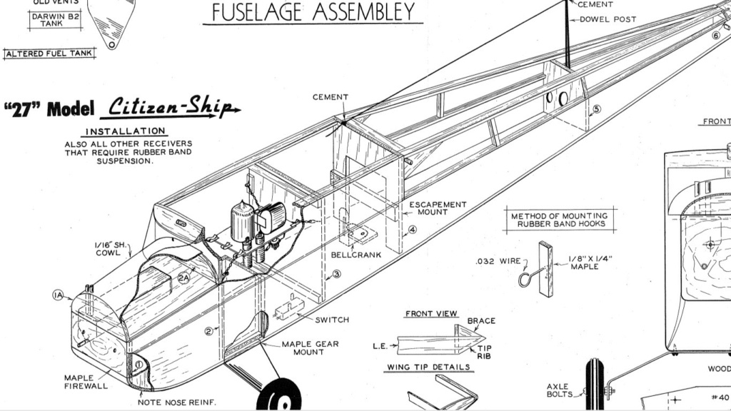

You are welcome. Regarding its porky looks, it was designed for the radios of the time, which were 1 or 2 tube (valve) super-regenerative receivers with 1.5 to 3 volt heater elements, a 45 to 67 Volt B supply for tube plate current, and another 3 volt battery for escapement control electrics. Being larger including the battery payload, the fuselage had a cavernous area to haul such.
For example, the similar 1953 Hal DeBolt 34" wingspan Livewire Kitten aircraft radio installation:
Battery and switch wiring for several different receivers. Note, the 22.5 Volt hearing aid or photo flash batteries were still available in the early 1970's. I bought them back in the 1960's and 1970's to use with my flash bulb unit for 120 and 220 roll film box cameras (2.25"x2.25" negative size). They looked exactly like your standard 9 Volt transistor battery, even had the same connectors, but were about 0.25 inches longer.
Can you imagine all of this using less powerful carbon zinc dry batteries of the time, which had shortened life? I don't know how often they needed to be replaced, but it must have been may be a half dozen flights, given the low milli-Amp Hour (mAH) capacity of the batteries.

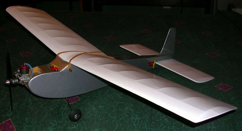

Regarding ROG, The Minnie doesn't do a good job IMO, ground loops very easily. You may have better luck with a throttle-able engine, but I never had much luck even with throttle. A good strong hefty toss by hand straight out is all that is required, like you would a baseball, holding the fuselage just behind the landing gear. It flies out at about a 35 MPH speed IMO. After all, it is a cabin job, not a speed plane.
I'd have to brush the dust off my rebuilt Minnie, put radio gear and batteries in and weigh it. May be 5 years ago I made a new fuselage, totaled in a Figure-9 back in the early 1980's. I put a Norvel Big Mig .061 R/C in it with the 1 oz. tank mount. Wing I'll have to recover, because I used shrink older sock covering, but it never quite aligned right warping. I have standard plastic covering that would be better for it.
There hasn't been as much motivation to quickly finish, as here in Eastern NM, we almost always have winds above 15 MPH at the flying field, making small flight and rudder only flying nearly impossible. (Hardly any trees, the tallest terrain feature are the parking lot speed bumps in front of Hobby Lobby.)

Wow. Your Minnie looks terrific. And now you brought up another great point. With a model such as this, at what wind speed would one be able to fly these small planes in? Or should I say it as what is the max safe wind speed one should fly these little planes in. Is there a cutoff where you do not fly past? Sorry for all the questions, but at every turn, it seems that another question pops up.
