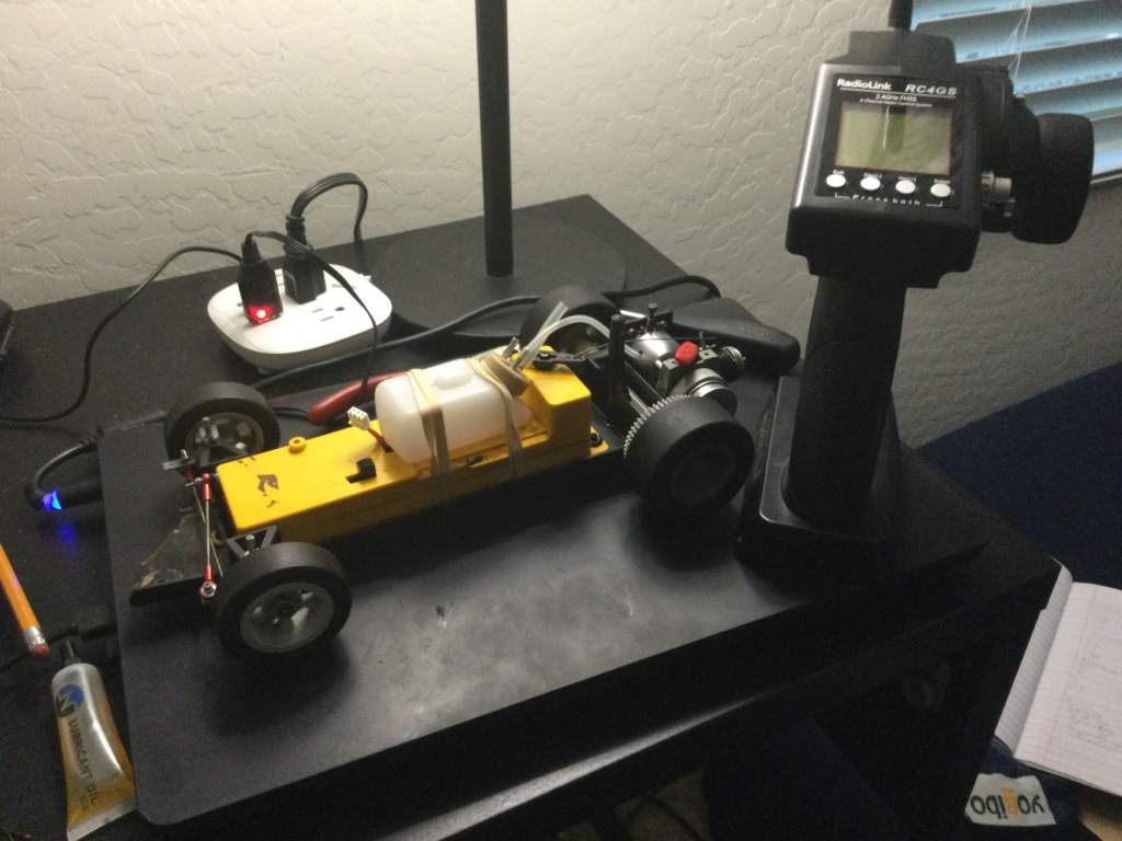

Post  Lukemiester Fri Feb 19, 2021 9:05 pm
Took this earlier, only good picture of it as of right now
Is this car a good buy? (I won it!!) - Page 3 C63fcb10
Here’s how I have my electronics set up- I’m using the original switch, an ovonic air 850mAh 2s lipo, a radiolink R6F, and two hitec HS225BB servos. They are “mini” size- just smaller than a standard size and bigger than a micro servo. I used pieces of a lawn mower air filter as shims where I needed it.

Post  davidll1984 Fri Feb 19, 2021 10:07 pm
Cool y like To se them run just To help dont run To lean without the heatsink wit that large fuel tank Not for To long To start them To get correct fuel seting keap it runing ritch wil help save engine and use oil lots of oil Not To mutch just bit over normal plane engine nead use just 15% nitro for Now wil help to

Post  Cribbs74 Fri Feb 19, 2021 10:17 pm
Great work!
It does drive well, a little rich, but yeah it moves along nicely. If I could impart some wisdom get a small syringe and fill it with fuel. Open the throttle to expose the exhaust ports and drop a few drops of fuel in the cylinder to prime the engine. You won’t have to pull the starter cable as many times before it fires and begins to draw fuel on it’s own.
I am jealous! Still acquiring a few things for mine. I didn’t have the factory receiver so having to fabricate the servo setup, battery placement, tank placement etc.
Edit: Just saw David’s post, I agree a little more oil maybe 22% 1/2 castor 1/2 synth, but don’t shy away on the nitro. At least 25%. I don’t use anything less than 35% on anything I use. Nitro allows the engine to run cooler and gives a significant boost in performance also aids in setting the needle. Too much nitro however, you start to burn through glow plugs!

Post  Lukemiester Fri Feb 19, 2021 10:41 pm
I’m waiting on my heatsink and 1 fin head, also for now i have the body off so I’d imagine it’s getting pretty good cooling airflow I’m using sig champion 25%. I think it has 22% oil, 1/2 klotz and 1/2 castor iirc. Also i used some of that air filter for a supplement to the screen for filtering and I’m pretty sure its starving it of some air, cuz after those videos it just would not tune right. I’m taking it off for tomorrow.
Aaand i solved my weird clutch problem- the clutch bell was really loose on it’s spindle so I figured I’d put some oil on it to help it spin without much wear. Apparently that was a bad idea because when i took it apart just now there was oil on the clutch shoes and the inside of the bell. I cleaned that up and it should drive better tomorrow.

Post  Cribbs74 Fri Feb 19, 2021 11:09 pm
The one fin head is for the GTP. Nothing wrong with using it I suppose, but they are not as easy to come by. If you purchased part #1970 it works with standard heads and
which are cheaper and plentiful. It may not work with the one fin. Wish I knew you needed a heat sink, if you mentioned it I didn’t see it. I have a spare.
Sig is 20% oil but still 1/2 and 1/2.
The stock screen is good enough, it won’t keep out dust and fine particulate, but Cox engines are tougher than they look. Keep some spare cylinders for the long haul.
