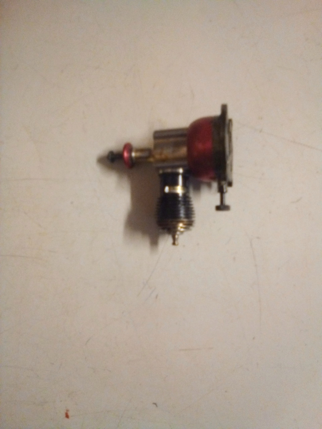

I have a tiny Cox engine with tank and radial mounting.
My phone will not pdf files.
Please what bore would the 10 be, and also the 20 ?
Still struggling to post a picture.
Thanks.
Thanks.

TD .010 bore is .237 ins.
TD .020 bore is .300 ins.

If you want to determine the TD .010 engine, it's glow head slots has no clearance between glow plug post.
https://coxengines.ca/cox-.010-glow-head.html
https://coxengines.ca/cox-.020-glow-head.html

Is there a Venturi on the front?Coxfledgling wrote:I have a tiny Cox engine with tank and radial mounting.
Thanks.

No carb on front snout. Looks like a miniature 049 that would be in a fledgling c/l.
Will post a picture tomorrow and will check glow head....
Would like a pair, or 2 individual 049's to make fledgling wings fly again. E bay prices are just
Silly over here in UK, would rather save up and get 2 new ones...
I know of Cox international and the other one, the USA one engines of america ??
Thanks for the steel rule view which will help.
Looks more like the one on the left....

Thanks guy's using all the info you have given, head, length and bore, it's a 20, a pee wee.
Will attempt to post a picture as is.
I will then clean and run up engine to check glow plug and running.
Great forum and great engines.
