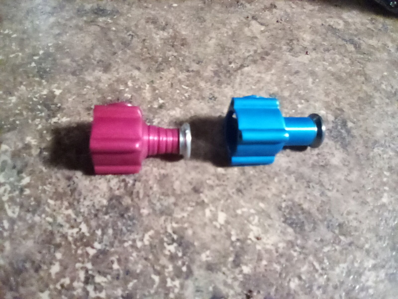

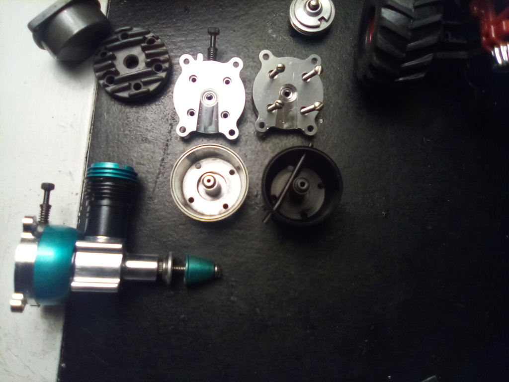

New color i made m'y .09 rc pipe look Good I lightened the parts from inside outside wit new look mabe help With the dispersal of the heat like heatsink ? wasDiy   Anodizing  - Page 2 Img_2085
Diy   Anodizing  - Page 2 Img_2086
lots of litle modification now use on m'y .049 engines i have To build new parts To fit made litle tube wit flange To Bolt To hold it

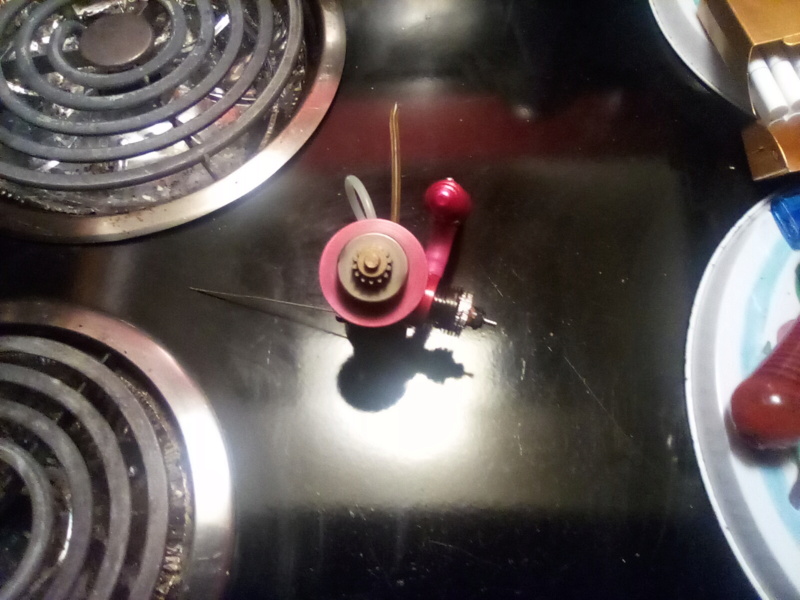

Look Good i made clutch flyweel To fit m'y new tune pipe color Diy   Anodizing  - Page 2 16155110
Diy   Anodizing  - Page 2 Croppe10
two color on the flywheel hard To see  one side red On the other side a little bit of purple the red color stain the other side and the two color mix To difrent color Not To mutch difrent from m'y tuned pipe the exaust collector is exact same color as the pipe
