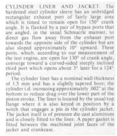

Does a Conquest, when new, have a tapered liner? I find it difficult to turn over the engine.

Without the glow plug in the engine the piston will really bite at TDC, while with the glow plug installed the compression appears to help avoiding metal to metal contact. I don't want to speculate on why, but is very clear. It is very important for high performance ABC engines, but the principle is the same for other engines too.

Re: Conquest question
Thanks Kris. I was wondering because Cox doesn't mention this in the instructions for breaking in. I found that P.Chinn mentions it in one of his articles (see Sceptre Flight) , but he didn't have to cope with it as Cox sent him an engine that ran for 1/2h already at the factory.
I will heat it up before starting!
