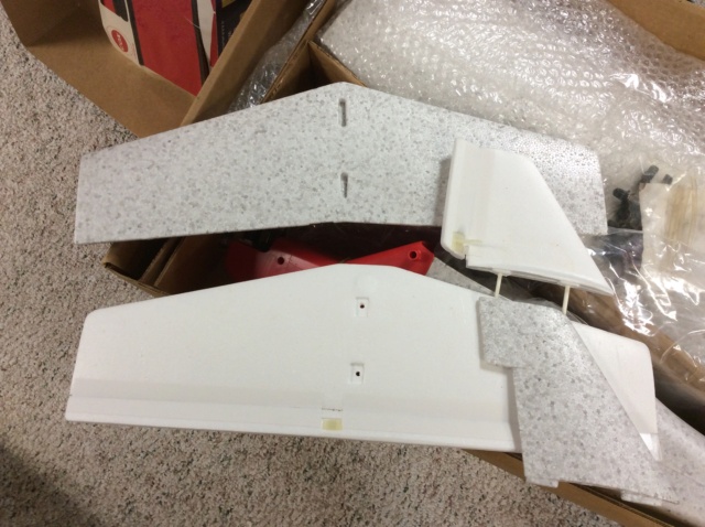

Well the difference is not as much as I imagined.
EZ bee has a 55” wing span, Recon is 41”
EZ bee fuse 4.25” tall vs Recon at 5”
If you remove the “RC camera” from the Recon there’s plenty of room to install a modern micro sized Rx and servos.
Cox Recon Model Ac2c6110
Cox Recon Model 605ad010
Cox Recon Model Ad9ead10
You would also have to install hinges and rudder/elevator to the stabilizers:
Cox Recon Model 5049be10
Search for some of Kim’s flight videos. He is a expert ( thru many experiences) at mounting video cameras utilizing sticks and scotch tape!!  FPV is the only way I could  fly a plane on RealFlight, so it would be awesome to try in a model.
