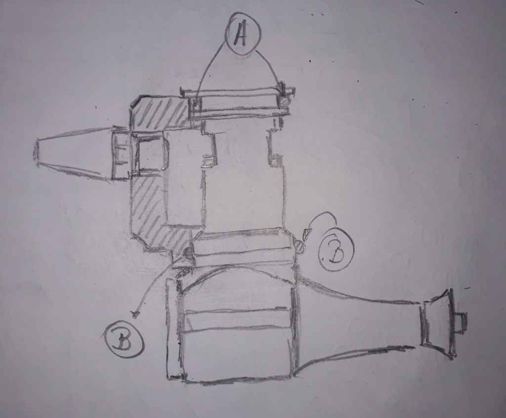

Congratulations Mauricio. Is the muffler held down on the crankcase by the lowermost cylinder fin after you screw in the cylinder, like most of the COX mufflers?
Posts : 4347
Re: Cox Sportsman .15 R / C and Homemade Muffler
balogh wrote:Congratulations Mauricio. Is the muffler held down on the crankcase by the lowermost cylinder fin after you screw in the cylinder, like most of the COX mufflers?
Thanks very much friend!.
No Andras, in this case it is held by the second fin of the cylinder counting from the bottom up.
It turns out that the base skirt of the cylinder is the same size as the bottom fin, therefore, as this muffler is one piece, the drilling does not stop or seal.
In the drawing you will see the sketch of how it really fits and is firmly fixed.
Points A and B were the idea of placing Oring in case it were necessary, but seeing the operating experience, everything is very well sealed and watertight, so that Oring is not necessary. Anyway I can place them as follows:
A) between fin 1 and fin 2, an Oring can be placed there
B) By making a groove in the muffler, an Oring can be accommodated.
But I repeat, A and B were an option in case of gas leaks and afterburners, but everything seems to go very well without them.

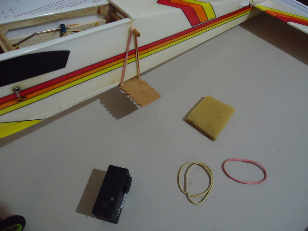

Thank you Mauricio, very well done. It is quite energizing to watch such a flight in the morning when you wake up and check CEF entries on the telephone while still in bed!
Where was the camera fixed on the plane, was it under the fuselage, crosswise? My small keychain camera sits mostly on the wing near the tip in order to avoid castor droplets hitting the lens.

Here I show you how to install the camera, everything is very simple. A plywood board, held up with rubber bands and built-in foam rubber to minimize vibrations. Everything turned out very well.
