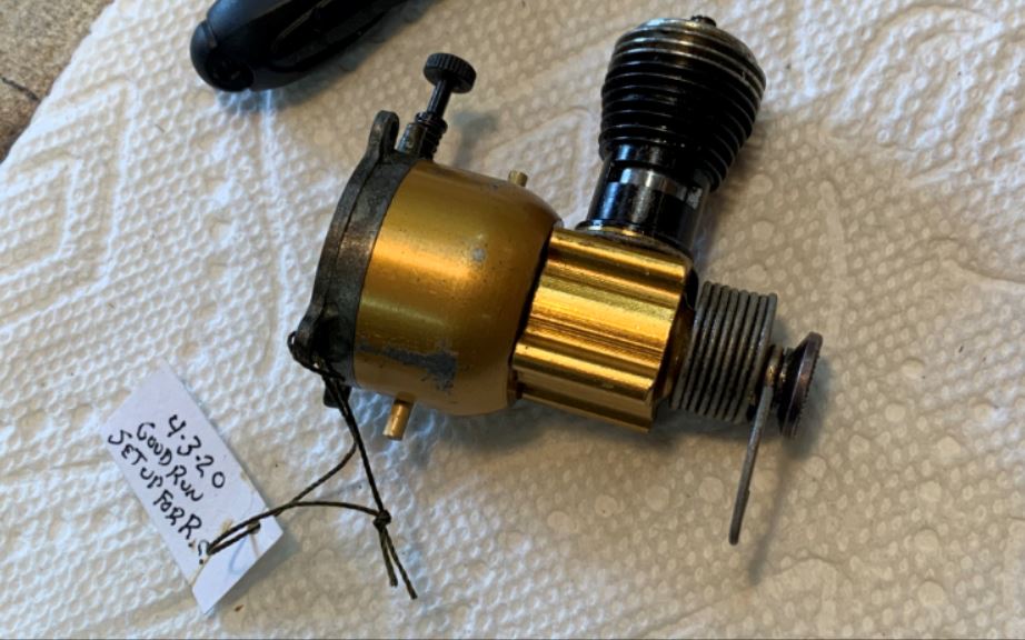

I just now tested it, and my magnet grabs and holds on---so yes...there's an insert in there.

Post  balogh Wed Mar 03, 2021 12:26 pm
Thanks Kim for checking..I expected it because aluminum threads would not hold for long.Heating the backplate will allow the  pressing in of a steel insert thanks to the different thermal expansion coefficients so assembling it should not be a problem.

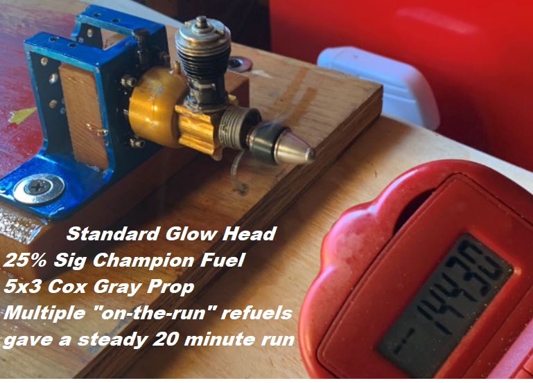

I wanted to run the "Stunt Tank" version backplate today, and rather than build up another engine, I chose a faithful old friend that's dragged assorted flying machines around the Hill and S.M.A.L.L's for a long time.
With no changes other than new gaskets and pick-up tube, the old Golden Bee got it's backplate swapped, and was bolted to the stand and cranked up.  I'd put several runs on the Babe Bee, but I decided to REALLY run it's golden sibling by doing on-the-run refuels just for the heck of it.
Once settled into it's run, the GB was real steady, and probably would have flown the B.O.T. all the way to Little Rock if it could have lifted the fuel.  After 20 minutes or so, I let it run out it's fuel with no needle-fiddling along the way.
One Note to Any New-Comers:  While the old hands all know this...it is important to use the fillister style backplate screws to prevent fuel leaks.  I just used the GB's original in the test, with no leakage, but I think Matt and Bernie stock them if you need replacements.
