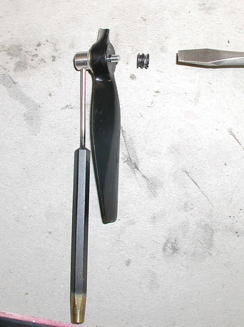

Broken prop held on to the motors shaft by a set screw.  Could remove the prop nut but the shaft just spun, no exhaust port to shove some toothpicks locking the shaft, so I had to disassemble the airframe.
Rather than tool mark the thrust washer I stuck a brass drift in the hole and spun it off.

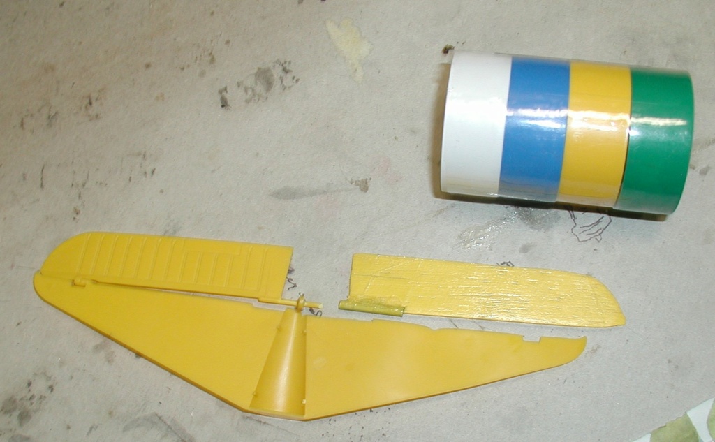

Might as well fix that elevator while I have it apart.  Not easy.  I would like to keep the plastic half and make the other side out of balsa but will probably have to replace the whole thing then hinge.  Sad

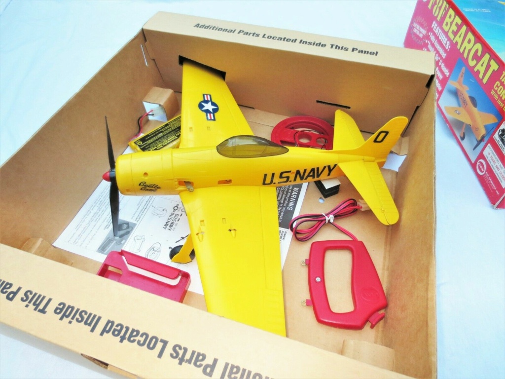

Second one.  No battery, no canopy, again but an unbroken prop and with the handle.  Wish it was adjustable but imagine it's on/off.

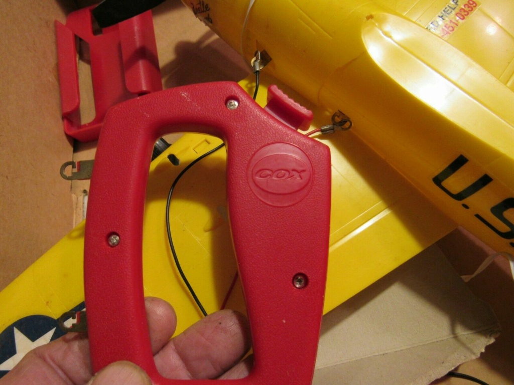

roddie - pictures. Battery holder clips onto your belt.

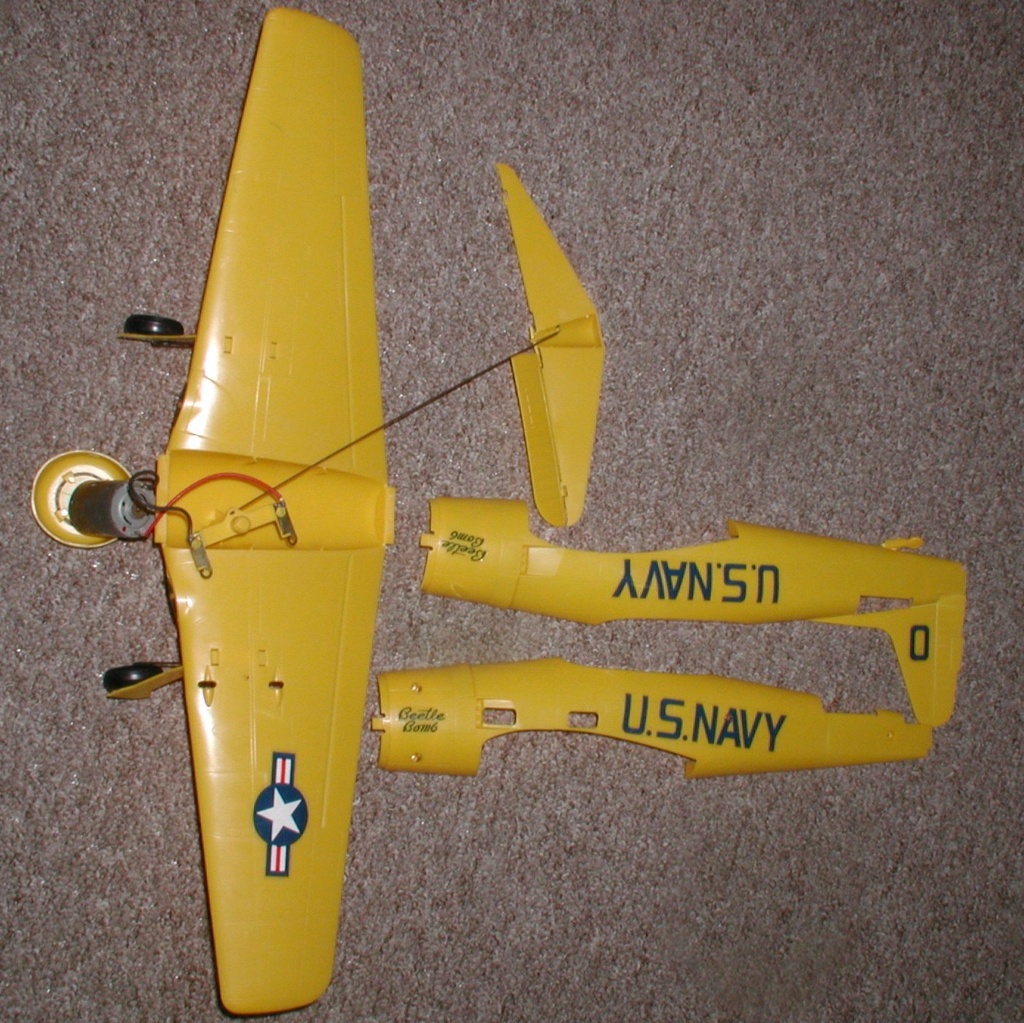

On my way to fixing the broken elevator. First I had to use a heat gun to take out the severe dihedral in the horizontal stab. I cut a piece of brass tubing to fit and it slides over the bitter end of the left-over plastic shaft. Going to crimp it on after filling the tube with plastic cement and hope that it holds. If not I will have to build a whole new elevator. Going to use yellow vinyl tape as a hinge on both sides, lengthwise perforated with an exacto knife at the seam every quarter inch or so. This stuff is strong, light, and flexible and won't be corrupted by spent castor.
Electric Cox F-8 Bearcat X2 P1010847
Electric Cox F-8 Bearcat X2 P1010848
My plan. Use this one as my flyer. As I'm subject to the dizzies, cut if off every few laps until I bring my tolerance up a bit. Ought to take no more than two weeks "flying" 24 hours a day seven days a week.

I LIKE the yellow vinyl tape Robert. That'll work for a hinge. It's just one more of those things that you need to flight-check. Smile
