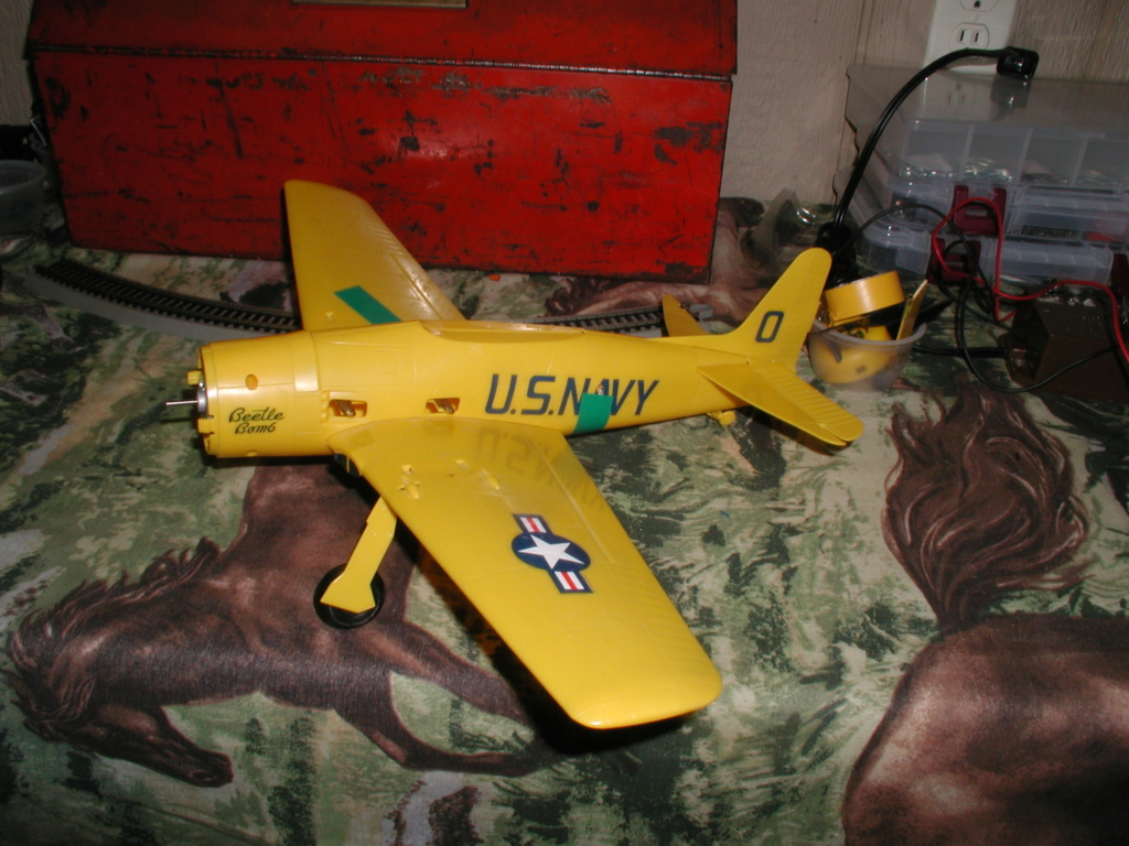

Post  rsv1cox Sat Mar 20, 2021 10:59 am
Yeah, both of these are hair pullers.
Second one lost it's wheel pants and was crashed taking out one side of the motors peg style retainers and cracking the cowl.  Fixing with Testors red tube.  Let it cure overnight and it's a winner, but will still back up with some sort of tape, maybe yellow vinyl but it can stretch.
Electric Cox F-8 Bearcat X2 - Page 2 P1010863
Electric Cox F-8 Bearcat X2 - Page 2 P1010862
Electric Cox F-8 Bearcat X2 - Page 2 P1010864
Electric Cox F-8 Bearcat X2 - Page 2 P1010866
Electric Cox F-8 Bearcat X2 - Page 2 P1010865
Electric Cox F-8 Bearcat X2 - Page 2 P1010867

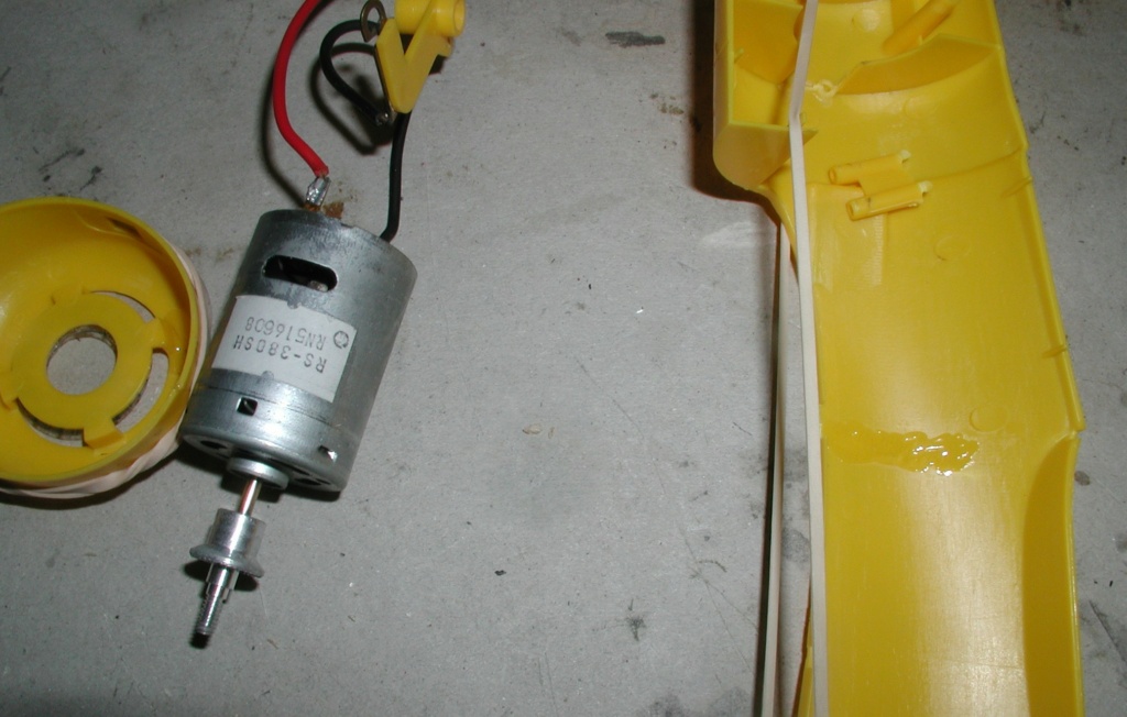

That's a popular motor Robert.. and it's likely in good shape. The "380RS/RS380" is a reference to its size. It's your standard can-motor for a multitude of hobby-applications calling for that size and output. You might be able to source an alternate propeller-mount for running a variety of metric propellers.. which are widely available for today's RC quad-copters.
This web-link might prove useful.. Your motor-specs are here.
RS380 motor
Link to airscrew adapters for 2.3mm output shafts.

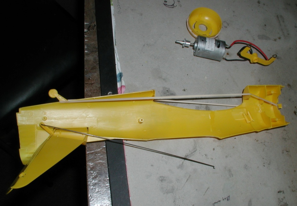

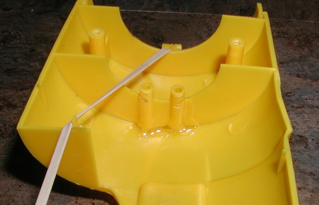

Post  rsv1cox Sat Mar 20, 2021 3:52 pm

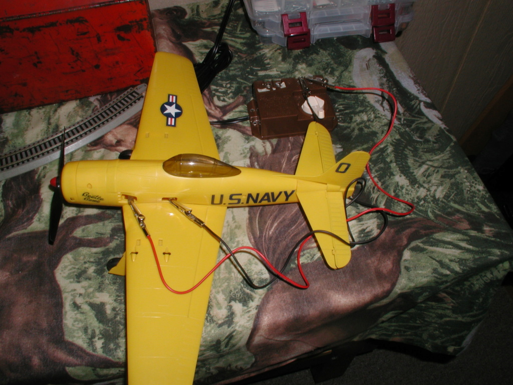

Thanks roddie.  Up on that motor now.  It's a spinner and hauls it around on the floor pretty good.
No wheel doors anywhere in the box.  I think they were damaged when it crashed and the PO just tossed them.  I will need something flexible to backup those plastic cement repairs as it's concave in there with a twist.  Good idea about cutting out the windows for the lead-outs.  Maybe Duct/Duck tape carefully applied.
Managed to get the alignment pegs for the motor back in the right place.  Couldn't tell, rotated it a couple of times until it snapped into place.  Took it out again smeared cement on the uprights and put it back in then backed that up with more cement on the exterior.
Electric Cox F-8 Bearcat X2 - Page 2 P1010872
Electric Cox F-8 Bearcat X2 - Page 2 P1010873
Upward and downward.  Thankfully nature still makes balsa.

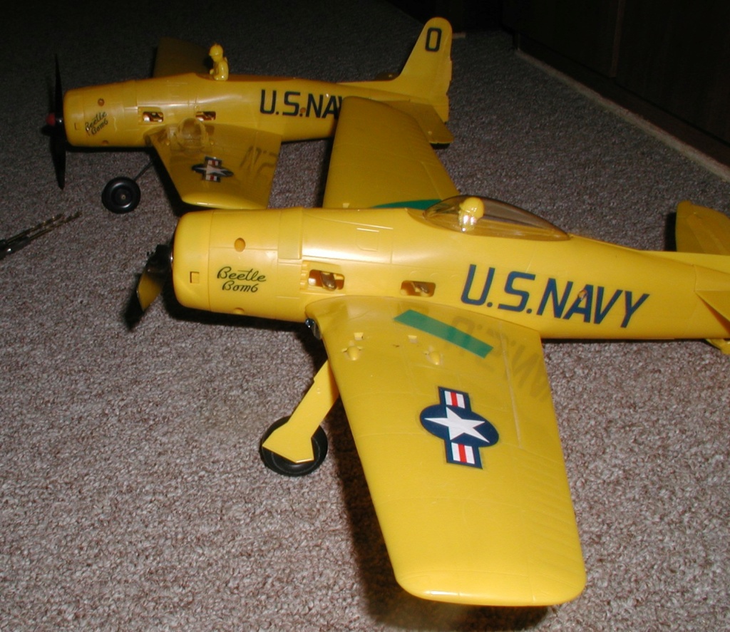

Post  rsv1cox Mon Mar 22, 2021 3:47 pm

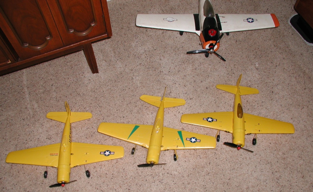

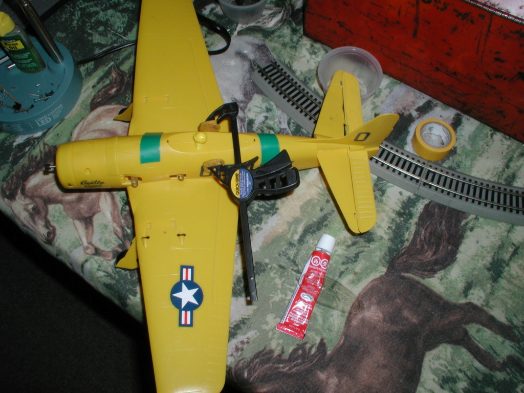

Both have come along way in the last couple of days and are at least flyable now.
Didn't have to back up the cracked fuselage repair.  Tester's red tube does a great job, solid as a rock as is.  Repair is almost invisible on the outside.  Drove me nut's putting them back together, requires three hands.  Get the motor in and the bell crank slides out, put the other half in and the elevator assembly goes south.  Align pins and the motor moves.  X2.
Electric Cox F-8 Bearcat X2 - Page 2 P1010878

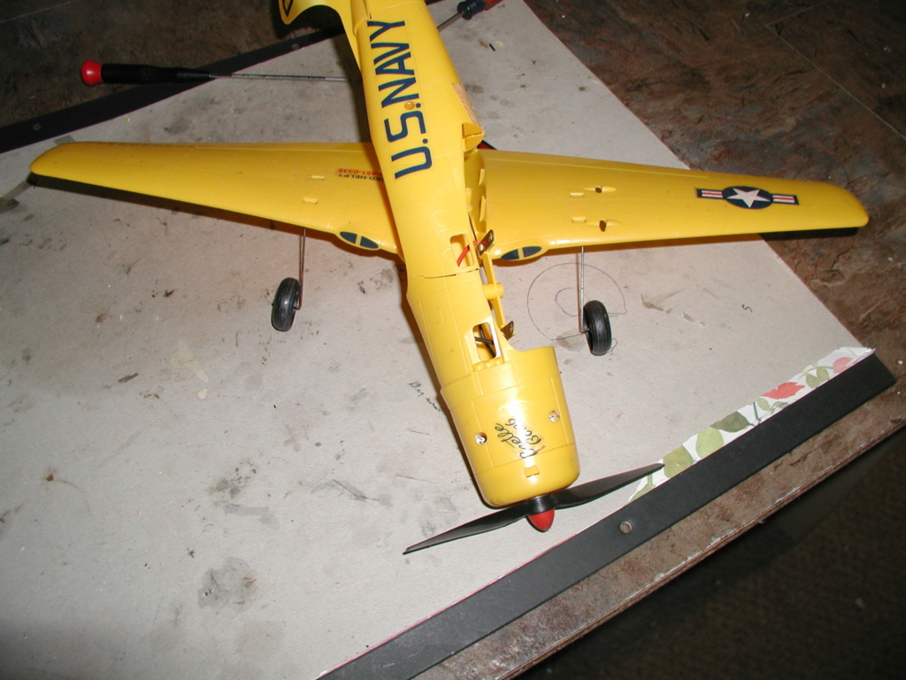

Had to hog out the two stage propeller to fit to the drive washer, 9/64 & 1/8 or I would have to disassemble the thing to remove it.
Electric Cox F-8 Bearcat X2 - Page 2 P1010874
Electric Cox F-8 Bearcat X2 - Page 2 P1010875
Cut the pilot off at the shoulders to fit.  Canopy is too small but so what, I'm not restoring the Mona Lisa here.  Got to do the other one.
Used roddies method of cutting out circles to cover the reliefs for the original canopy's pegs.
Electric Cox F-8 Bearcat X2 - Page 2 P1010876
Might have to find a trim use for the green vinyl tapes that I used as put-it-back-together aids.  I like the contrast.
Still teasing after all these years.  At least I have it down in the basement, just haven't had time to fully open it yet.
Electric Cox F-8 Bearcat X2 - Page 2 P1010877

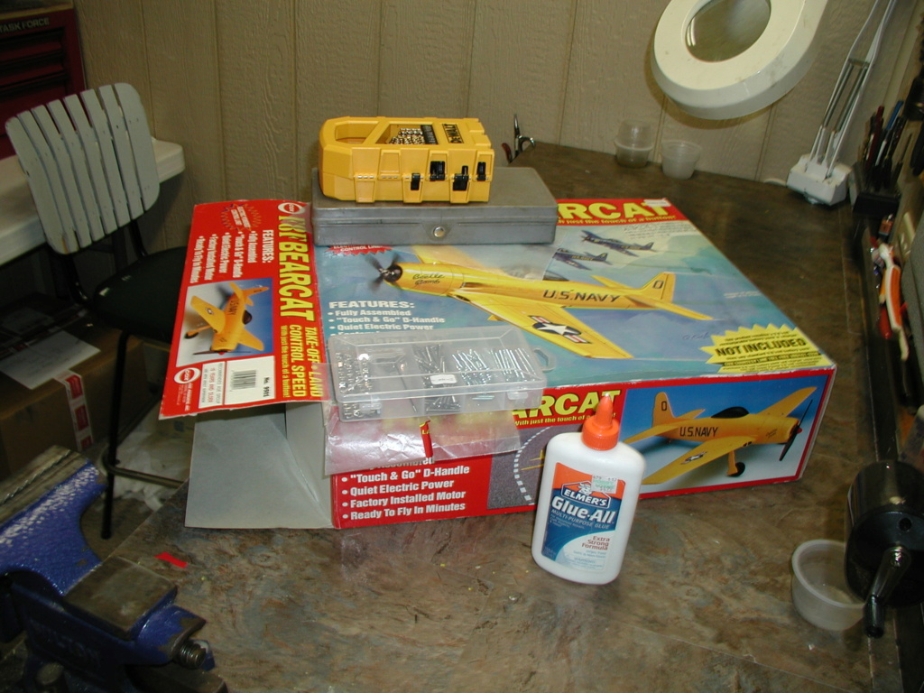

Finally found time to open up #3.  This guy knew how to pack, I had warned him that I had received these in the past crushed by the PO gorillas.
Outside cardboard  box was covered by some sort of sticky backed vinyl, inside that was foam and airbag packing.  Actual Cox box was wrapped in yards of bubble wrap, then saran wrap.  Got that off and inside box had more saran wrap.  Got that off and every void was packed with airbags.  Finally got down to the airplane.

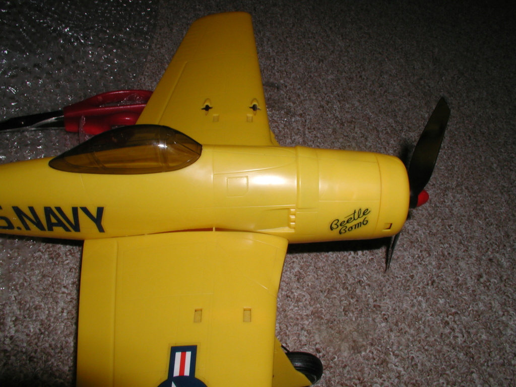

New one not without it's problems.  Assembled with one side alignment pins outside the fuselage.  Got to disassemble.  Don't want to.  Maybe I can push a rod through one of the control line holes and pop it out.
Electric Cox F-8 Bearcat X2 - Page 2 P1010887
Electric Cox F-8 Bearcat X2 - Page 2 P1010888
Electric Cox F-8 Bearcat X2 - Page 2 P1010889

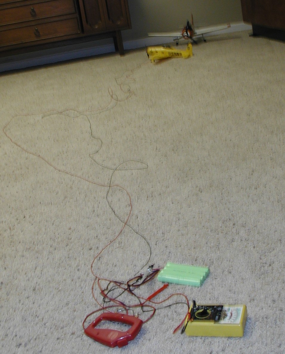

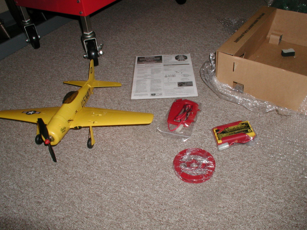

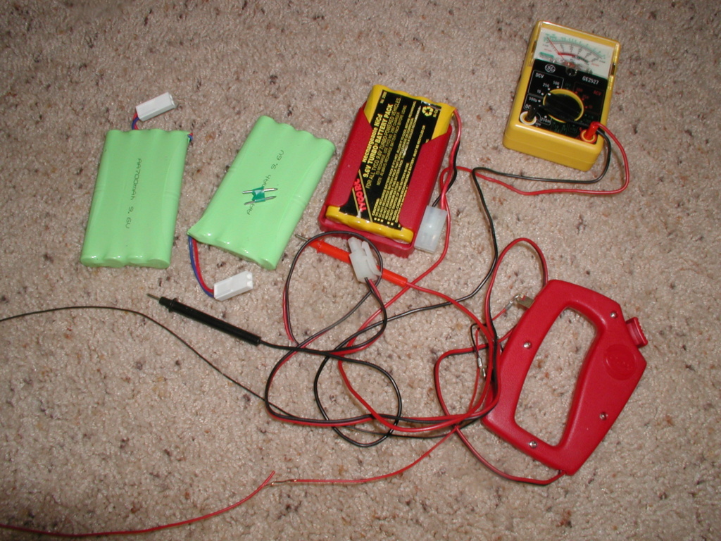

Just happened to get the new batteries in today.  Uncharged, and not the correct connectors I made a bridge from a couple of finish nails with the heads chopped off.  Worked fine, but on this carpet it didn't travel far full throttle.
Electric Cox F-8 Bearcat X2 - Page 2 P1010890
Electric Cox F-8 Bearcat X2 - Page 2 P1010893
Electric Cox F-8 Bearcat X2 - Page 2 P1010892
Electric Cox F-8 Bearcat X2 - Page 2 P1010894

Hey Robert, You can buy Tamiya plug-sets (web-link below) for those light green packs, if you don't mind soldering. Maybe there are conversion harnesses available.. but a minimum of connections is best in any electrical circuit. Plug-sets are cheap too... The deal below is for 5-pair (male/female).. enough for 3 more of those packs..  Smile
LINK HERE
Posts : 7794
Electric Cox F-8 Bearcat X2 - Page 2 Empty Re: Electric Cox F-8 Bearcat X2
Post  rsv1cox Wed Mar 24, 2021 2:32 pm
roddie wrote:Hey Robert, You can buy Tamiya plug-sets (web-link below) for those light green packs, if you don't mind soldering. Maybe there are conversion harnesses available.. but a minimum of connections is best in any electrical circuit. Plug-sets are cheap too... The deal below is for 5-pair (male/female).. enough for 3 more of those packs..  Smile
LINK HERE
Thanks for the link roddie, I saved it.  Going to need them.  None of the batteries that I have or have on order fit.  But, I'm done with this thing, not that it hasn't been pleasant.  Sad

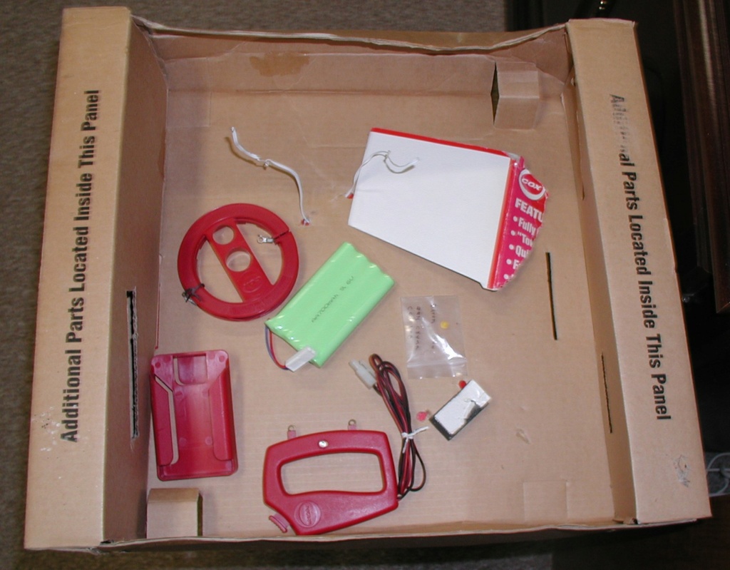

Repaired the ripped box, torn on a diagonal about half way back.  2" masking tape on the inside, Elmer's white on the outside.  I enjoy box art, and this time no cellophane to deal with.
Electric Cox F-8 Bearcat X2 - Page 2 P1010895
Electric Cox F-8 Bearcat X2 - Page 2 P1010896
Got to wait for one of you guys to help me fly it.  Say's Adult Supervision required right there on the box.

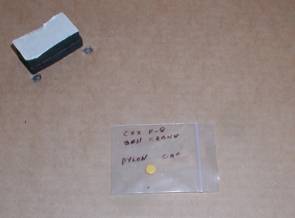

Confession time.  After I got #2 back together I found this bell crank pylon cap on the workbench.  No way I was going to tear it down again to put it back on.  Didn't seem likely that the BC would come off anyway.
Electric Cox F-8 Bearcat X2 - Page 2 P1010901

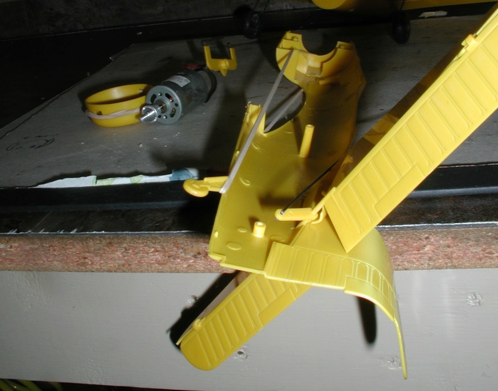

Wound up having to disassemble #3 to get the RH fuselage side over the alignment peg and cure that gap seen in a picture above.  When I did I noticed there was no cap on the bell cranks pylon either, so Cox just left it off.
Electric Cox F-8 Bearcat X2 - Page 2 P1010902

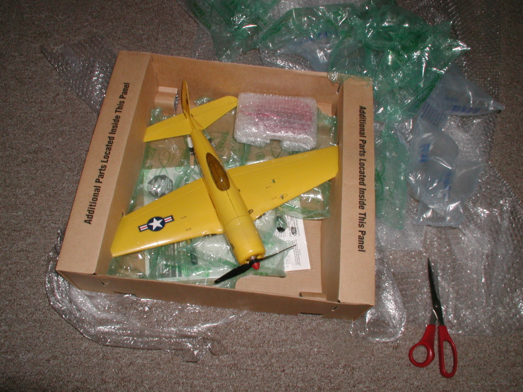

Post  roddie Thu Mar 25, 2021 1:06 pm
Wall of Shame? No...
Electric Cox F-8 Bearcat X2 - Page 2 3-25-210
Just curious; regarding the additional parts located inside those panels..
