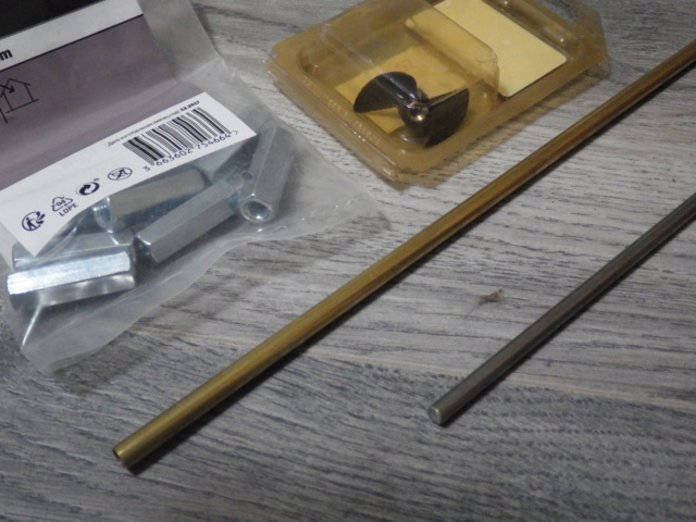

I went shopping at the DIY and bought a 5mm diameter steel rod and a brass tube with the same inner diameter. Also a package of long M6 nuts for the coupling and that fit the crankshaft thread. From ebay, I got a prop with an M5 inner thread.
The bottom planking is completely glued now and I trimmed the edges to make them flush with the stringers.
