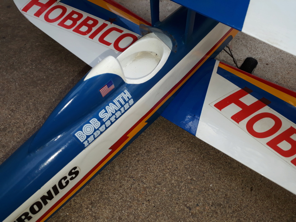

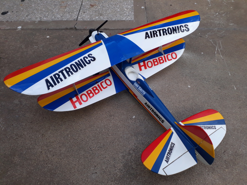

In 1998 I built this biplane to present it in a traditional 1/2A meeting at a club in Buenos Aires. It is based on the "Corky" designed by Van Hereford, published in Model Airplane News (November 1963). Today the plan and article can be easily obtained from the Outherzone website (plan oz2937).
The original “Corky” has a 28-inch wingspan and was designed for Free Flight with a Cox Pee Wee .020 engine, with both wings made of curved balsa sheet with false ribs. My version is exactly the same size, but I adapted it to fit a reed valve Cox .049 and a Cox-Sanwa 2-channel radio. Both wings are ribbed and plated above and below, forming an approximate Clark-Y profile. I also made other modifications, such as the addition of the lateral wing pillars, and two front air intakes that allow the engine crankcase to be cooled.
The wings were finished with the original MonoKote, while the fuselage and tail group were finished with dope and then with LusterKote spray paint (from Top-Flite), with the colors matching those of the MonoKote. Although I have not checked the weight on a scale, I can say that it turned out to be a very light model. This is because I took a lot of time selecting the wood, using the lightest balsa I could get.
A special comment about the incidences: the engine is approximately 1 degree negative, the stabilizer is at zero degrees, the lower wing is also at zero degrees, but the upper wing is 1 degree positive. This responds to a very effective concept for biplanes that are not designed for aerobatics, but for a very safe sport flight. The theory goes that when the front wing (in this case the upper wing) is stalling, the lower wing is still maintaining lift but with the CG almost at its leading edge. Therefore, at that moment the model lowers its nose without getting out of control, and thus there is a better chance of recovering normal flight.
Remember: in the biplane models the front wing should have 1 to 1,5 degree more positive than the rear wing to obtain this "saving effect". In the case of the Beechcraft Staggerwing the lower wing is forward, but in most biplanes the upper wing is forward, and is the one that needs the most positive incidence. Also remember not to consider this concept for aerobatic biplanes.

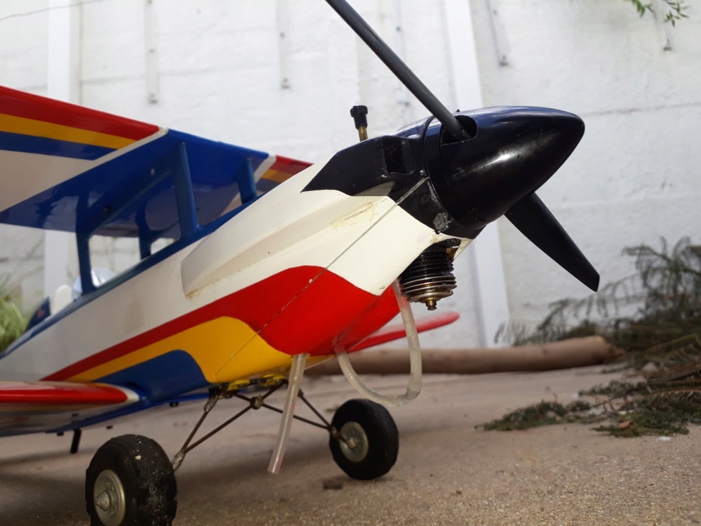

Well now I comment on the little jobs I did on the model and the respective photos.
1 Fit a .049 Babe Bee motor with flaper valve.
2 Install the throttle ring and corresponding drive servo.
3 Fabricate a fuel tank to perfectly match the available shape of the fuselage.

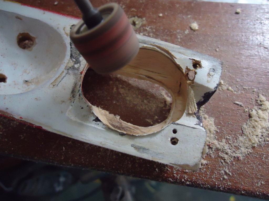

4 Reshape the lower cover of the tank and engine, cutting a circle so that the throttle ring can work without problems.
5 Fit the ignition key.

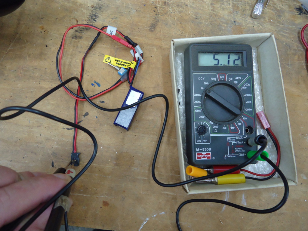

6 Place the battery by means of the strap, which should be removed in case of recharging.
7 Control the CG Center of Gravity, leaving it with a nose drop of about 15 degrees.

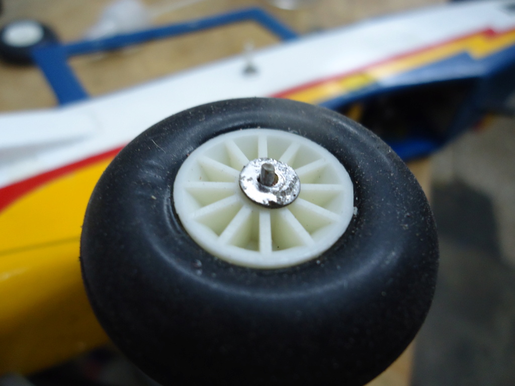

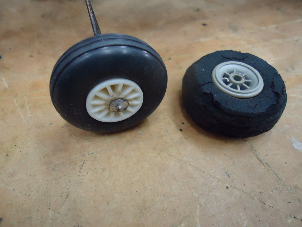

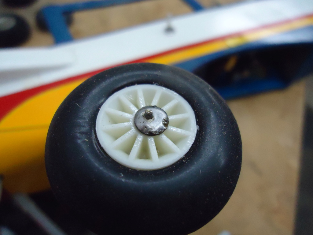

8 I changed the wheels, since the original ones of the engine disintegrate over the years, manufacturing jujes for the correct sliding of each tire.

place the receiver.
10 Finally I checked the weight of the model, which is about 520 grams.
