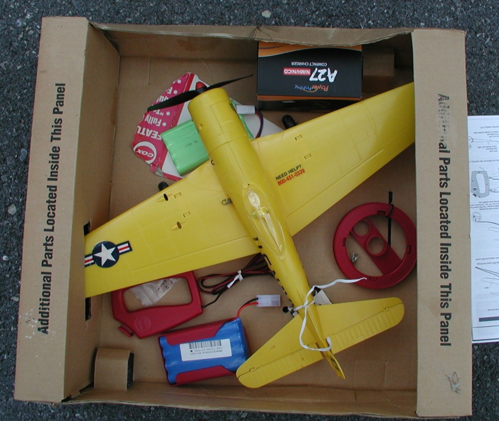

Beautiful afternoon, seventy degrees and no wind. Perfect flying weather, so for the first time thought I would try the Electric Bearcat.
Hitched up the new fully charged battery and airplane and hit the switch. Prop made half a turn and contacted the asphalt. Bent the landing gear down enough to clear and tried again. Ground loop. again and again. The wires drag the left wing down and the plane doesn't make enough speed to to keep the lines taunt.

Dang. Sorry to hear that the plane was unable to make it off of the ground. I was thinking it would have taken off very quickly and would have to slow the flight down. Heck, I would have thought that it would have more than enough power to do it. I wonder if a bigger battery would have made it work, and even one better. How did they actually fly when brand new?

The old stock battery pack likely a NIMH does not put out enough juice.
The power / capacity has degraded over time. Is that a parallel 4.8v system?

The reality is that these planes have no wing area and a very thin airfoil and are too heavy. Many Cox planes are the same way and the more scale they are, the worse the problem is. Cox planes and the competition were responsible for more people leaving the hobby then sticking with it. The glitter wears off real quick when the plane is in pieces all over the ground.

The battery is a brand new 1200 MAH battery just received last week that replaced the 700 MAH. Charged it fully before trying to fly it.
Problem is the insulated lines are just to heavy and weigh the left wing down.  I tried holding the lines above my head to offset the weight but to no avail, it still ground looped each of the four times I tried it.  Another problem is the rudder, it's non-existent.  I'm thinking perhaps a styrene or balsa rudder extension glued on might help.
In German Buddy's and friends video they flew inside off a smooth floor with less rolling resistance than my driveway offers.    Also, I think this one may have my replacement 5/3 prop rather than the recommended 5.5/3.  Got to check that.

Seems like the motor has plenty of oomph Eric, It's those darn heavy lines that drag/catch on the asphalt that cause ground loops.  The thing is so light that to maintain line tension you have to hold back which doesn't help either.
There is the option of fuel, replace the electric motor with a Babe Bee and lines with dacron/spider wire.  Not much sense in that, I have so many balsa models that fly better than plastic.  But, it's an interesting piece to have and represents a minor part of Cox's presence.

oo gawd.. shoot.. crap.. well; we knew this might be a crap-shoot.. Laughing Seriously though... Robert.. I think that there's excessive resistance in the system; more than the original design imposed. "Excessive resistance to fly".. Laughing just kidding Robert!
If you were to "jumper" a short harness with an in-line switch to the motor.. you might see marked improvement. If so; consider the quality of the OEM wire which is now 30+ years old. Shocked
The electrical-wire/control-lines weren't a good idea.. but they "did" work when new..
This particular Cox model airplane might as well be a slot-car.. and it's lines/wires need to be good.. or at least "new". A few drops of oil on the motor bushings (as Eric mentioned..) wouldn't hurt.. but I'll bet that new wire-lines would be in order.
The "switch" could also be questionable. Is it making full-contact.. Are all the connections soldered and connected in a way that would afford the least electrical resistance?
I'm not recommending buying a spool of hi-flex 22GA wire.. but if you "had any".. I'd replace the old wire. The old wire might work for launching model rockets.. but not for the continuous current-draw that we're looking at here.
Maybe "tie a streamer" to help launching. Don't give-up on this one yet.. Smile

Well, thanks to GB and friend we know that these do indeed fly.  But we need more information.  When did you fly them?  ROG or some assist needed?  Disassemble and lube the motor prior to flight or fly right out of the box?  How much built in rudder?  Did you have to hold the lines off the floor to prevent drag?
I think the under wing mid wing lead in's may be a contributing factor.  But I believe they did this to mitigate the weight effect of the leads rather than having them exit at the wings tip.

This is my problem as I see it.
The control leads exit mid-way under the wing causing the leads to droop and touching the ground.  If they were positioned on top of the wing through wing tip guides that would help eliminate the problem.  Not so much of a problem on a smooth floor, but a big problem on rough surfaces that catches the lines.

Well if its a flier then make a wire guide for under the wind out at the end and run the wires through it to get them close to what your talking about .. all you need it a couple small holes/paperclip/glue.

We "COX Bearcat" took off 2015 @ RC Indoorflight meeting Mannheim.
ROG , NO assistance needed , just playing with Power/juice pushbutton and take off.
Sure "COX Bearcat" Pilot and Owner Richard did lube the motor .
Sure both lines need tension , if not step back.
Dont try taking off while lines laying on ground.
R E A D  COX Bearcat   I N S T R U C T I O N S

Post  rsv1cox Tue Apr 13, 2021 3:02 pm
Mark ran parallel and stepping backwards with the plane on the ground then whipped it into the air.  Probably 10 -15 go-arounds until he got dizzy.  There was a time when we would fly most of the day with no ill effects.
Reread the instructions, nothing there that isn't applicable to any C/L model. Nothing about stepping back or whipping. Last plastic model I flew was a Cox Corsair that I flew off the same asphalt, it practically jumped into the air. Big difference between electric and nitro.
I'll tach all three then oil and tach again noting the difference.  Well, maybe just two of them.
