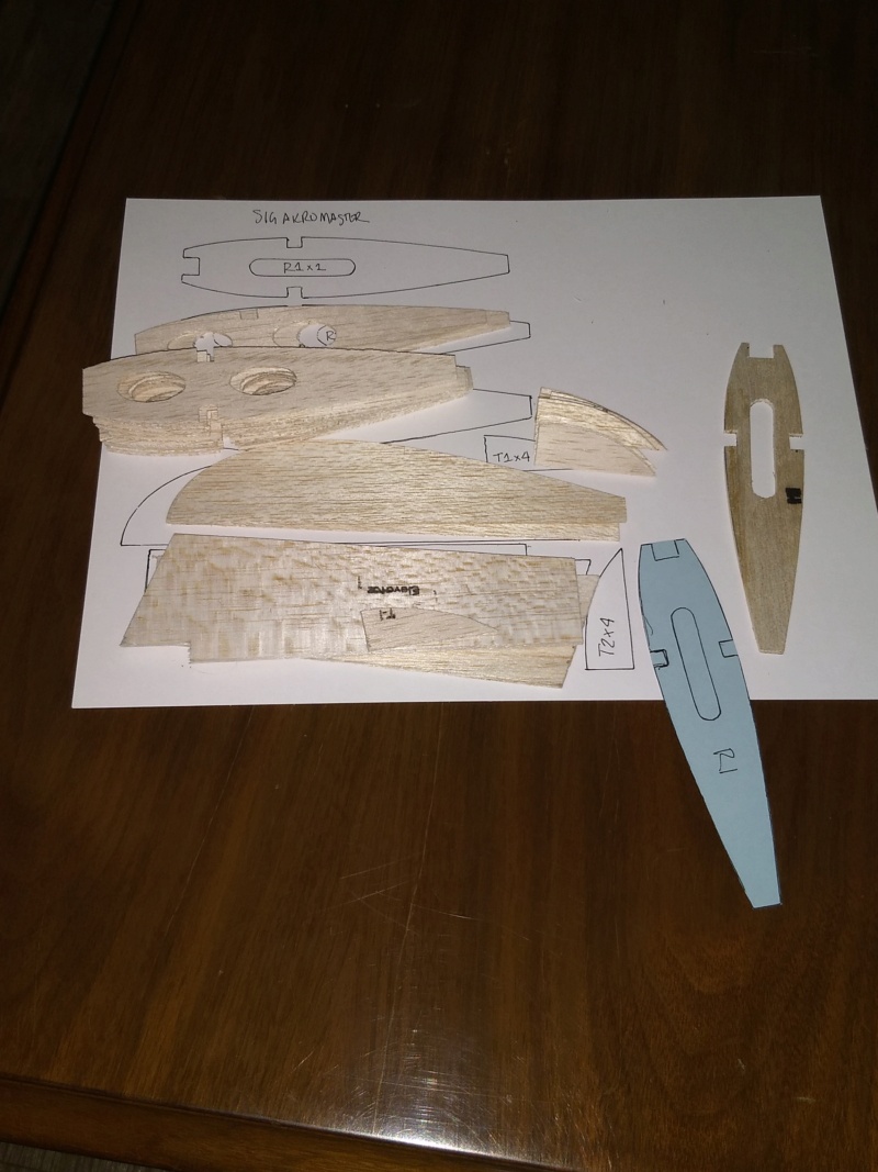

Good afternoon, Gents,
This is a build thread instigated by this one
https://www.coxengineforum.com/t3652p125-sig-akromaster-build
My humble entry to larger than 1/2A...unless you count my Big Mig .074 x 2 BHM Mossie. Well, I need to re-phrase that.
Ok,
My humble entry to larger than 1/2A sport flying.
My goal is to learn the OTS pattern with a plane that I can make several of in short order. I need to weigh each of my prospective engines, with and without muffler, and select the one closest in weight to the Fox .15 all the old threads mention. I may consider sleeving venturies down in size to slow particular engines down.
But for now...balsa dust flies, and R1 gets repaired. The glue line is visible only because the scab came from a different end of the same "short edge."
Ok,
