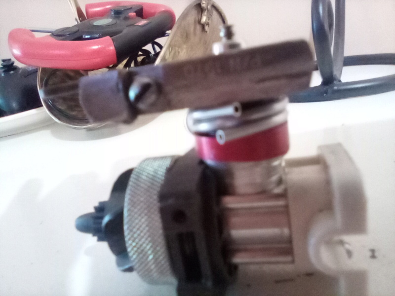

This morning's progress.049 cox powered rc boat Convert to nitro  16291311
.049 cox powered rc boat Convert to nitro  16291312
.049 cox powered rc boat Convert to nitro  16291310
I still have work to do. Installation of the carburetor back plate prototype I have a good feeling it should work out well This modification allows to have two different jets seting for low rpm jet and hi jet This prototype allows me to use two different types of nitro fuel if I want wit two smal fuel tank Example use on the high jet more oil in the fuel the low speed jet less oil less nitro Allowing the engine to easily start a more precise control for a Good low rpm without flod the engine wit oil The low jet is inside carb barrels its the normal setup for for carb hi jet is the one from the stunt bee tank backplate The air flow decreased in this jet passed through the interior of the tank Works When the carburetor is open

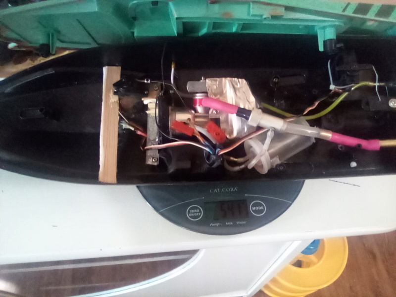

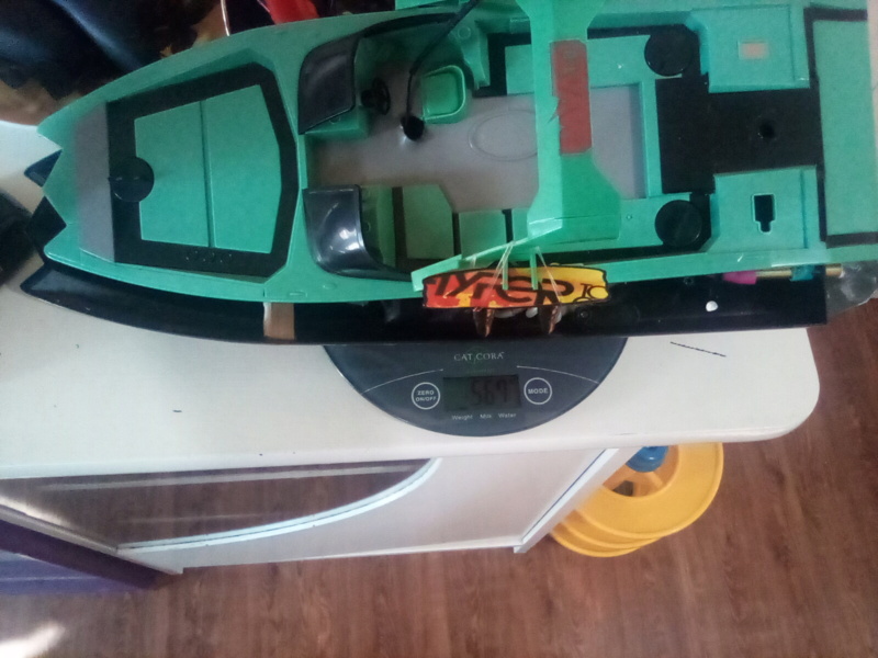

Post  davidll1984 Sat Aug 21, 2021 8:48 am
I finally found the problem was a valve stuck open after the first start I did not position the valve clip well I also believe the gas jets was too open I removed the engine fix the valve problem all replace then all works well now rsv1cox delete the exaust pipe Will not be necessary because the engine keeps good performance wit it i did try Then I withdraw it a gain of some turn But not enough to make it worth it Without the tube, the oil splashes Inside the boat He's finished ready to go on the water I hope I'll have time today it's hot A perfect time for the beach .049 cox powered rc boat Convert to nitro  16295511
.049 cox powered rc boat Convert to nitro  16295510 final weight 547gram Not Not as light as I wanted to keep it
