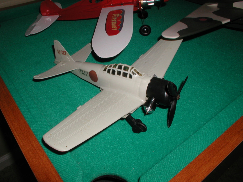

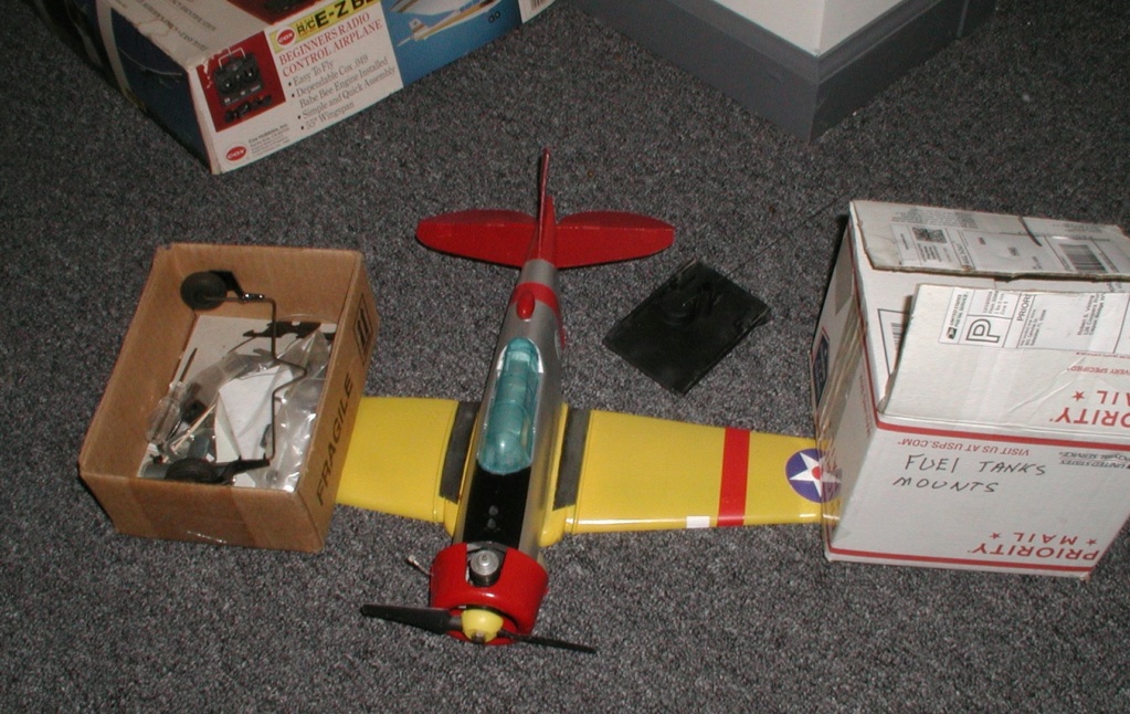

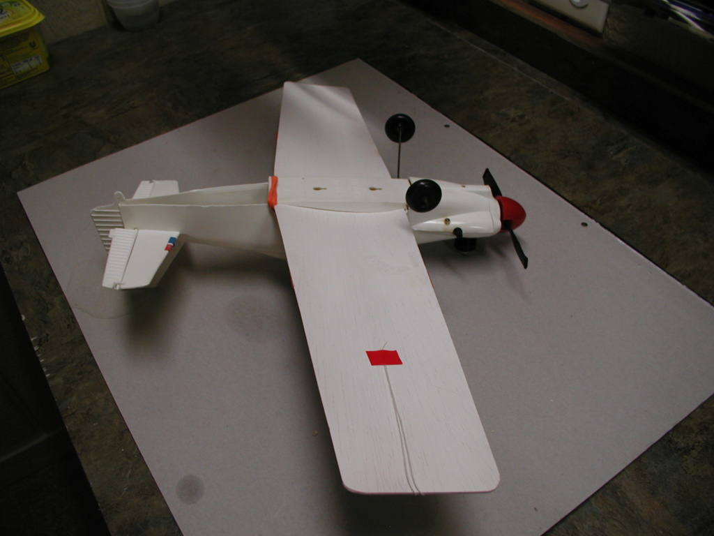

I have done three or four of these plastic tail-less wonders and have forgotten exactly what I used, but I think just plain 5 minute epoxy, but it could have been Testors red tube plastic cement or something else.  Wanted to see what other people used.  Got to reeducate myself by doing some tests.
I'm not sure what I used on this one, I knew i wanted to try Testors but it could have been something else.  Turned out well, solid and has been bumped around over the years.
So, if you were going to permanently attach plastic to balsa P1011438
So, if you were going to permanently attach plastic to balsa P1011439
Another thing, the wings had repositioned themselves to about a 30 degree up dihedral, way, way out of scale.  So for the last two years it has been setting in that hot loft storage area with weights on the wings and it's beginning to have an effect.  Now they are almost normal.
So, if you were going to permanently attach plastic to balsa P1011440
So, if you were going to permanently attach plastic to balsa P1011441
Pretty sure I used epoxy on this one.  It shows.

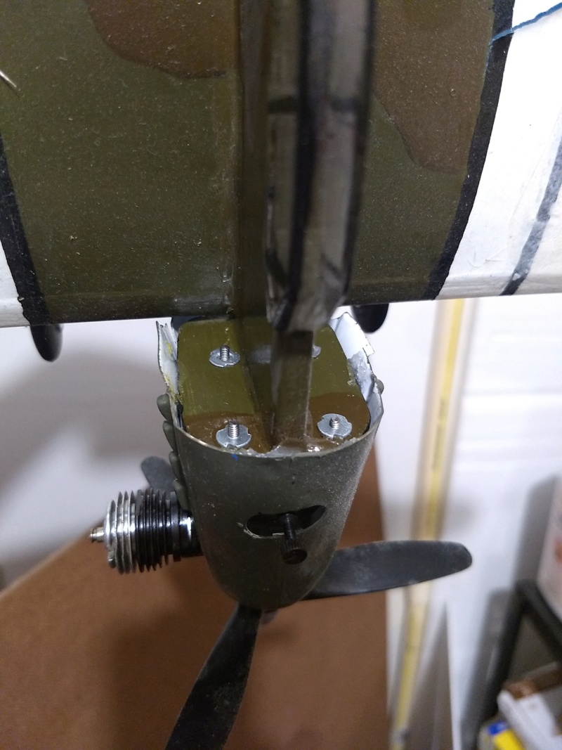

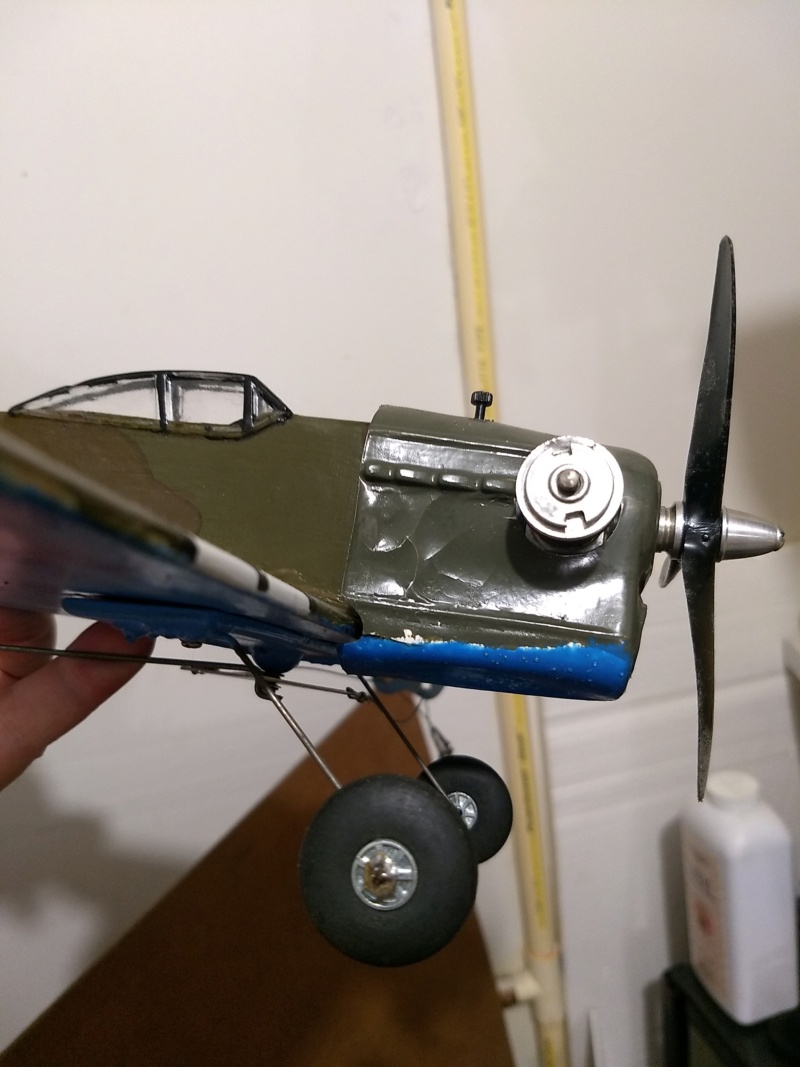

I didn't wait for the e6000, used this instead. From what I have read about e it's about the same, regardless the plastic to painted balsa is excellent.  Like e6000 it's a slow working gel.

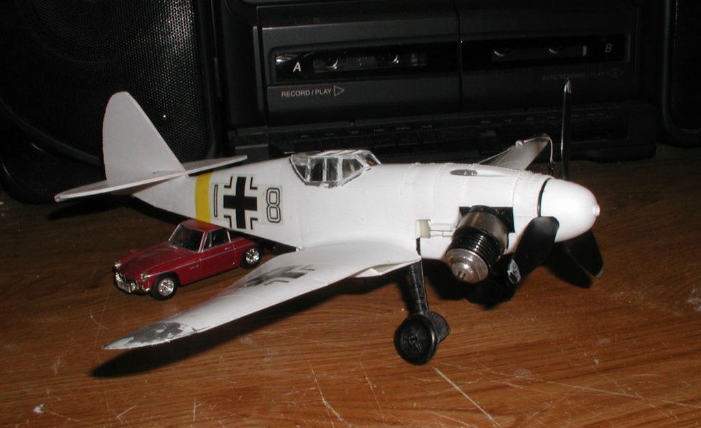

So, if you were going to permanently attach plastic to balsa P1011493
I built the new tail pieces out of balsa and used a metal rod to connect the two split elevator halfs.  Then connected to the bell crank rod.  Throw is slight but sufficient for flight.  I soaked the spinner in brake fluid to remove the slopped on sliver paint and will probably do the same for the wing tips.  Motor is new and unused.  I will snip off the looped connector to the lead outs.
So, if you were going to permanently attach plastic to balsa P1011494
So, if you were going to permanently attach plastic to balsa P1011495
These Fly-em are incredibly small to be sporting a .049.
So, if you were going to permanently attach plastic to balsa P1011496
I don't know what to do about the bent wings having mixed results using a heat gun.

Post  rsv1cox Wed Aug 25, 2021 6:50 am
20 years Ken, it might be a gonner.  Take a leaf blower to your workshop, I have found many lost airplane and MG parts that way.
Added a decal to the tail and cut off the clips to the swivels.  Could be flown but I probably never will do it.

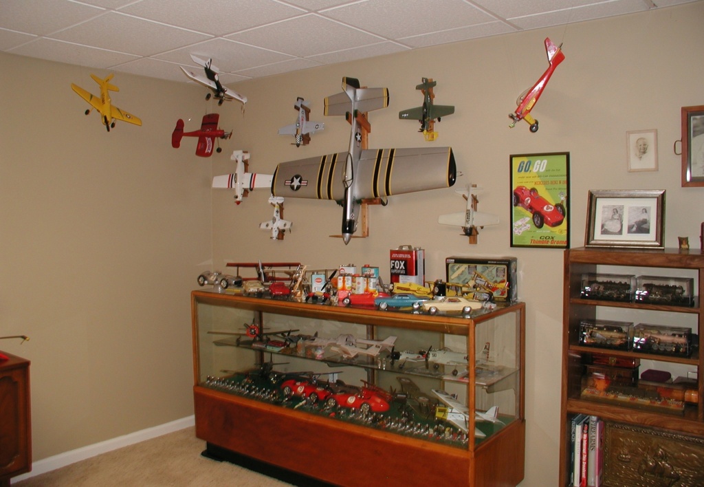

I Knocked out the racks for the Zero and BF-109 this morning.  The family snickered when I scavanged the shelves from my daughters old TV/Stereo console....guess whose laughing now.  Smile  Saved me a lot of sanding and staining.  Still had to stain the table saw cut bitter ends.  I take pictures as memory prompts for me.  What did I use to stain/paint/fix that thing?  Answered a lot of questions for me over the years.
So, if you were going to permanently attach plastic to balsa P1011502
So, if you were going to permanently attach plastic to balsa P1011503
The Zero is by far the better of the Fly-ems. Thicker plastic and the Zero design helps.

Post  944_Jim Fri Aug 27, 2021 5:33 pm
Bob,
Where is the Mossie? Shocked
And in the bone yard...background airplane with longer canopy...do I spy with my little eye a twin? What is it? Huh...
Posts : 1791
So, if you were going to permanently attach plastic to balsa Empty Re: So, if you were going to permanently attach plastic to balsa
Post  rsv1cox Sat Aug 28, 2021 7:08 am
944_Jim wrote:Bob,
It's center stage on the game table pictured above Jim. Still unflown but loved. Enya's a little stiff from neglect. Waiting for one of the hot sticks here to show up and fly it.
I couldn't ID the other plane that you mentioned.
I imagine some think it strange, hanging models on the wall. But I like getting them out where I can see them not stuffed away in a closet somewhere. But I have to admit, I got a bunch sitting there also.
