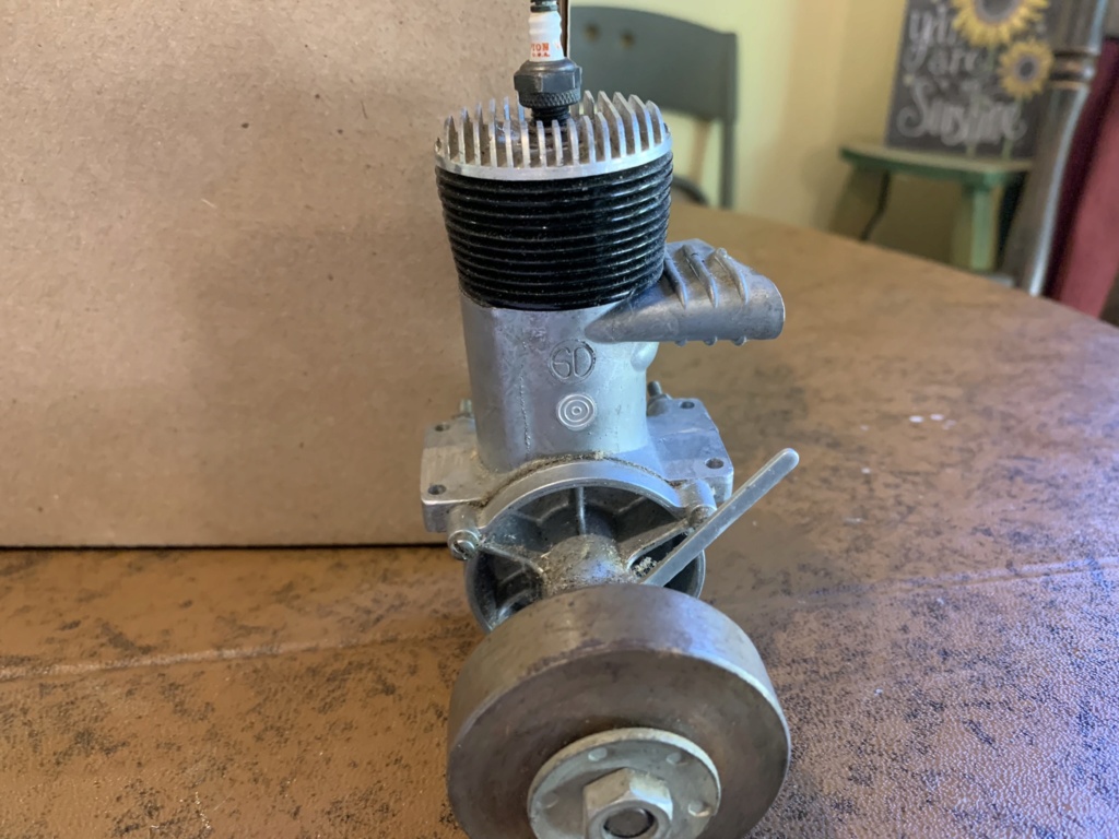

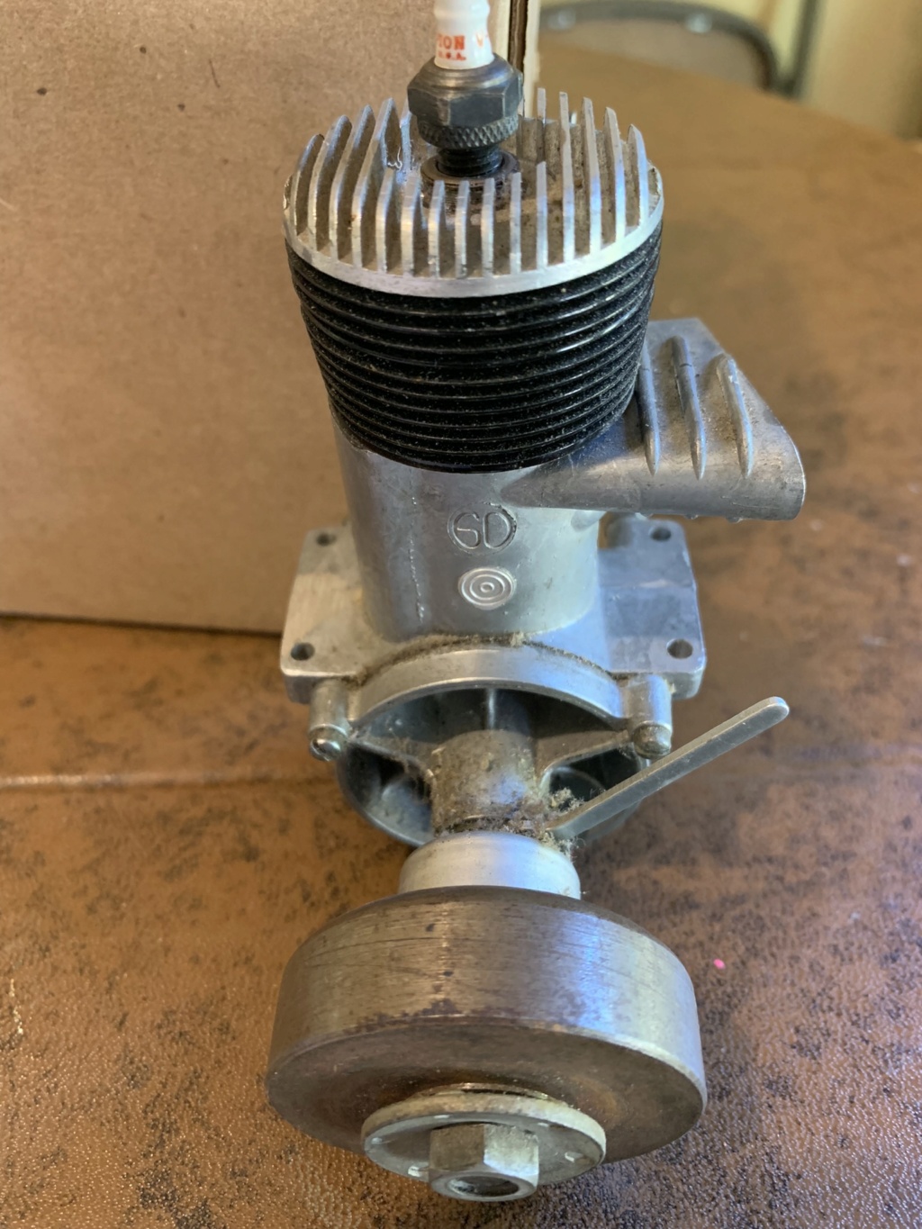

Looking for some help on this 60
I have a O&R 60 that was given to me when I was a kid from a family friend who was into model planes and such. I never used it. It sat in a box with some original paperwork and what looks like paperwork from other related things. I have had it about 42 years I’m thinking.
The serial number is 073038. Trying to just confirm it’s age. I read the post from Ken Cook with the numbers but something wasn’t matching up. Not sure if it’s from 1949 or maybe 1948.
Any help would be great.
I have pictures just tr
Bluzman23- New Member
- Posts : 2
Join date : 2022-08-03
Re: O&R engine serial numbers.
The glow plug was invented in late 1947. Seeing that your engine still has a ignition timer , your model is earlier. Once the glow plug was invented, that changed the hobby. O&R sold two types of conversion kits. You could convert the engine from a side port to a front rotary valve and you plugged the side of the case with a cork.
They also sold a kit to delete the front timer assembly. A cover took it's place when removed and you ran it on a glow plug.
I believe the .60 had quite a few years of production starting from about 1941.
- Posts : 4832
You may want to check this out and you can ask in the Question box , i have read all i can and looked can't find a for sure answer . Good read to .. https://www.fabtintoys.com/ohlsson-rice/
