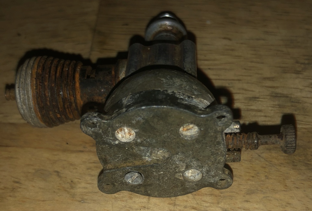

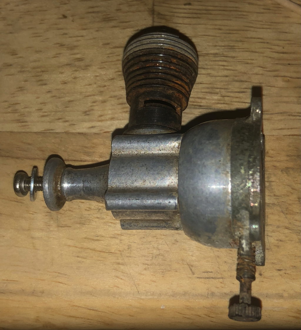

Like I needed another babe bee……..
But I didn’t have one of these in my collection. It’s a first edition babe bee with taper screw backplate. Jacob alerted me to the eBay listing.
https://www.ebay.com/itm/5-049-tether-car-or-model-airplane-engine-cox-thimble-drome-/363505269329?mkcid=16&mkevt=1&_trksid=p2349624.m46890.l6249&mkrid=711-127632-2357-0
I knew the condition wasn’t the best from the pics. It was just as bad inside as well.
Some spit and polish and this is about the best I can get it. I could reblue the cylinder but it won’t fix the poor compression.

WOW, takes a keen eye to see the difference in the screws through all that crud. She did clean up nicely. HA! looks like someone tried to snipe you in the last 4 seconds, nice bidding.

Good eye to pick out the screws, the only way to tell. Find a good cylinder piston and swap. I have the other one.

Thanks for the compliments. On the tank I had to sand through the corrosion on the lathe. Same with the glow head. Even the crank is pitted on the web next to the crank pin. The reed wasn’t salvageable either.
Rust in the cylinder bore pitted it and that’s what’s causing the poor compression. The piston is fine so it would need a different cylinder to run.

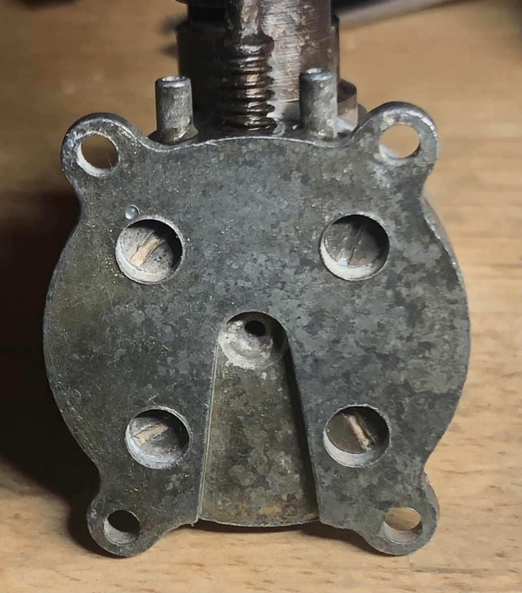

Hmm, I know I have a couple like that. Were they restricted to the countersunk backplates only? And, they did countersink the backplates too to accept the tapered screws, right? I don't think, but I'm not sure if I have that early BB, but I'm not pulling them off the mounts to find out. Seems I would remember it but there are days when I can't remember my name.

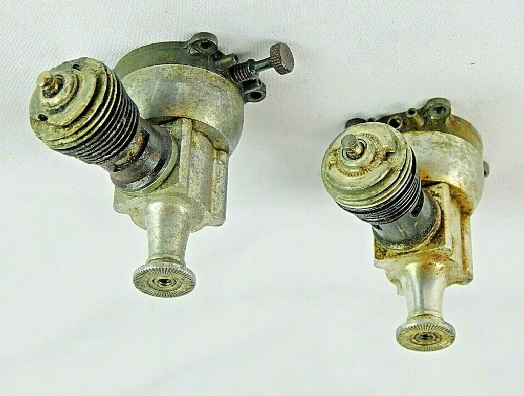

Two of my crispy critters.
Screened intake are fillisters for sure. Other one, probably, but one screw head looks suspect.
These were pretty much protected by spent castor, unlike Jason's that unfortunately looks like it was stored in the bottom of a fishing tackle box. That said I would happly trade these two for his one and probably toss in a couple of Enya's too.

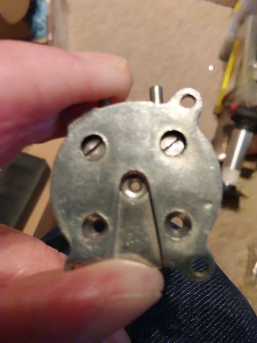

Unmarked #2 cylinder, correct?
Found a backplate on "eboy" a while ago. Enlarged the photo 'till
I couldn't tell for sure, and went for it anyway. Holy grail moment
for me. The flat head is indeed flat, and it sits a little deeper in the
recess. The fillister isn't perfectly flat. Hoping to build a
copy around it.

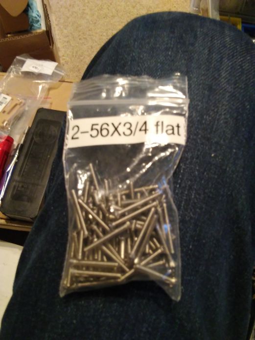

Wound up buying a few lifetime supplies of these. Anyone need some?
