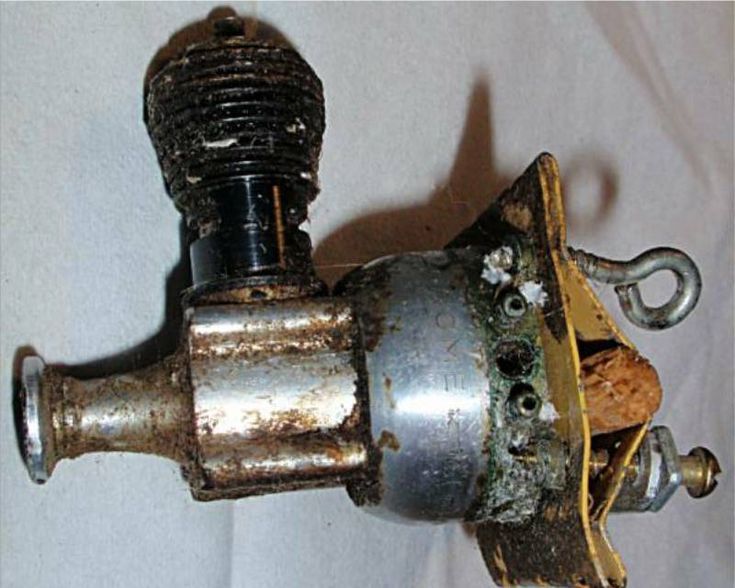

Hi folks,
Thought I'd share here my progress with the Cox engine I found. I sent a couple pictures and a description to Cox International, and they identified it as a Babe Bee .049, and I've ordered a few parts and tools to fix it up. In the mean time, I've had it apart and got it cleaned up.
Depending on when supplies arrive, I hope to have it running soon! The glow head still works, and nothing seems cracked or broken, except the gaskets and the internal fuel hose.
I'm also looking for sources of fuel.

They appear to bee in bussiness with reviews of 4 wks. ago . Engine looks good that it shed it's dirt , you do know the drive plate is not all the way on ? Probably waiting on the kit .

Nice job on cleanup and welcome !…. Now you’ll have to build something for it when repairs are complete!

Congratulations, complete takedown can't get any better than that. What did you use for detergent?
Looks ready to run except for that drive washer..........Eric you pay attention and have Eagle eyes!
I like it as is, but you could make it like new by chucking the fuel tank up in a drill press using the air intake tube and use fine steel wool to lightly polish, use of a light oil is an option. Then soak the cylinder in white vinegar to remove the finish then re blue with gun blue and season/polish with oil and a toothbrush. Aluminum polish on the case. To much of any of this though and you have a hat-check floozy.

Thanks for the responses and information everyone! I've only got it loosely together now, so I won't lose any parts. I used POR-15 degreaser to clean it up. It was seized up pretty good, but I've read that the oil turns into glue after a while if not cleaned or used. This engine could have last ran 50 years ago. I'm 44, and don't remember Grandpa even having these. Something he probably did with my uncles back in the 60's maybe. I'll ask him if he remembers any details later today.

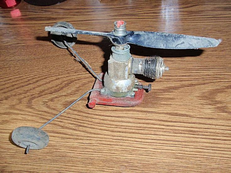

Going through boxes I brought home from Grandpa's and found 2 more engines.
Another Bee, and an Ok Cub. Both look pretty complete as far as I can tell. And both are seized up solid just like the others were. I think that's finally all of them, but who knows...

Well now you have a collection!!…. Especially nice that they were your grandad’s …. I’m sure he’s pleased you have taken an interest in them
Just go slow and easy on things that are stuck…. Lots of good advice here on how to properly take things apart without damage…. Also to rebuild and run….Keep us updated…,

I found a few plane parts, but they're pretty broken. I got the rest of the engines apart, and was able to save quite a few parts. Unfortunately, one Bee will need a new piston, and two will need new crankshafts. Fortunately, Cox International has all the stuff I need.
I dug out some of my lab glassware, and did a little chemistry. I read a lot of conversations about nitro fuel in general and nitromethane in particular. Seems some folks mix in 2% acetone as a substitute for the nitro, and it has some of nitro's benefits. What I read was that acetone helps the engine start, and run a little smoother, but it won't provide the extra power that nitro will. I don't need the power, since the engine doesn't actually do anything, so I figured I'd try it. I mixed up 2 mL Acetone, 20 ml castor oil, and filled the rest of the beaker to 100 mL methanol. Works real nice so far! Before I was getting it to run for a couple seconds here and there. With the new batch of fuel, it ran for maybe 15 seconds until I shut the fuel off. Might have run longer, but I'd like to get it outside with plenty of ventilation first. It didn't smoke like a regular 2-stroke. Does seem to spit castor oil all over though, LOL.
I got the OK Cub engines taken apart and cleaned up too.
Those came apart pretty easily, though they were also seized from congealed oil. The more complete engine has a little recoil starter like on a lawn mower. Unfortunately, the spring is broken, so it doesn't work. But I did get enough parts from both engines to build a complete one.
I still haven't gotten over these tiny pistons yet! So far, I haven't gotten the engine to run. I'm still a noob, but it feels like there's a lot less compression than the Bee has. I haven't found as much information on these as the Cox engines, but I get the feeling that OK Cub is considered inferior to Cox engines.
I also cleaned up the Wen Mac Mk 2, but it's missing a back cover for the crank case, and also the needle valve and tube. Also, I think the crank shaft may be broken in the front where the propeller would go. I haven't had a chance to search around for Wen Mac information yet.
I should be getting some Bee parts in the mail in the next week or so. But if anyone knows a good source of Ok Cub or Wen Mac parts, I'd appreciate the info.
